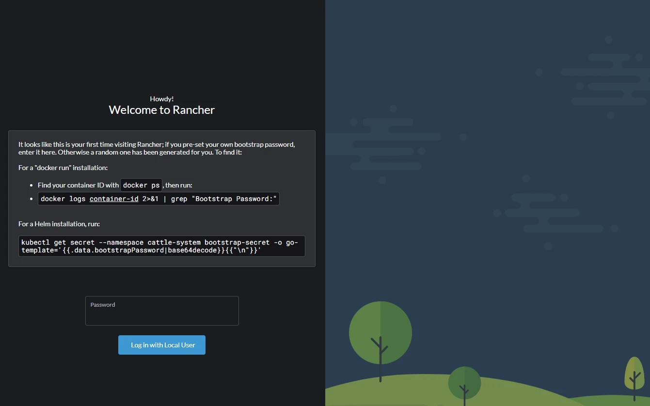

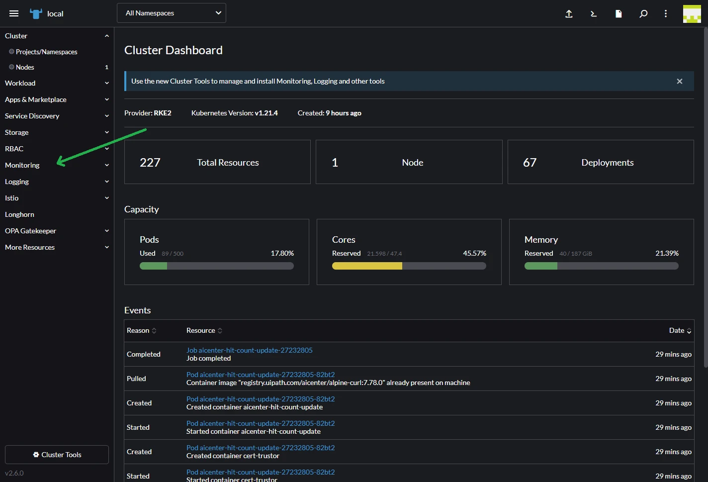

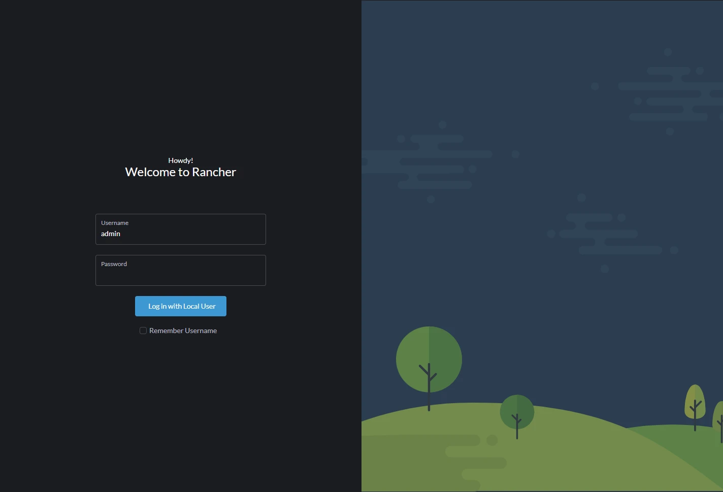

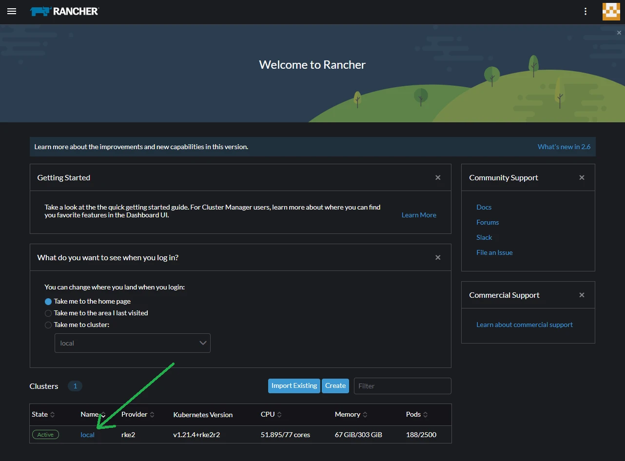

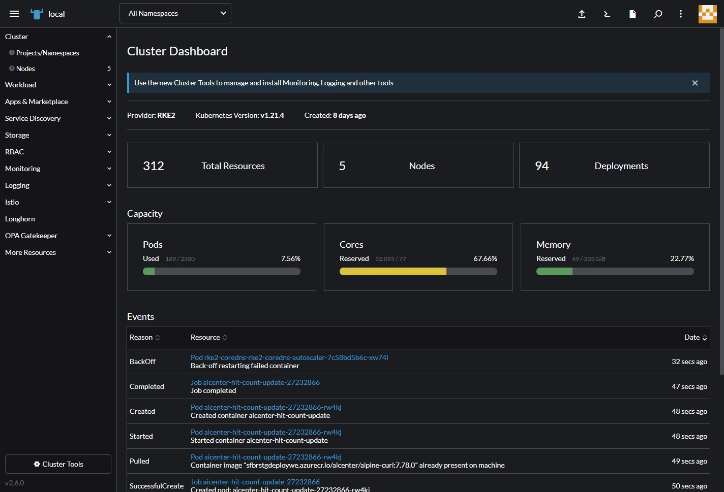

Accessing the Rancher Monitoring Dashboard
Access the Rancher Cluster Explorer via
https://monitoring.{cluster_host}. The screen you are prompted with depends on whether this is the first time connecting to Rancher Server. -
Enter the password. The password is the same in either case. It can be retrieved with the following command:
kubectl get secret -n cattle-system rancher-admin-password -o jsonpath='{.data.password}' | base64 -d && echokubectl get secret -n cattle-system rancher-admin-password -o jsonpath='{.data.password}' | base64 -d && echo -
Open the Cluster Explorer by clicking the local link on the Rancher Server main page.
Click the Monitoring menu on the sidebar.

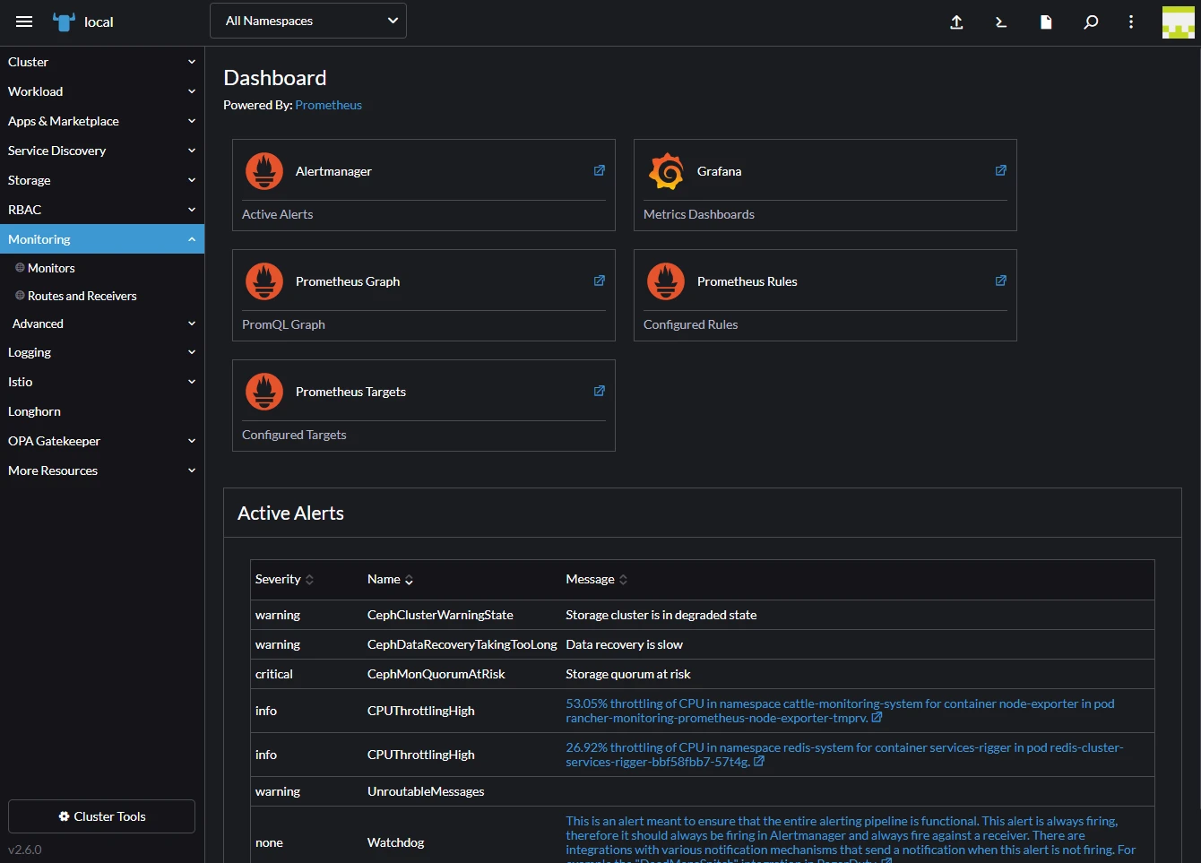

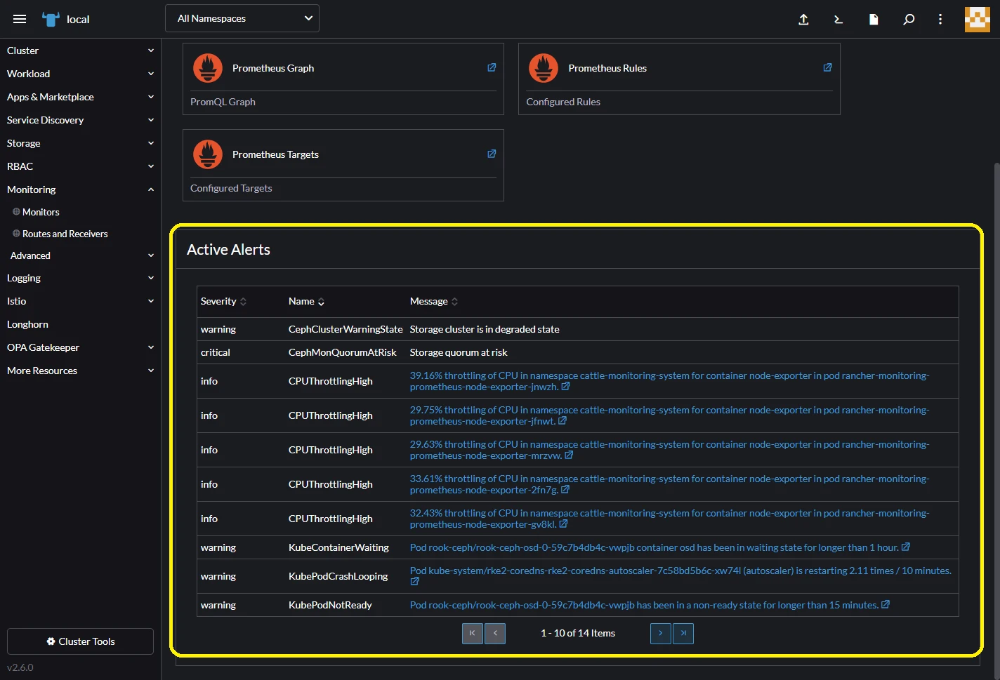

Checking Currently Firing Alerts
In the Monitoring dashboard, check the bottom pane for currently firing alerts. The following screenshots shows several currently firing alerts.

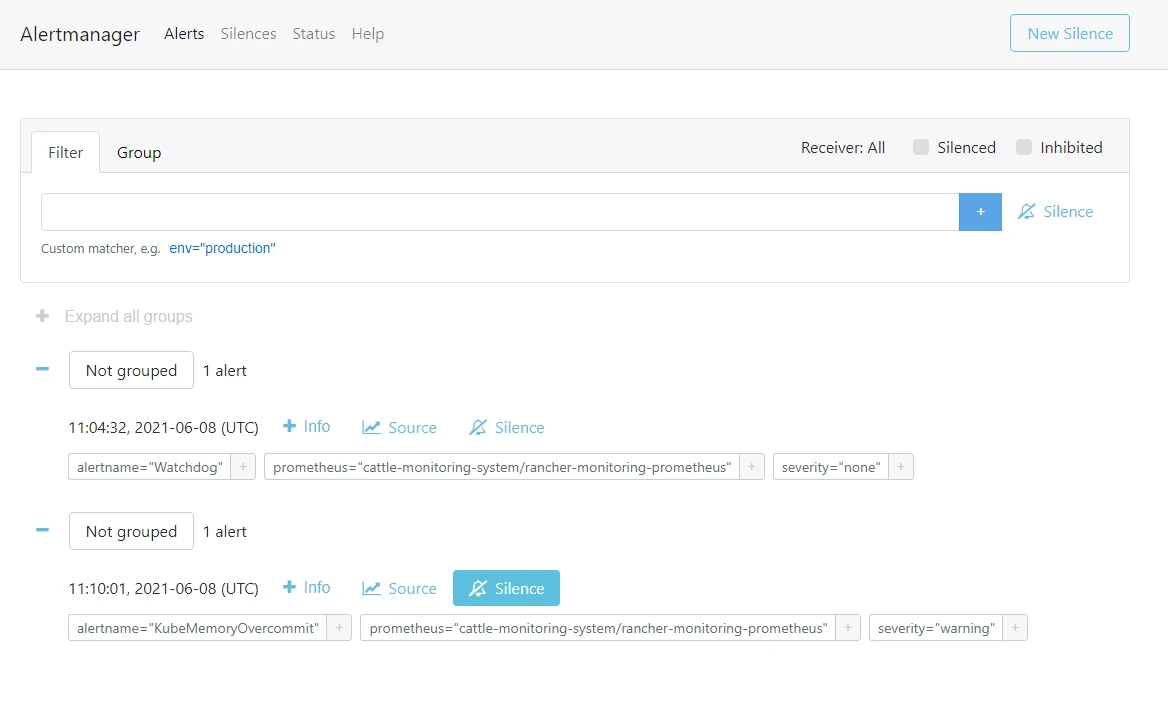

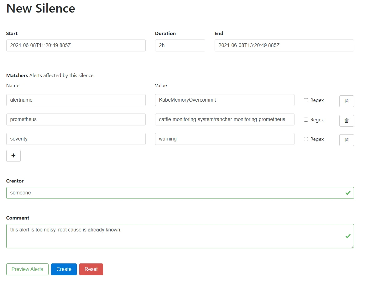

Silencing alerts
If alerts are too noisy, you can silence them. To do that, take the following steps:
Select the Alertmanager tile in the upper left corner of the Monitoring dashboard. The following screen is displayed.
Find the alert in question, and select Silence.
Fill in the Creator and Comment details, and select Create. The alert should no longer show on the Monitoring Dashboard or be reported to any of the configured receivers.

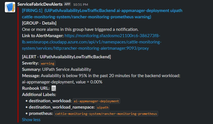

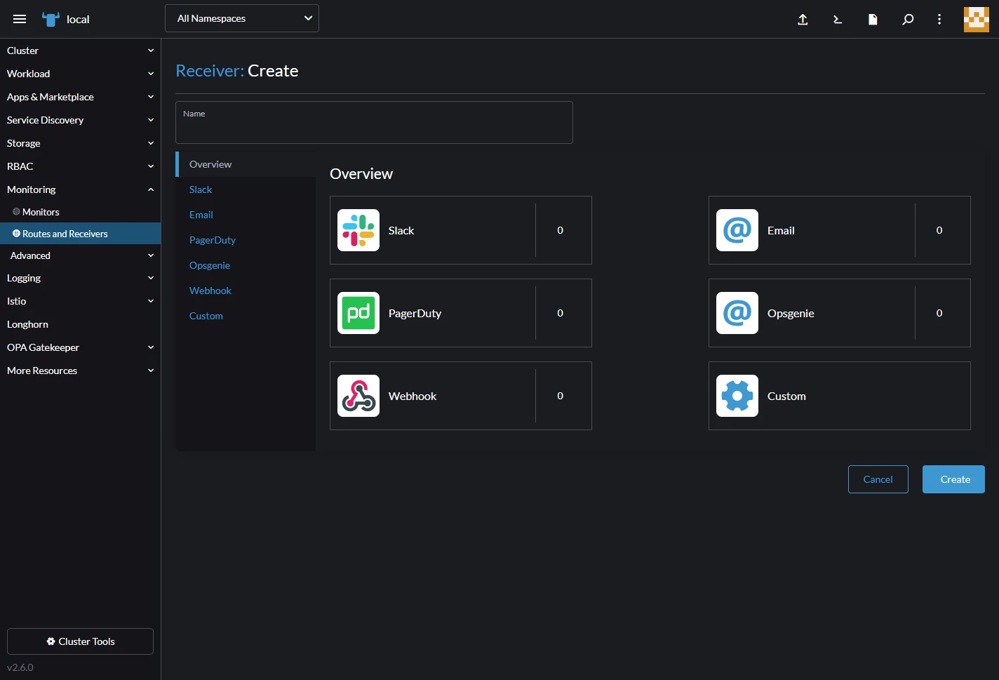

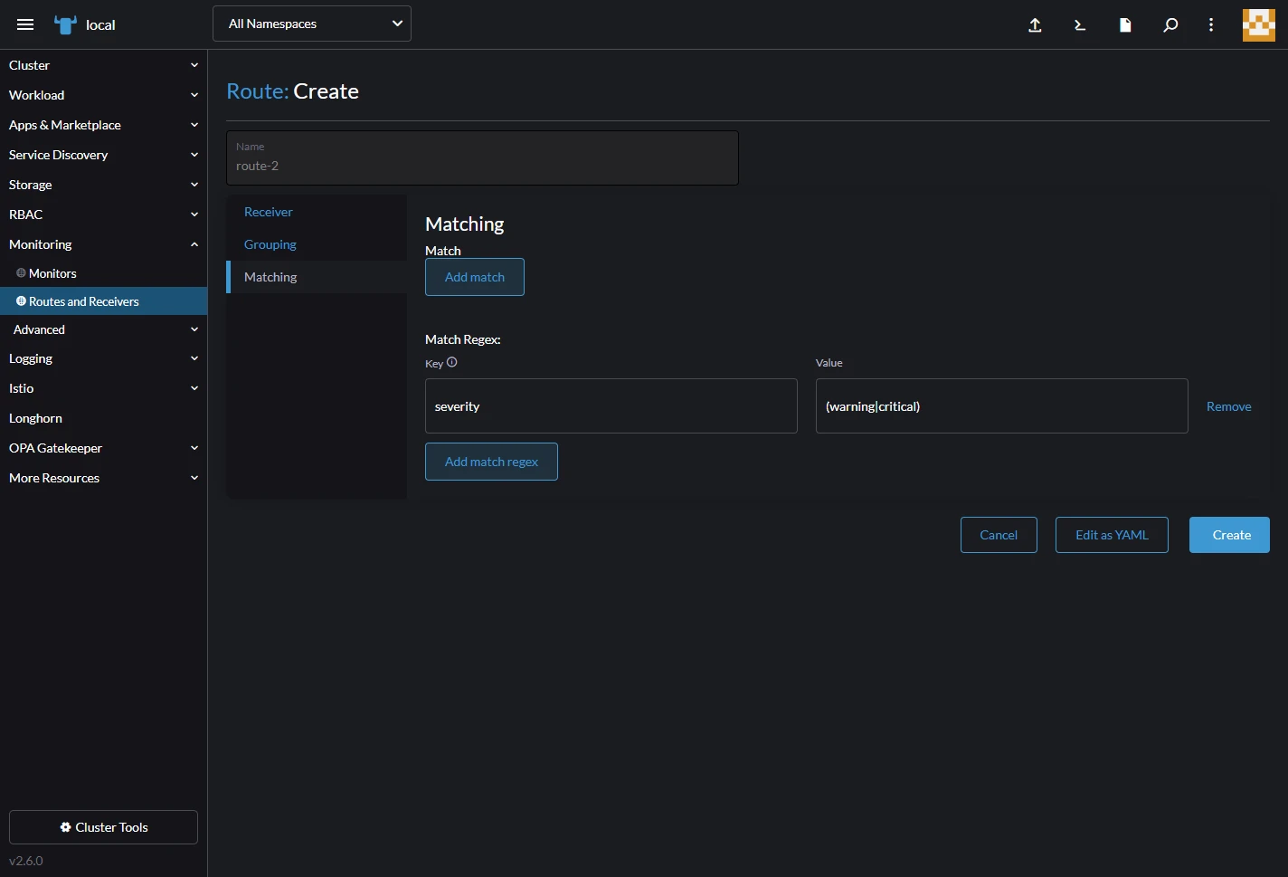

Sending Alerts to an External Receiver
It is highly recommended to set up an external receiver for alerts. This way, alerts will be pushed as they happen, instead of requiring a refresh of the Monitoring dashboard to see the latest alerts.
For details on how to send alerts to an external receiver, see the Rancher documentation on Alertmanager Receiver Configuration.
In addition to a receiver, you must configure at least one route that uses that receiver. A route defines how alerts are grouped, and which alerts are sent to the receiver. See the Rancher documentation on Alertmanager Route Configuration.
See below for an example of how the alerts will be displayed when using the Slack receiver. Clicking the link to AlertManager will take you to the AlertManager console where alerts can be silenced and there are further links to the Prometheus expression that triggered the alert. Clicking the Runbook URL will take you to this page with specific remediation instructions. These links are also present when alerts are sent to other external receivers.

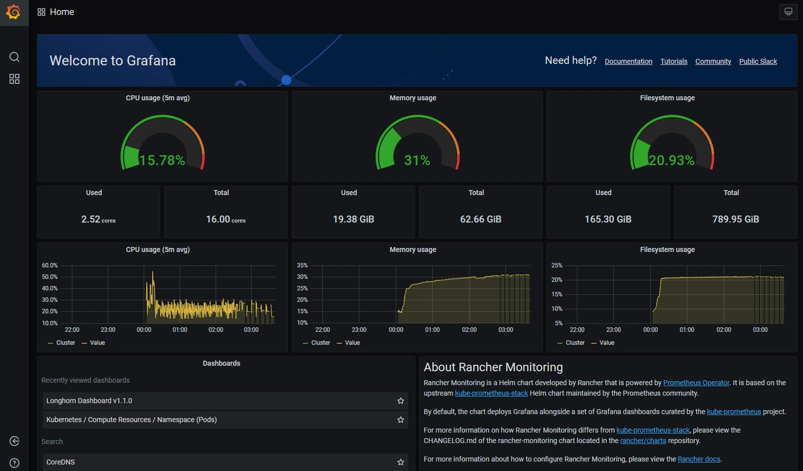

Accessing the Grafana dashboard
On the Monitoring dashboard, click the Grafana tile. The Grafana dashboard is now displayed.

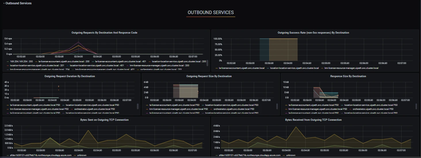

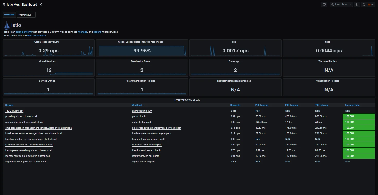

Monitoring the Service Mesh
You can monitor the Istio Service Mesh via the following Grafana dashboards: Istio Mesh and Istio Workload.
Istio Mesh dashboard
This dashboard shows the overall request volume, as well as 400 and 500 error rates across the entire service mesh, for the selected time period. The data is displayed in the upper-right corner of the window. See the 4 charts across the top for this information.
It also shows the immediate Success Rate over the past minute for each individual service. Note that a Success Rate of NaN indicates the service is not currently serving traffic.

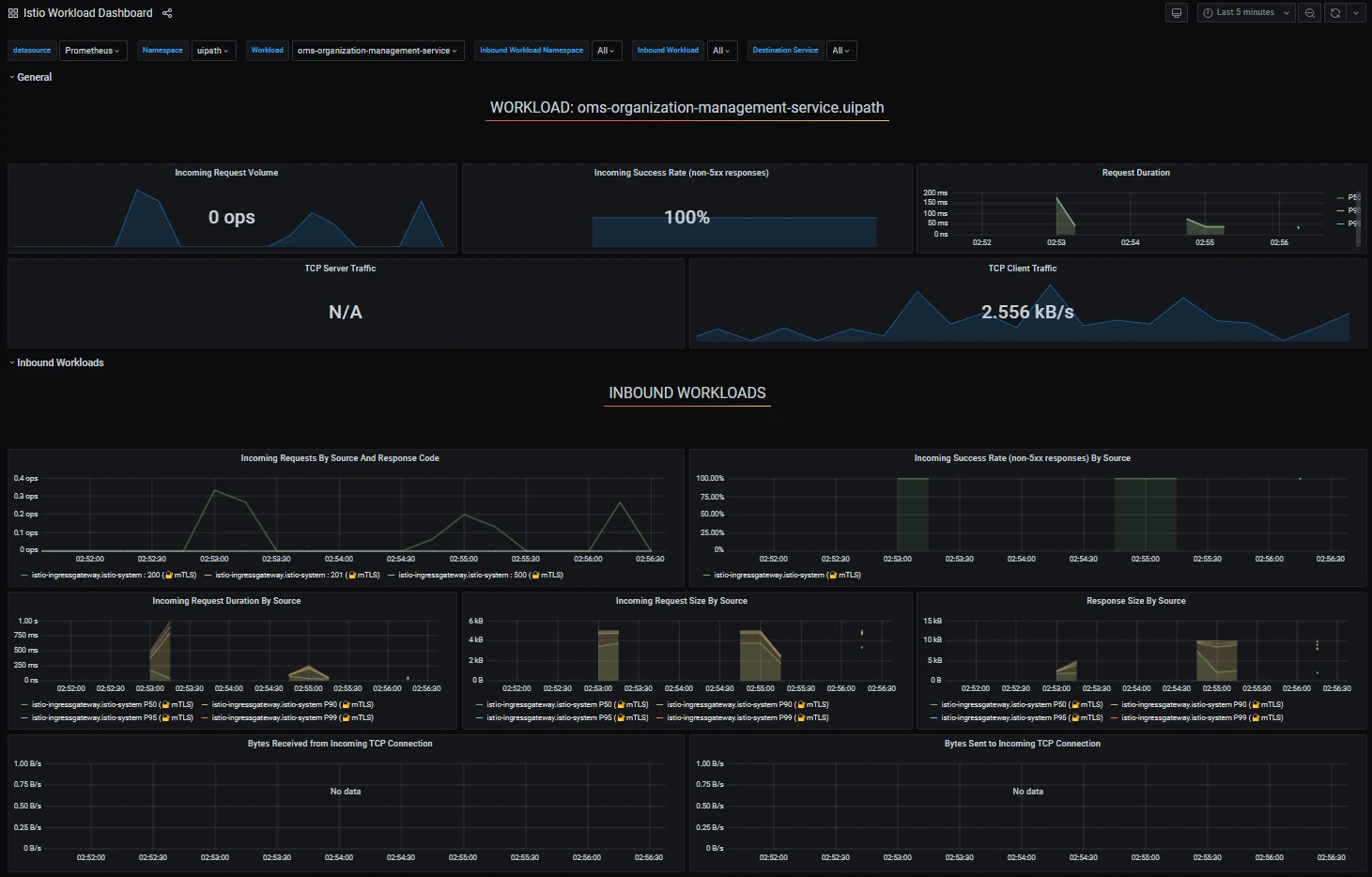

Istio Workload dashboard
This dashboard shows the traffic metrics over the time range selected in the upper-right corner of the window.
Use the selectors at the top of the dashboard to drill into specific workloads. Of particular interest is the uipath namespace.
The top section shows overall metrics, the Inbound Workloads section separates out traffic based on origin, and the Outbound Services section separates out traffic based on destination.

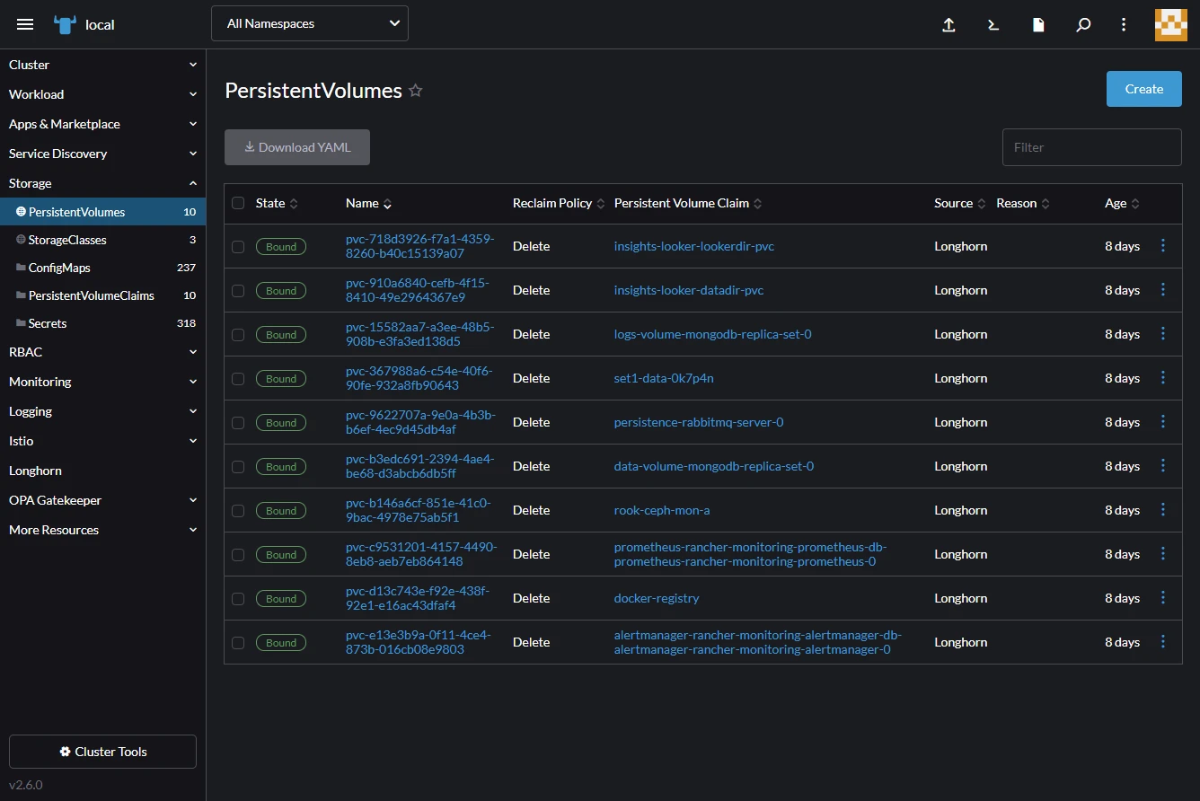

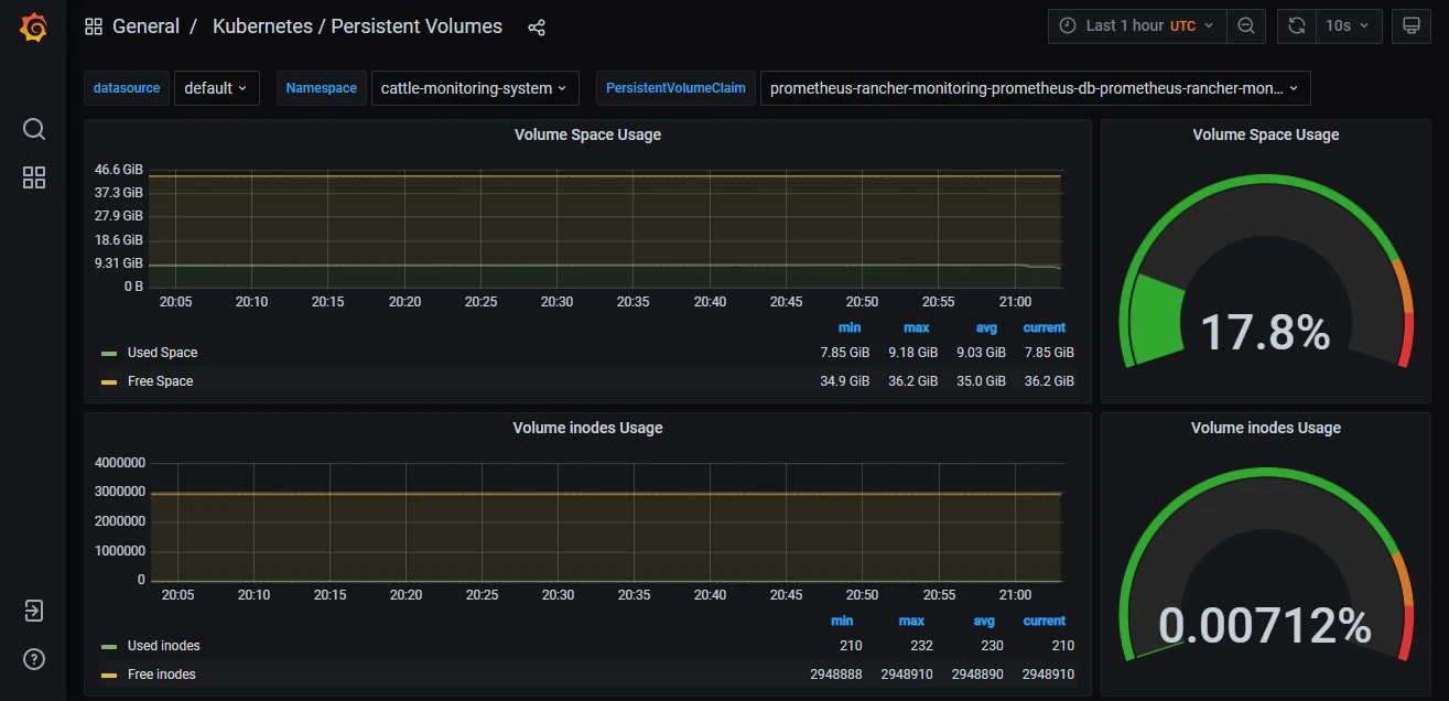

Monitoring Persistent Volumes
You can monitor persistent volumes via the Kubernetes / Persistent Volumes dashboard. You can keep track of the free and used space for each volume.
You can also check the status of each volume by clicking the PersistentVolumes item within the Storage menu of the Cluster Explorer.

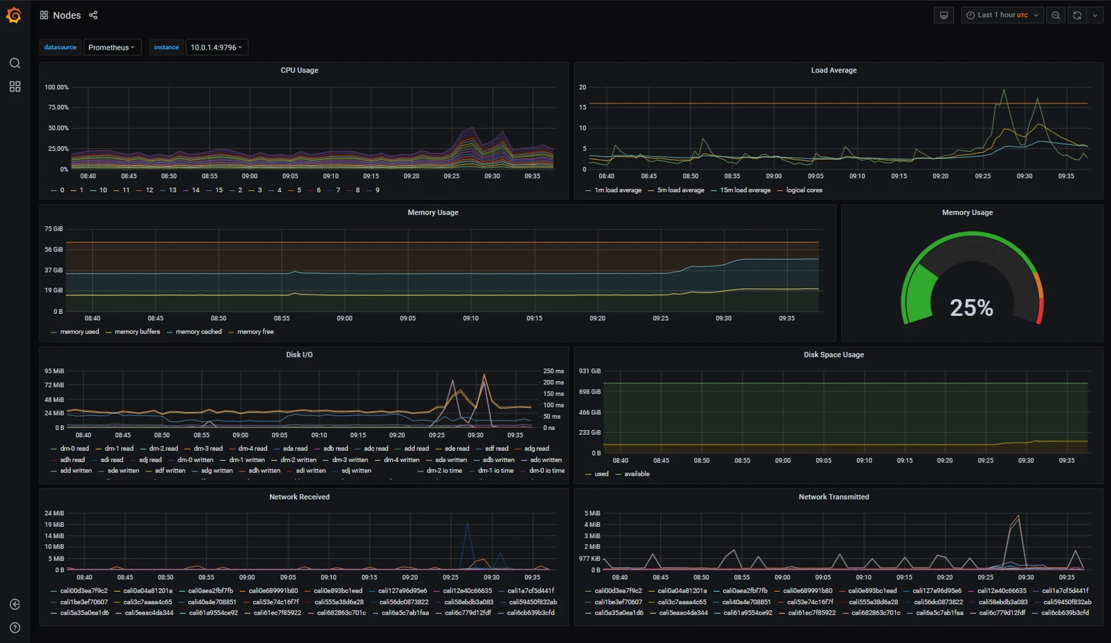

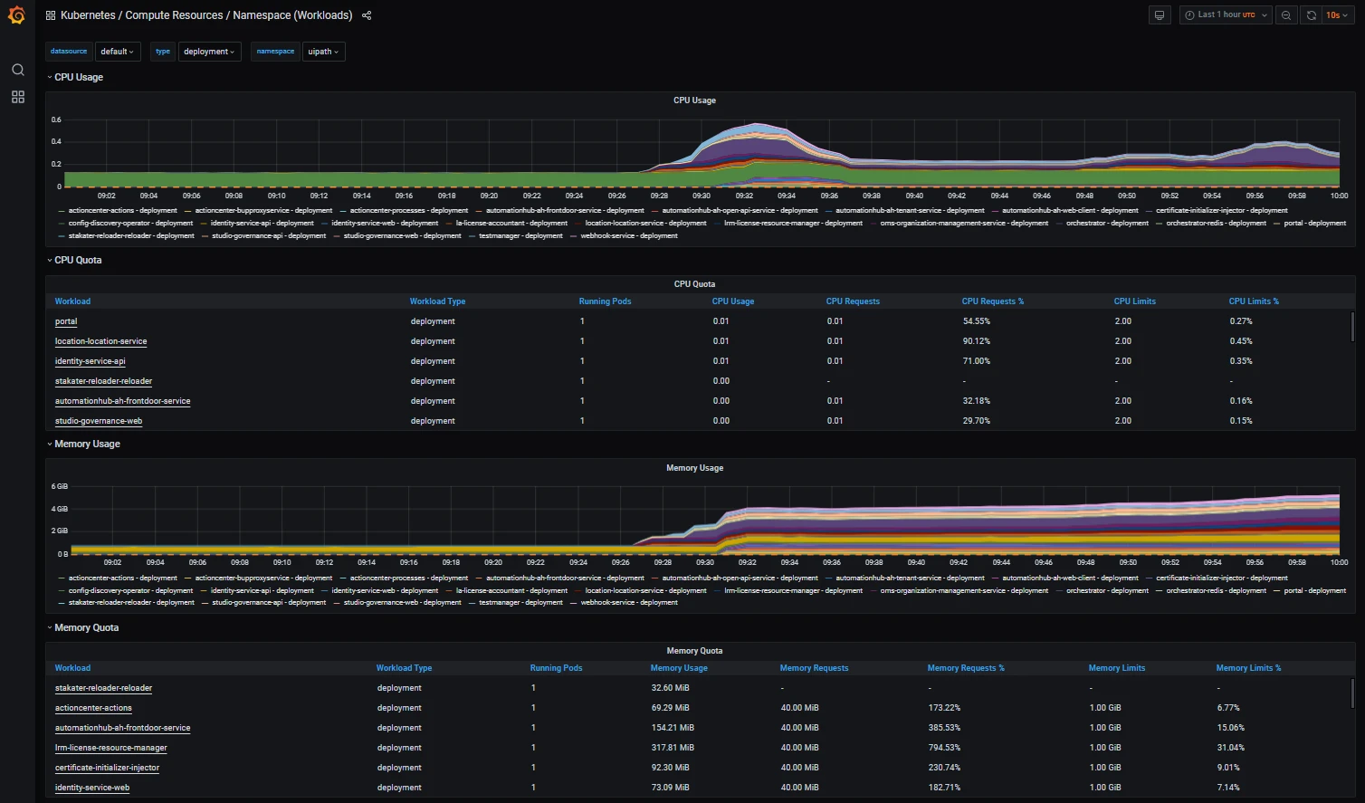

Monitoring hardware utilization
To check the hardware utilization per node, you can use the Nodes dashboard. Data on the CPU, Memory, Disk, and Network is available.
You can monitor the hardware utilization for specific workloads using the Kubernetes / Compute Resources / Namespace (Workloads) dashboard. Select the uipath namespace to get the needed data.

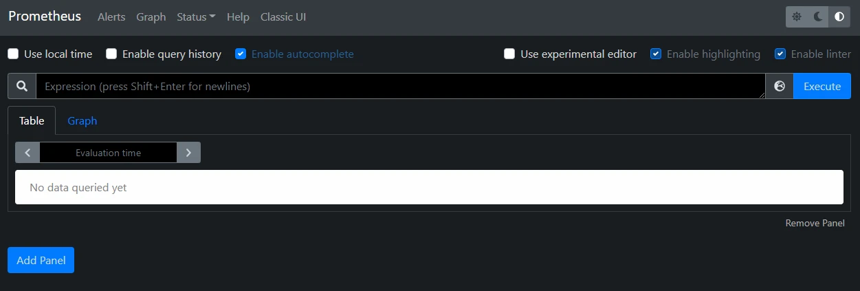

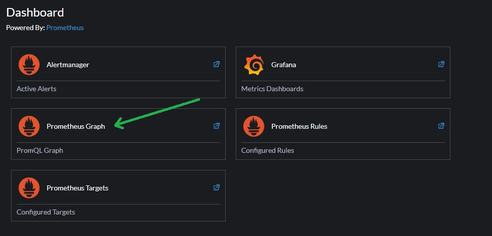

Querying Prometheus
On the Monitoring Dashboard, click Prometheus Graph. A new window is displayed.
Documentation on the available metrics is here:
- https://github.com/prometheus/node_exporter#enabled-by-default - Connect to preview
- https://github.com/kubernetes/kube-state-metrics/tree/master/docs#exposed-metrics - Connect to preview

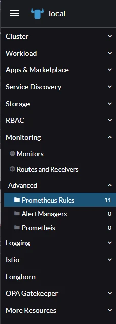

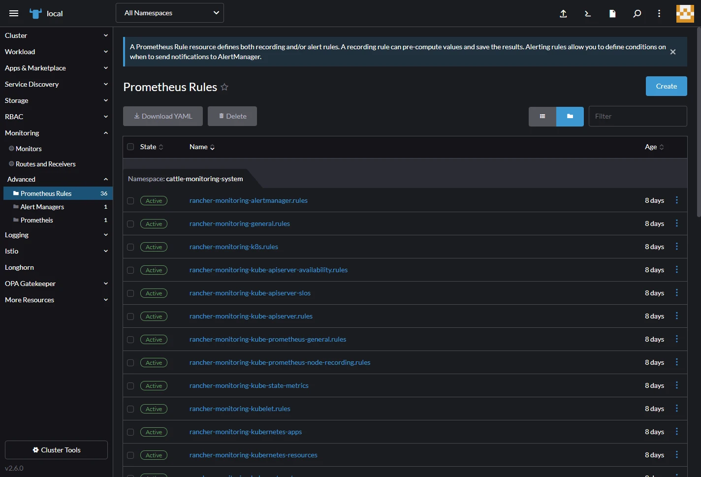

Creating custom alerts
You can create custom alerts using a Prometheus query with a Boolean expression.
To do so, click Prometheus Rules in the Advanced menu of the Monitoring Dashboard.
Click Create in the upper-right corner of the window to create a new alert, and follow the Rancher documentation: PrometheusRules
When the alert fires, it should show on the Monitoring Dashboard. Additionally, it will be routed to any of the configured receivers.

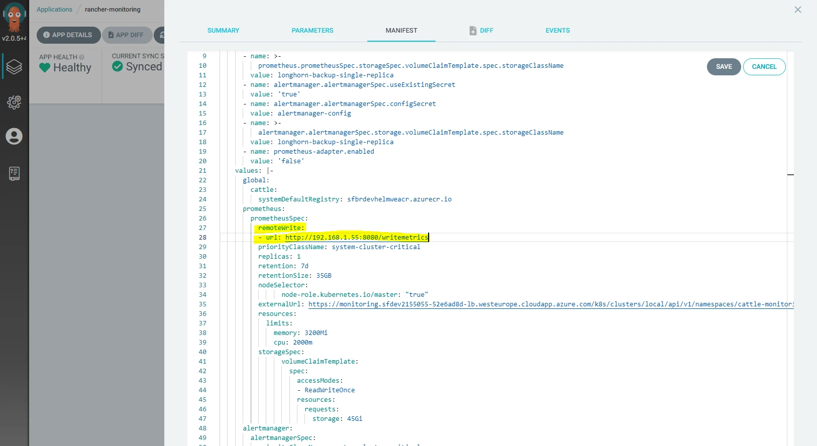

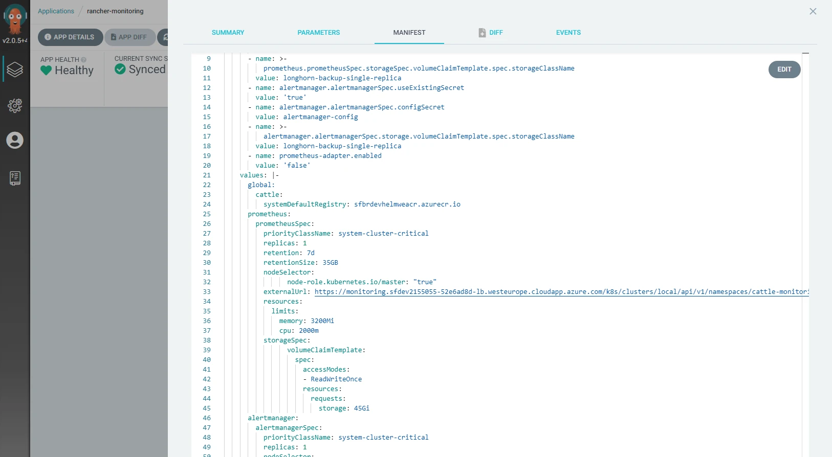

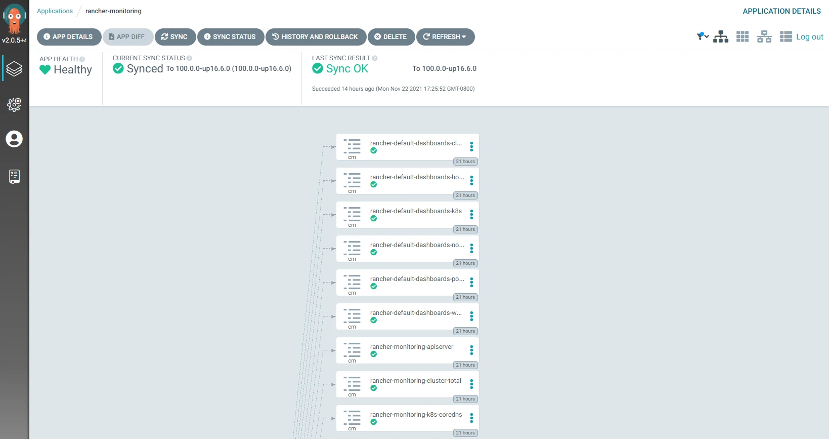

Exporting Prometheus metrics to an external system
Prometheus uses the Prometheus remote write feature to collect and export Prometheus metrics to an external system.
UiPath® does not support or maintain the remote write endpoint integrations. However, the endpoints are compatible with the Prometheus instance delivered within Automation Suite.

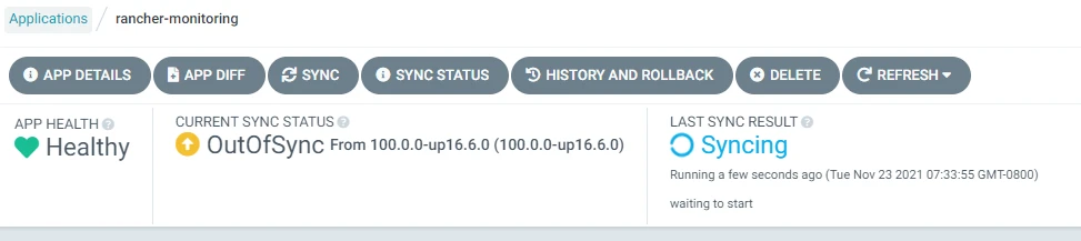

To configureremote_write on an Automation Suite cluster:
Select Applications.
Navigate to fabric-installer.
Open the APP DETAILS panel and disable self-heal.
Navigate to the rancher-monitoring application.
Open the APP DETAILS panel > MANIFEST tab.
Select EDIT and navigate to the values > prometheus > prometheusSpec section.
Add the desired
remoteWriteconfigurations. -

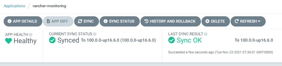

SAVE the new configuration. The rancher-monitoring application displays OutOfSync until the new configuration is applied.
Note:Prometheus does not need to restart to apply the new remote write configurations.
Test the desired remote write integration. Return to step 8 to add a new configuration.
