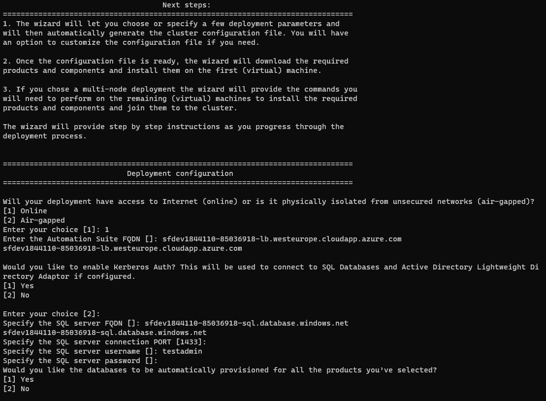

Run the interactive install wizard to configure the installation options. The tool gathers inputs for most common installation options and generates a configuration file that you can use during the installation.
By running the installation using the default configuration, you are opting to run our default experience. You will install our core platform: Orchestrator, Insights, Test Manager, Action Center, Automation Ops, Automation Hub, and Data Service.
To install Automation Suite using the interactive wizard, take the following steps:
