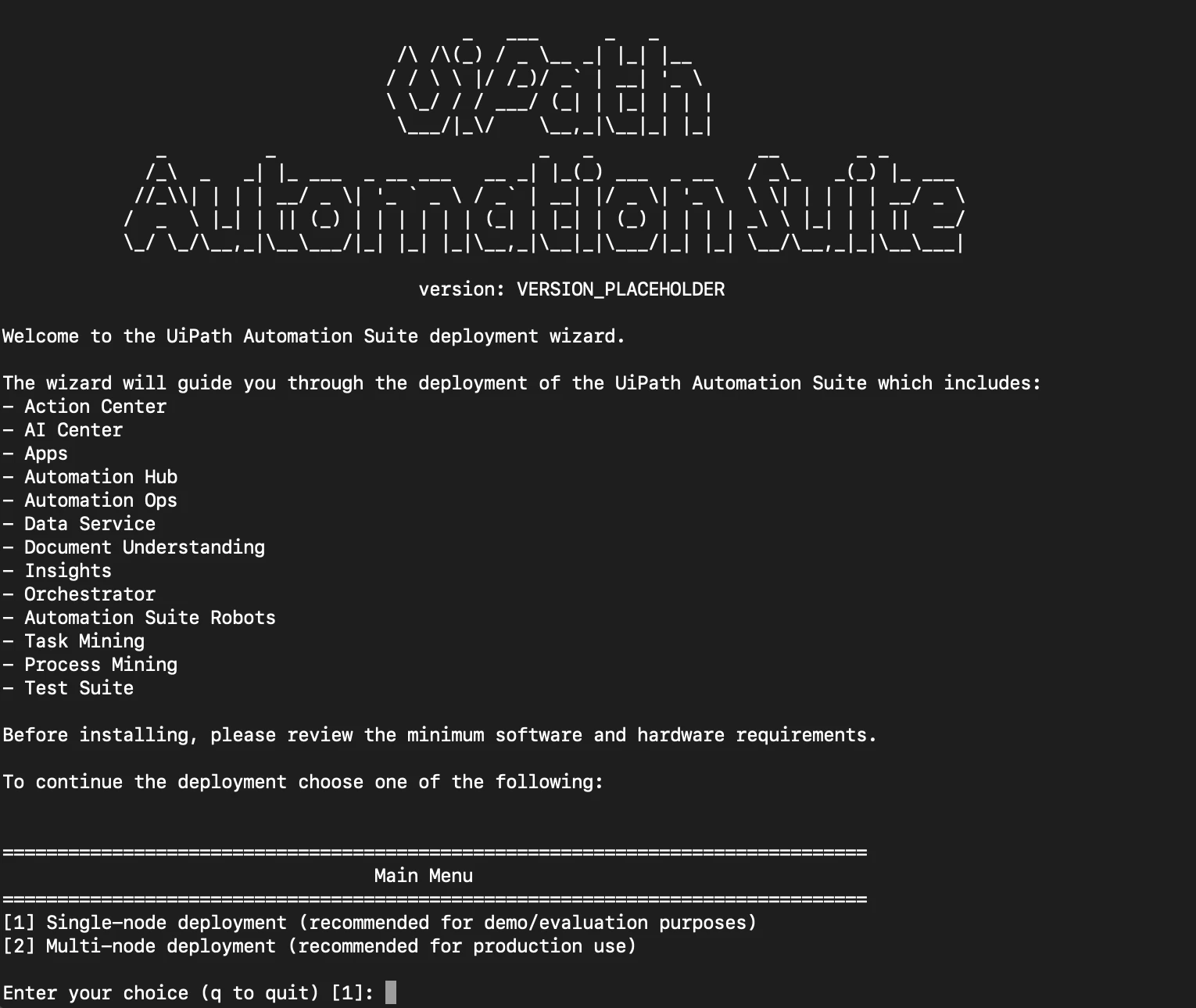

Run the interactive installer to configure the installation options. The tool gathers inputs for the most common installation options and generates a configuration file. HAA is not supported in single-node evaluation mode.
To install Automation Suite, take the following steps:
Start the interactive installer.
Accept the license agreement to continue the installation.
In Main Menu, select your deployment mode. Choose Single-node deployment (recommended for demo/evaluation purposes) and confirm your selection.
In Deployment configuration, select your environment type. Choose Online.

Specify whether you want to use Kerberos Authentication for SQL connections.
Enter the SQL Server FQDN. Follow the prompt to enter the connection port, username, and password.
Note:If you install Process Mining, a second SQL Server is recommended. Make sure to provide the warehouse SQL Server URL, connection prompt, username, and password.
For details on the hardware requirements the second SQL Server must meet, see SQL requirements for Process Mining. For more information on how to configure SQL Server for Process Mining, see Process Mining-specific configuration.
Specify whether you want the installer to automatically create the necessary databases.
Provide CA certificates for any external server software that requires a secure TLS communication, otherwise the installation will fail. If you did not enable the TLS communication, you can configure the certificates post-installation.
Note:The installer accepts only Base64-encoded DER certificates in
PEMformat. If the external servers have different CAs, you can concatenate all the public certificates in a single file. -
After defining the configuration parameters, the installer autogenerates the configuration. You can edit the configuration parameters directly in the terminal.
Note:You can now directly edit the
cluster_config.jsonfor advanced configuration settings in theUiPathAutomationSuitefolder. After you edit the configuration file, you need to re-run the interactive installer to complete the installation or complete it manually. -
At this point, you can proceed with the installation. When the process completes, you have Automation Suite installed on a given machine.
Note:At the end of the installation process, you are prompted with a deployment summary that gives you access to the Cluster Administration portal, host portal, organization administration interface, Rancher, ArgoCD, and more.

Step 3: Completing the installation
You have completed the installation successfully, and you can now move to post-installation steps.
