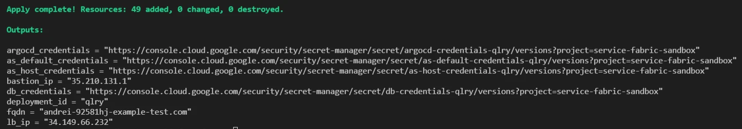

Accessing the deployment outputs
To get the deployment outputs, take the following steps:
Open a terminal.
Go to the directory from which you ran the deployment commands.
Execute the following command:
terraform outputterraform output
The output should look similar to the following image:
Output definitions
The outputs give you the necessary information for accessing the suite and the cluster.
The following table describes the values:
| Key | Description |
The fully qualified domain name provided for the installation. Make sure you use the same one when configuring the DNS. For instructions on how to configure the DNS, see: |
The load balancer’s IP address used for configuring the DNS. |
The IP address of the bastion VM needed to access the cluster via SSH. |
The deployment ID included in the name of all the resources in a deployment. |
The URL to the secret containing the credentials for the database. |
The URL to the secret containing the credentials for the Host organization in the Automation Suite portal. |
The URL to the secret containing the credentials for the ArgoCD console used to manage the installed products. |

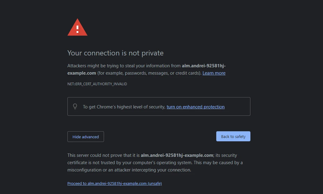

If using a self-signed certificate, you may get an certificate error as shown in the following image.
Click Proceed to…, then update the cluster certificates as explained in Configuring the certificates in a single-node evaluation setup or Configuring the certificates in a multi-node HA-ready production setup.

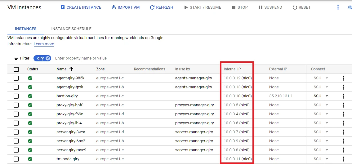

Open a terminal and use SSH to connect to bastion. You can find
bastion_ipin the deployment outputs.ssh -i <path_to_private_key> <username>@<bastion_ip>ssh -i <path_to_private_key> <username>@<bastion_ip> -
From bastion, you can access other nodes via SSH using the following command. The username must be the same as the one used to connect to bastion. You can find the
<node_address>in the GCP console, in the columnInternal IP.ssh -i .ssh/private_key <username>@<node_address>ssh -i .ssh/private_key <username>@<node_address>

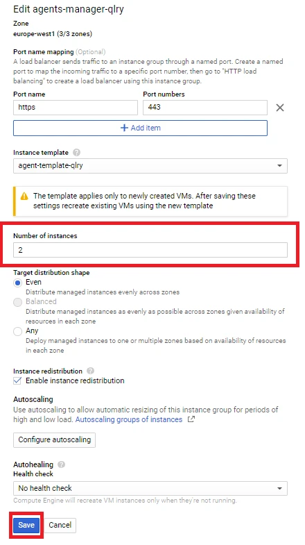

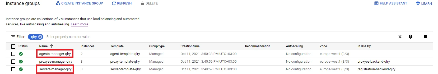

Editing the number of nodes
Use the GPC console to edit number of nodes (server or agent nodes) as follows:
In the Instance Group tab, search for the MIGs, and select on the one corresponding to the node type you want to modify.
Select Edit.
Modify the Number of instances field according to your needs, and select Save.
