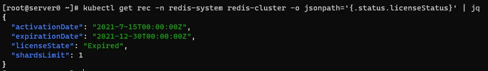

To check the status of the current license, run the following Shell command:
kubectl get rec -n redis-system redis-cluster -o jsonpath='{.status.licenseStatus}' | jqkubectl get rec -n redis-system redis-cluster -o jsonpath='{.status.licenseStatus}' | jq-
Clusters deployed after the current license included in the installer expired will show the trial 4-shard license that expires in 30 days, as in the following example:
Clusters that were already running when the license expired will show the following status:

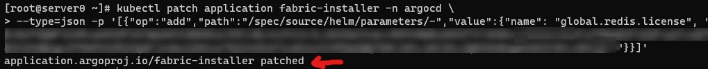

To update the existing license, run the following Shell command:

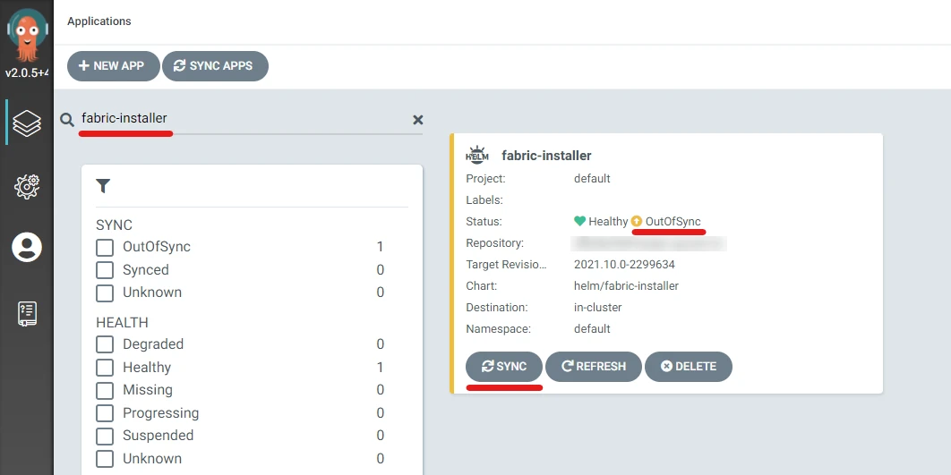

kubectl patch application fabric-installer -n argocd \ --type=json -p '[{"op":"add","path":"/spec/source/helm/parameters/-","value":{"name": "global.redis.license", "value": "<LICENSE_KEY_IN_BASE64>"}}]'kubectl patch application fabric-installer -n argocd \ --type=json -p '[{"op":"add","path":"/spec/source/helm/parameters/-","value":{"name": "global.redis.license", "value": "<LICENSE_KEY_IN_BASE64>"}}]' -

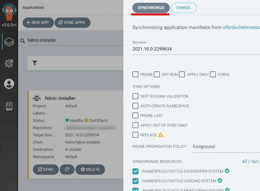

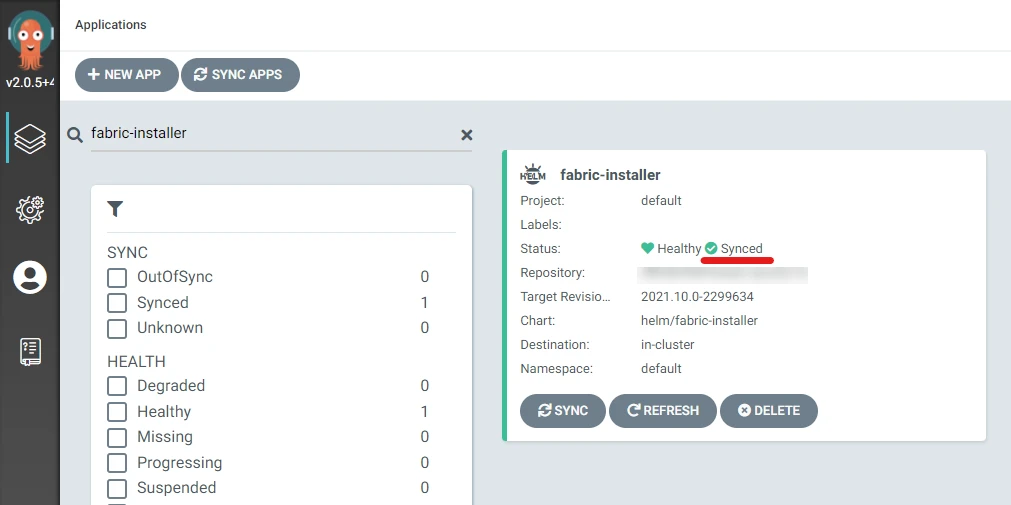

To see if the change was applied, access ArgoCD. See Accessing ArgoCD for instructions.
If the fabric-installer application appears out of sync, and the sync process was not triggered automatically, click the Sync button yourself. This may be happen if you are using an older Automation Suite version.

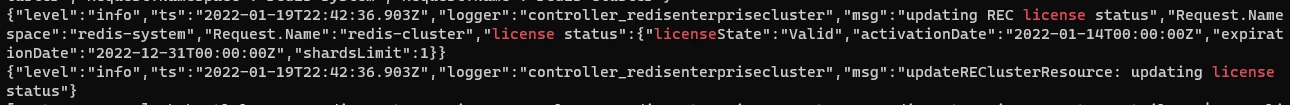

Note:There is a small delay between the moment the ArgoCD UI shows the app synced and when the Redis operator successfully applies the new license.
To see logs from the Redis operator when it tries to apply the license, run the following command:
kubectl logs -n redis-system --since=300s -l name=redis-enterprise-operator -c redis-enterprise-operator --tail=-1 | grep licensekubectl logs -n redis-system --since=300s -l name=redis-enterprise-operator -c redis-enterprise-operator --tail=-1 | grep license -
If you try to apply an expired license, or you run the installer that ships with an expired license, you will get the following output:

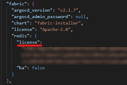

To update the Redis license used by older installers before running them, update the
fabric.redis.licensekey in the<installer_folder>/defaults.json:

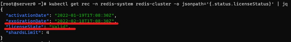

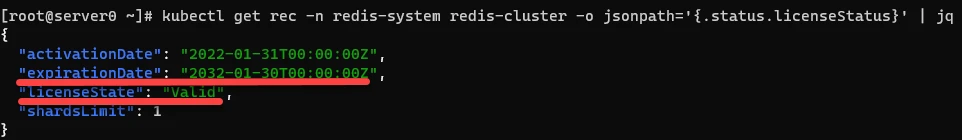

Checking that the new license is applied
To check if the new license is applied, run the following Shell command:
kubectl get rec -n redis-system redis-cluster -o jsonpath='{.status.licenseStatus}' | jqkubectl get rec -n redis-system redis-cluster -o jsonpath='{.status.licenseStatus}' | jqIn the following image you can see that the Redis cluster switched from the trial 30-day license to a single-shard 10-year license.
