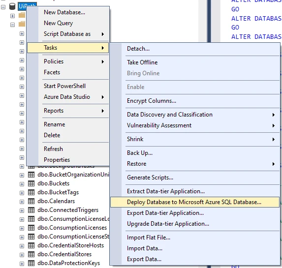

In SQL Server Management Studio connect to the standalone product database, select Tasks, then choose Deploy Database to Azure SQL.

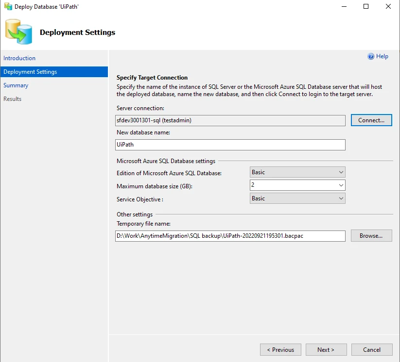

Select Connect to connect to the Automation Suite SQL database. Provide the new database name. Choose the directory to store the temporary database file.

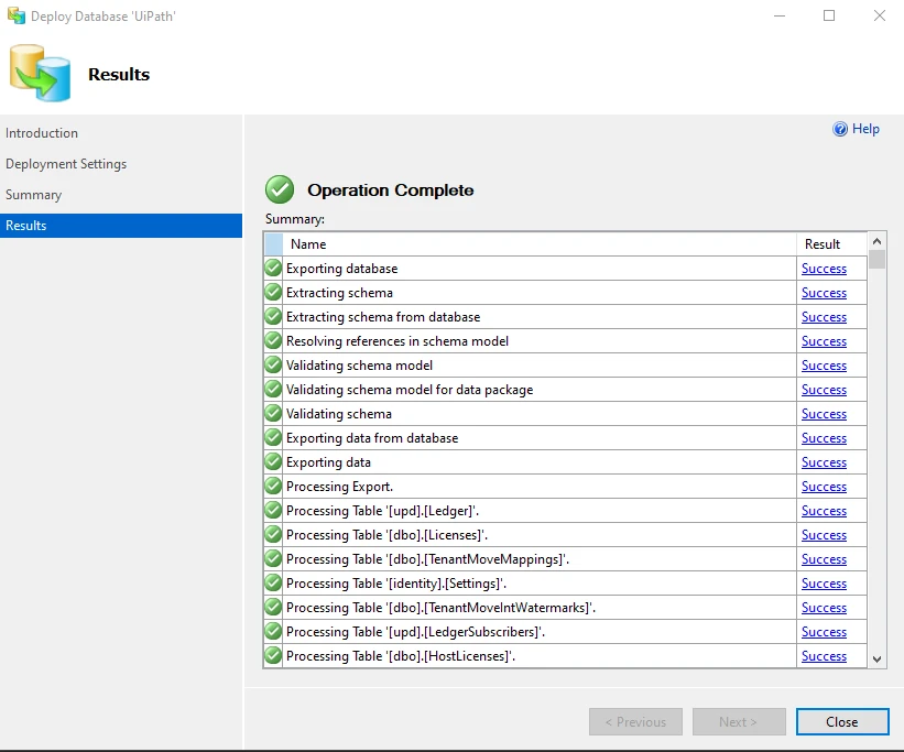

Wait for the deployment to complete.
