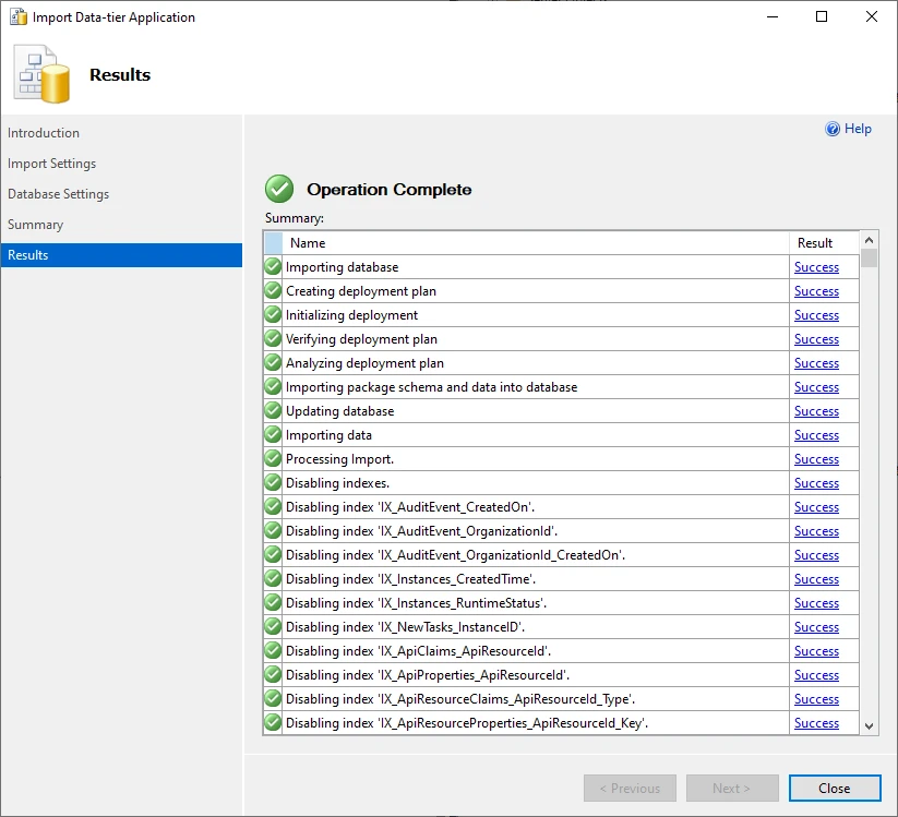

If organization merge failed
If the organization merge failed, check the logs. Depending on whether the Identity or the Orchestrator migration failed, take the following steps:
Failed Identity migration
If the Identity migration failed, you can just fix the error and execute the organization merge command again. This would rollback all the changes since we have set a transaction for operations for Identity.
Failed Orchestrator migration
If the Orchestrator migration failed, the Orchestrator database would roll back, but the Identity database would not rollback. As a result, you must restore the backup of the Identity database and replace the connection string to use the new database. After fixing the error, run organization merge command again.

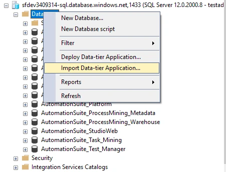

If the Orchestrator migration failed, take the following steps:
Restore the backup of the Identity database.
Right-click the database directory and select Import Data-tier Application.

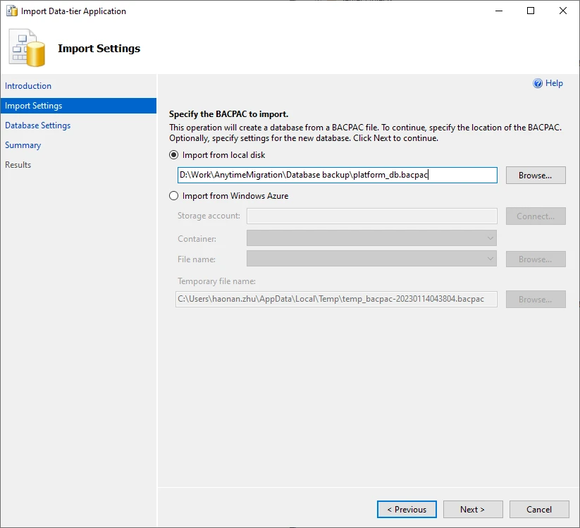

Select the backup database file.

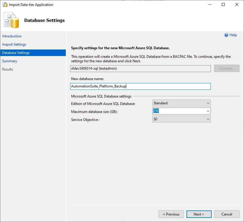

Input the backup database name.
Wait for the process to complete.
Replace the identity connection string.
`"platform": { "sql_connection_str": "<dotnet connection string>", (added line) "enabled": true, },``"platform": { "sql_connection_str": "<dotnet connection string>", (added line) "enabled": true, },` -
Fix the error and use the new platform connection string to run the merge command again.
