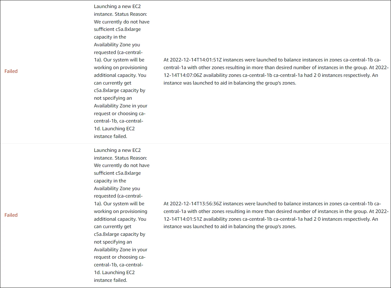

Known issues
Availability Zones instance spread
You might encounter the following error while providing 3 Availability Zones for the deployment:
HA profile needs 3 RAW devices for ceph OSDs(current: 2) spread across failureDomain: 'zone'
[ManagementTools] [Failed] Installing and configuring Application Lifecycle Management Tools
The issue can occur due to insufficient capacity in an Availability Zone for the instance type. Check the Auto Scaling Group activity for messages similar to the following:
