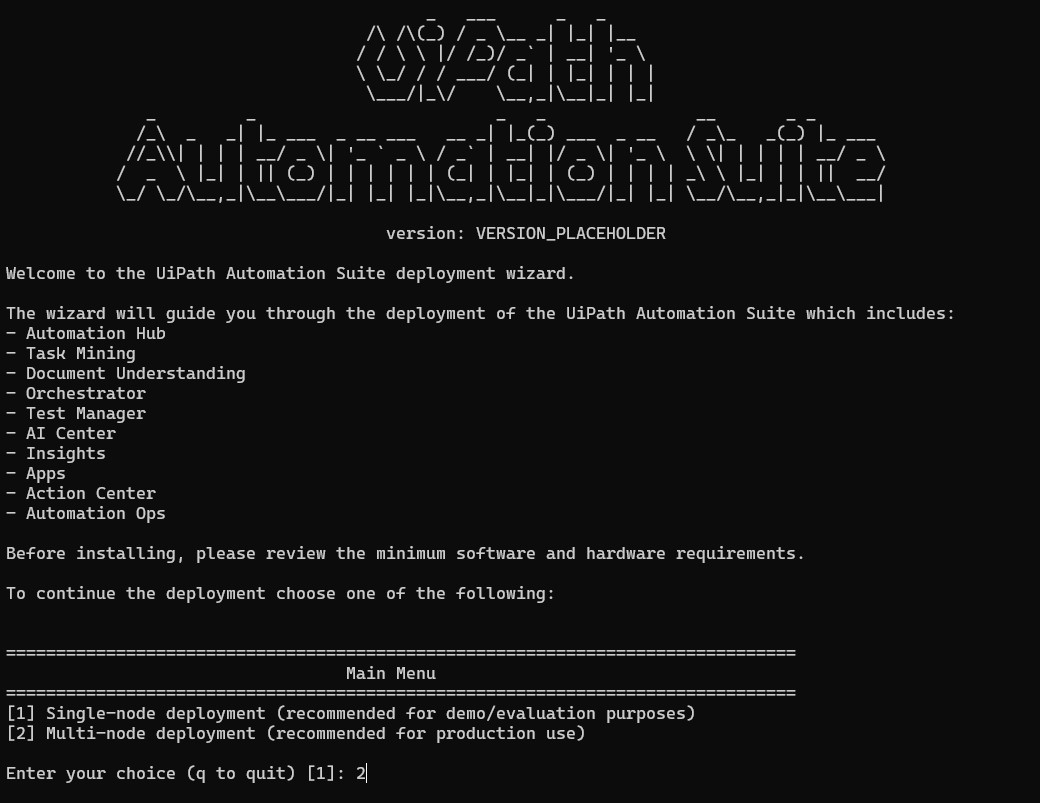

  1. Enter the option for the multi-node HA-ready production mode.
    docs image

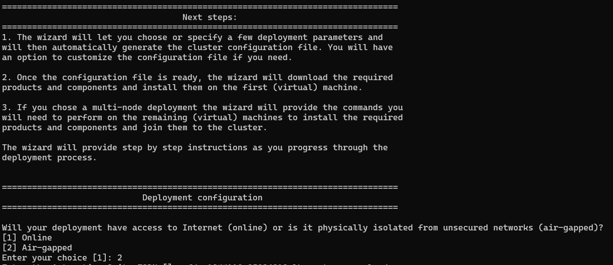

  2. Enter option for air-gapped:
    docs image

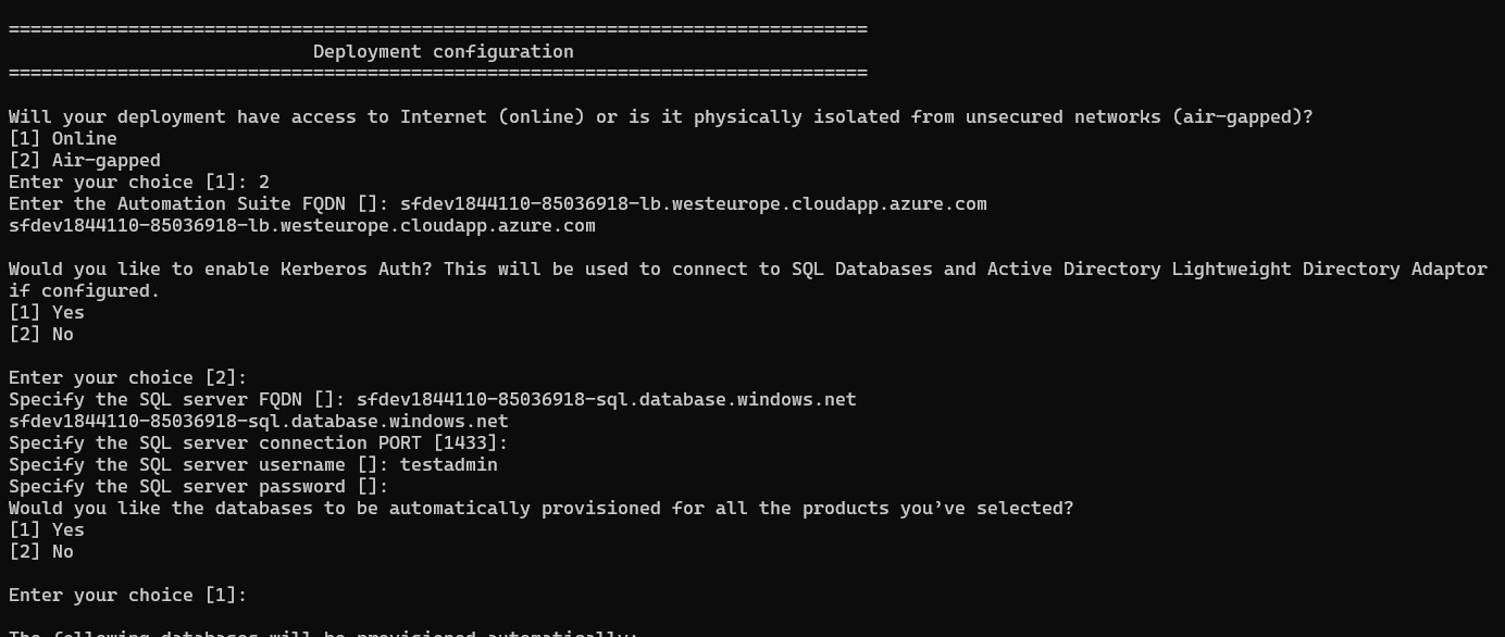

  3. Specify the URL for the cluster (DNS hostname/load balancer URL in multi-node HA-ready production mode) and the SQL Server information as shown below:
    docs image

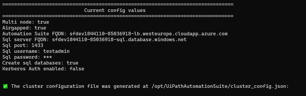

  4. Config will be generated with a folder as shown in the following image.
    docs image
As soon as you generate the configuration file and the folder, you can exit the wizard and proceed with the remaining steps below to complete installation.
