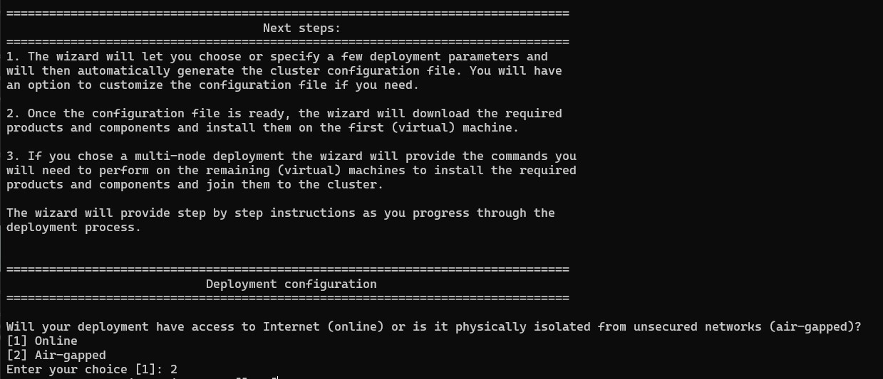

Running the interactive wizard in single-node offline mode
Run the interactive install wizard to configure the installation options. The tool gathers inputs for most common installation options and generates a configuration file that you can use during the installation.
By running the installation using the default configuration, you are opting to run our default experience. You will install our core platform: Orchestrator, Insights, Test Manager, Action Center, Automation Ops, and Automation Hub.
To install Automation Suite using the interactive wizard, take the following steps:
  1. Select Install the UiPath Automation Suite.
    docs image
  2. Select the deployment mode: select the single-node option.
  3. Select continue.

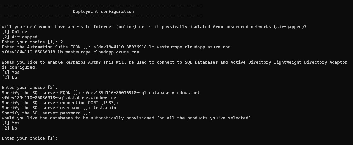

  4. Select air-gapped installation.
  5. Enter the DNS hostname.
  6. Specify whether you want to use Kerberos Auth for SQL connections.
  7. Enter the SQL Server URL. Follow the prompt to enter the connection port, username, and password.
  8. Specify whether you want the installer to automatically create the necessary DBs (see the next step for details).

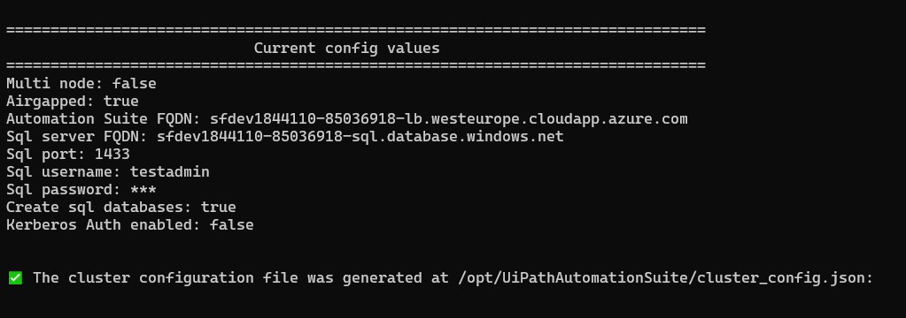

  9. Once the configuration parameters are defined, the installer will autogenerate the configuration. You can edit the configuration parameters directly in the terminal.
    At this step, you can directly edit the cluster_config.json for advanced configuration settings in the UiPathAutomationSuite folder. After you edit the configuration file, you can rerun the wizard to complete the installation or complete manually.
    You can go to the following section here: Advanced configuration step for more details. After editing, you can re-run the wizard to continue with installation.
