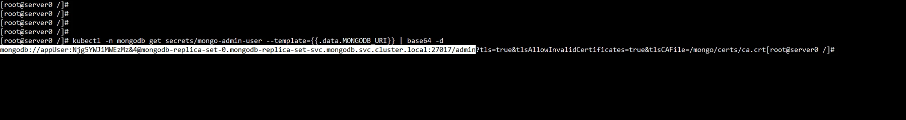

Obtenha o URI do MongoDB usando o comando abaixo.
kubectl -n mongodb get secrets/mongo-admin-user --template={{.data.MONGODB_URI}} | base64 -d // copy and store the output till '/admin' (as highlighted in screenshot) for further use in next commandskubectl -n mongodb get secrets/mongo-admin-user --template={{.data.MONGODB_URI}} | base64 -d // copy and store the output till '/admin' (as highlighted in screenshot) for further use in next commands -
