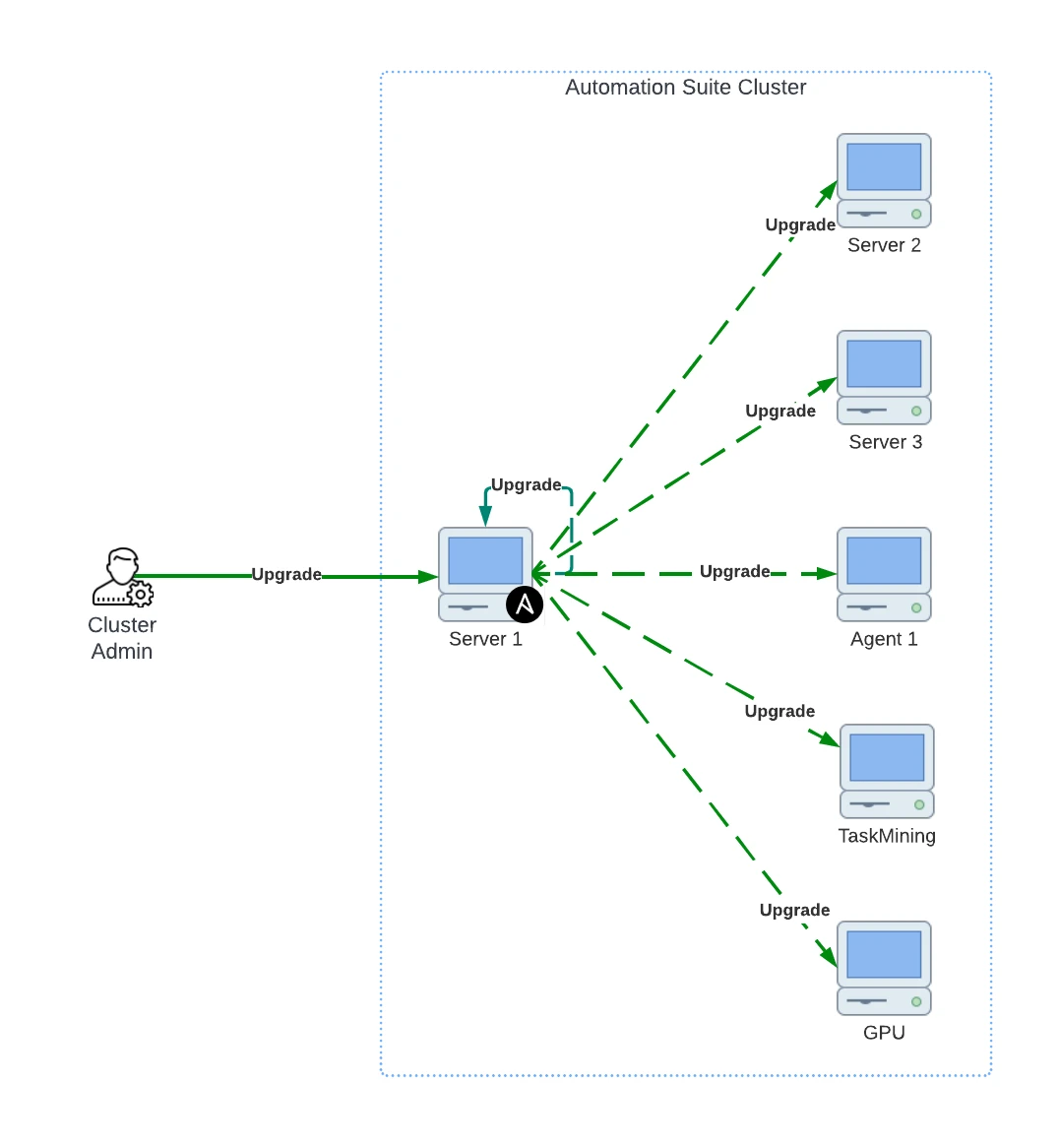

Automated: Offline upgrade
Ansible is used to automate the upgrade of the entire Automation Suite cluster, by performing some operations on one machine in the cluster.
In the following illustration, the Server 1 node (or Ansible host node) uses Ansible to orchestrate the upgrade of entire Automation Suite cluster.

Possible values are: Denotes each stage of the installation and upgrade process.
--steps bundles infra.
Do not run
If an error occurs during the upgrade, you can use these checkpoints to resume the upgrade operation instead of retrying from start. |
Path to the |
Path to the |
Advanced parameters
| Parameter | Value |
--ansible-username | Specify the username to be used for SSH connections to all the nodes. Defaults to the current user. If you use a different username for all the nodes, then instead of using this parameter, set the username for all the nodes in inventory.ini and pass it to the script.Example: While running the script, you are logged in as the myadminuser username. However, if you want to use the testadmin username to connect via SSH, you must provide testadmin to this parameter. |
--inventory | Specify an existing Ansible inventory file. If not specified, one will be generated automatically from the existing cluster with the basic configuration. In certain scenarios where you want to have more granular control, you may want to provide your own inventory file. One such example would be if you want to use a different SSH username or SSH key for all the nodes in cluster. For details, see Generating the Ansible inventory.ini file. |
If the upgrade failed for any reason, but the upload to the Docker Registry is successful, no re-upload is required. You can resume the upgrade by directly running the fabric or service installation: ./uipathctl.sh upgrade --install-type offline --steps {fabric | services}.
Once the upgrade is done, maintenance mode will be disabled automatically.
