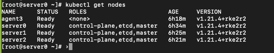

How to get the node name
To get the names of the nodes, take the following steps:
Set the Kubernetes context as explained in Enabling kubectl.
Get the name of the node by running the following command:
kubectl get nodeskubectl get nodes
The following image shows a sample output, where the node names are agent3, server0, server1, and server2.
