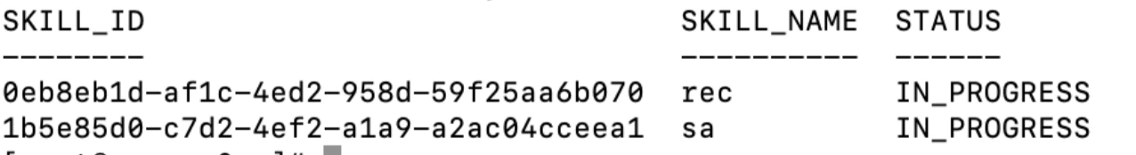

Checking the status of the AI Center ML Skill
To view the status of the AI Center ML Skill, run the following command:
./configureUiPathAS.sh aicenter skill status [skill_ids]
The command can return any of the following statuses:
InProgess- skill deployment is in progress.Failed- skill deployment is failed.OutOfSync- skill is available in the database; however, it has yet to be deployed.Available- when the skills are deployed and available to consume.
Sample output:
