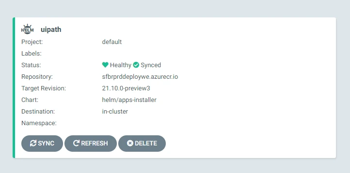

Locate the UiPath Services application as follows:
Using the search bar provided in ArgoCD, type in
uipath. -
Then open the UiPath application by clicking its card.

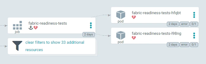

Application was not synced due to a failed job/pod. -
If the above error exists, take the following steps.
Locate any un-synced components by looking for the red broken heart icon, as shown in the following image.

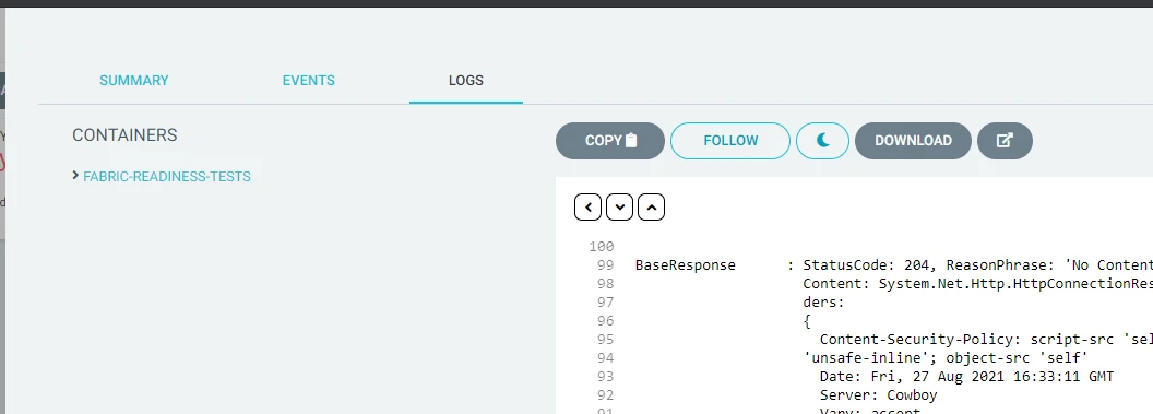

Open the right-most component (usually pods) and click the Logs tab. The Logs will contain an error message indicating the reason for the pod failure.
Once you resolve any outstanding configuration issues, go back to the home page and click the Sync button on the UiPath application.
