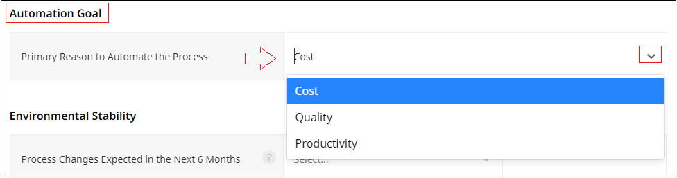

The Detailed Assessment algorithm is implemented to support the automation idea implementation decision. The following criteria can be selected as the primary driver to automate the process:
- Cost
- Quality
- Productivity
The primary driver selected for each automation idea is integrated into the Decision Pipeline Dashboard and facilitates the comparison between automation ideas with the same primary driver.

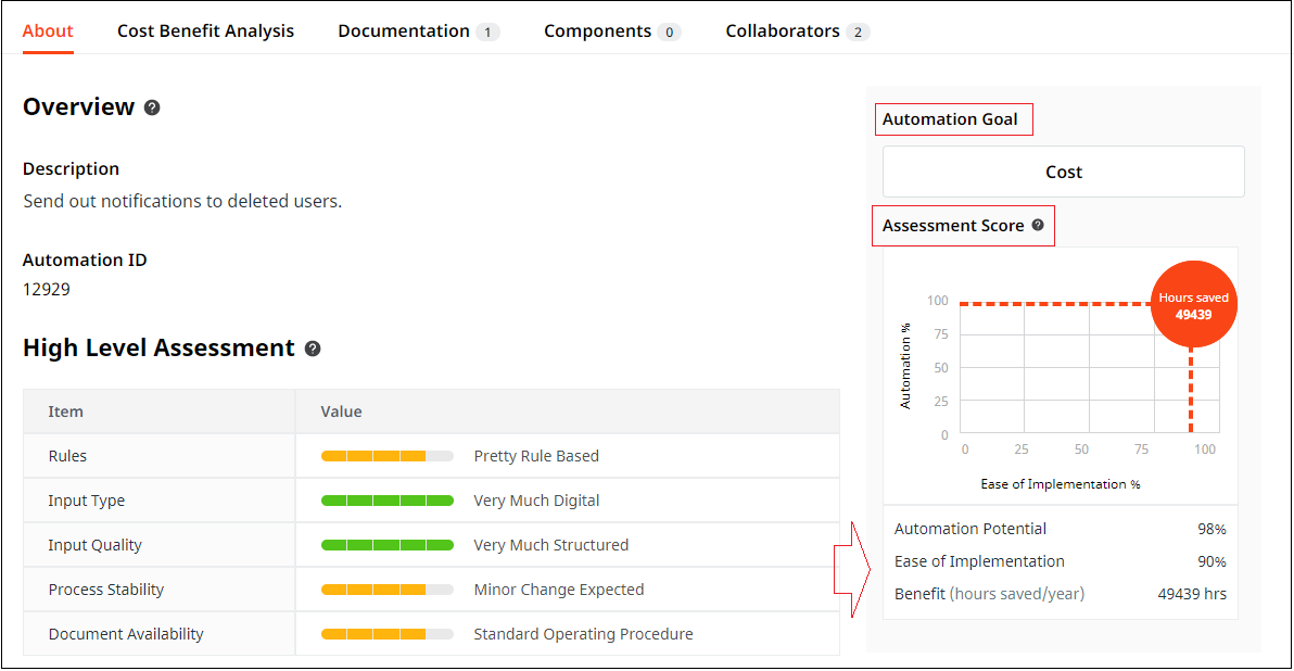

During the Detailed Assessment completion process, an algorithm runs silently to compute the following output scores:
Feasibility - yes/no type
Automation Potential - expressed as % (from 0 to 100% - the higher the better)
Ease of Implementation - expressed as % (from 0 to 100% - the higher the better)
Assessment KPIs - calculated for 1 year period, expressed as the number of hours or value in the selected currency.

Assessment KPIs
This score can measure either the amount of time expressed in hours that could be saved by automating the process/task or the value in the selected currency that is estimated to be saved by the business over a period of 1 year. Each indicator is calculated based on the below formulas:
