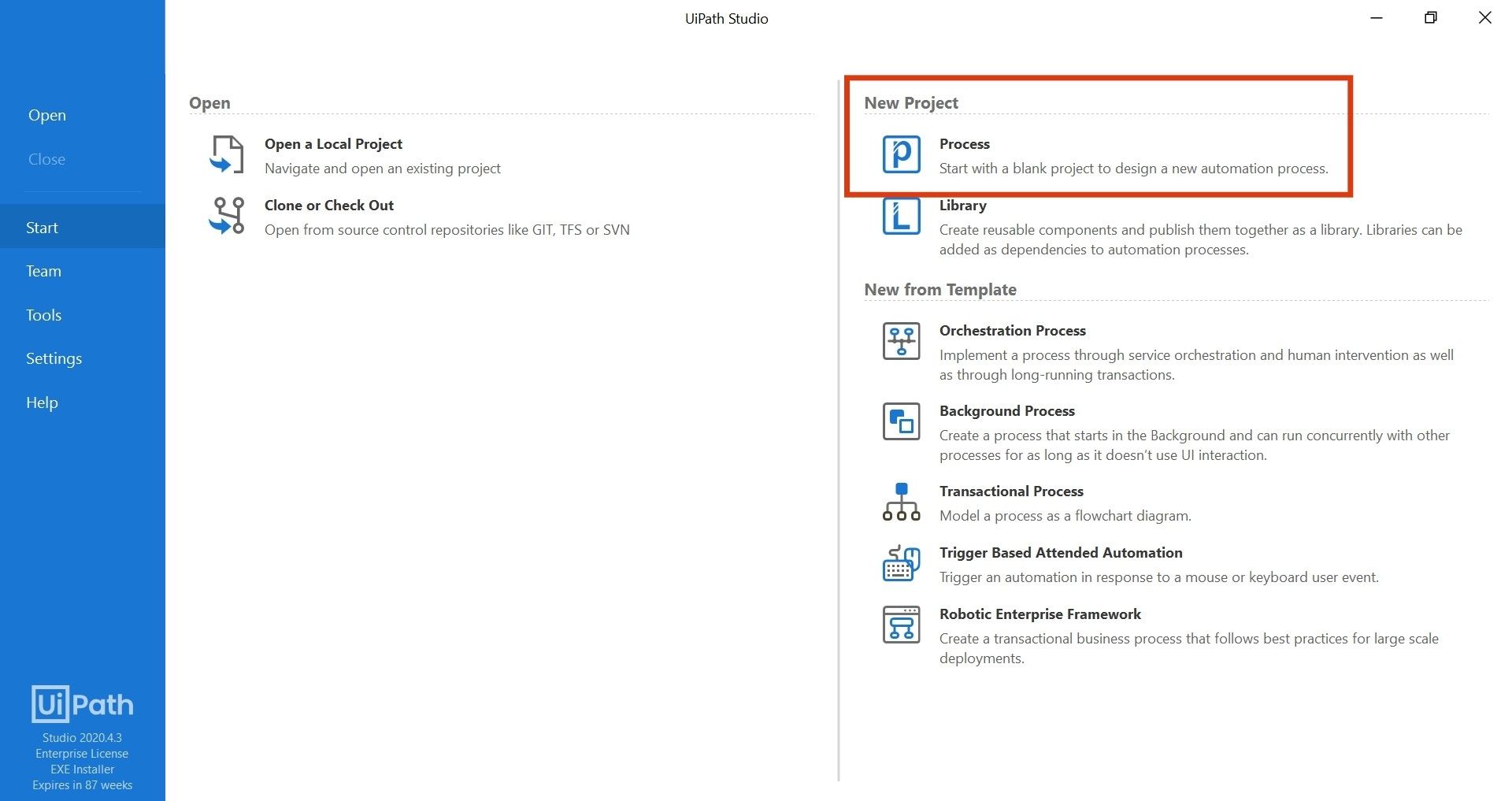

2. Develop the Automation Using Studio
As a general rule, attended automation processes are fit to be run using Assistant. These processes should be designed so that they are smaller, fragmented, and can run with human supervision.
Note:
  • Some attended automation processes run in the same way for everybody i.e. when the user clicks Start in the Assistant, the pre-defined steps are carried out without any variations.
  • But in other cases, the way a process runs depends on parameters that are unique for the user or the context, such as email address, location of the folder, or a message string. In such cases, the process should be built by the developer in UiPath Studio with arguments or customizable input fields.

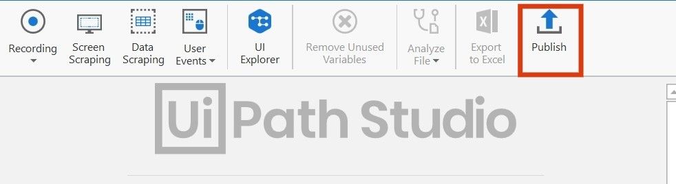

3. Once Your Automation Is Ready, Publish the Process as a NuGet Package in UiPath Studio
All ready-to-go automations for Assistant should be published as a NuGet package in UiPath Studio. It is because UiPath Assistant can consume only a NuGet package.
The NuGet file for Assistant needs to follow the same standards as for Custom Activities described here.

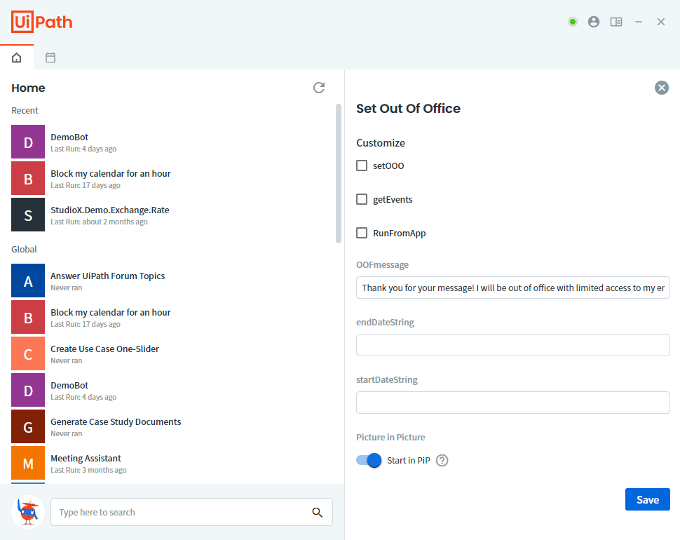

4. Test-run the NuGet Package With UiPath Assistant
To test whether a process developed using UiPath Studio is compatible with UiPath Assistant, the first step is to install the NuGet package of that process in the UiPath Assistant.
  • To install or update the NuGet package from the Orchestrator feed, the robot must be connected to the Orchestrator.
  • Once the NuGet package is installed successfully, the next step is to configure any customizable input fields.
  • If the process is developed in UiPath Studio with any arguments, parameters must be supplied in the customizable input fields in UiPath Assistant. These fields can be accessed in the Assistant by clicking on 'Show Process Details' in the three-dotted menu of the corresponding process.
  • The values supplied to these fields can be saved so that the next time the automation runs, these values are used.

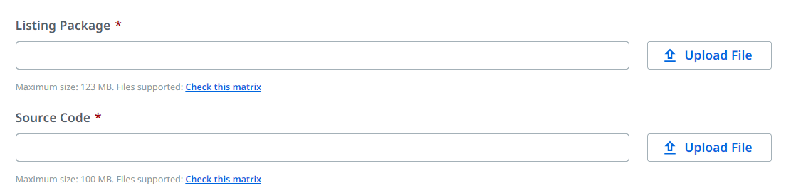

5. Submit the NuGet Package With the Proper Metadata to UiPath Marketplace
Start with checking this article that guides you on how to submit any listing on Marketplace. Here, we have outlined all the steps that the Publishers need to know, including the dos and don'ts.
Note: The NuGet package needs to be uploaded in the Upload Listing File section, and the source code of the attended automation should be provided in the Upload Source Code section.
