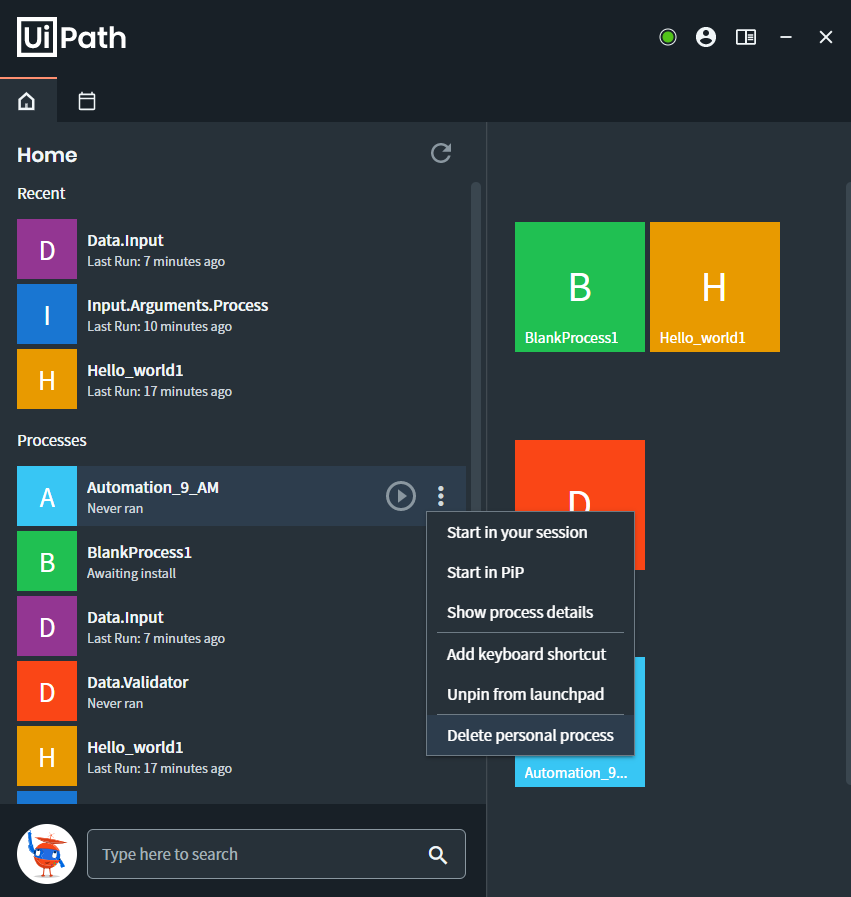

The left side contains the tabs (Home, Reminders, and Marketplace), while the right side, also named "The Launchpad" has your favorite processes to provide easier access to them. You can drag and drop them to arrange them and create sections as shown below. The right side also displays the Process Details when used.

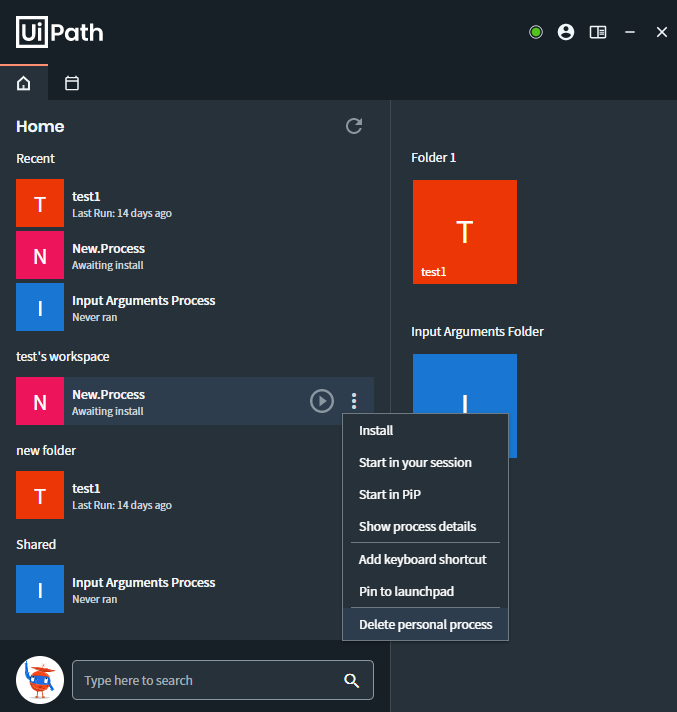

- Add or remove a process from the Launchpad, click the contextual menu and then select "Pin to Launchpad" or simply drag and drop the process from the left panel to the Launchpad.

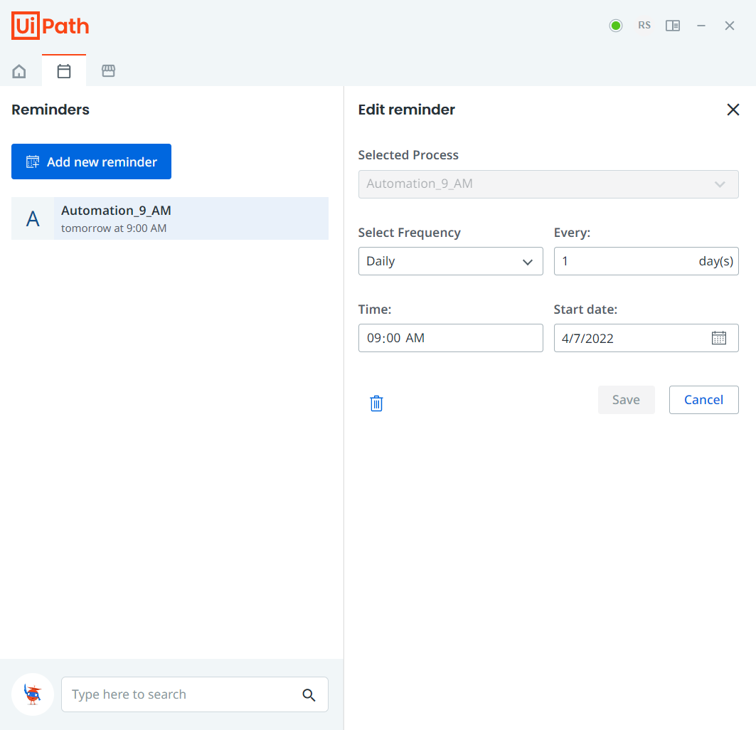

The Reminders Tab
The Reminders tab enables you to specify a time or period for you to receive a notification for starting a process. For any process available in the Process List section, a reminder can be set.
Processes for which reminders are set, appear on the Reminders tab and a notification is displayed once a process is about to start. Please note that a process does not start without your consent. You can snooze the reminder for 10 minutes, dismiss it, or start the process.

The contextual menu allows you to manage a process. Going to the contextual menu and clicking on Delete personal process removes the process from both UiPath Assistant and Orchestrator's personal workspace feed. From here you can also use the Send to desktop feature to create a desktop shortcut which can be used to start the process.

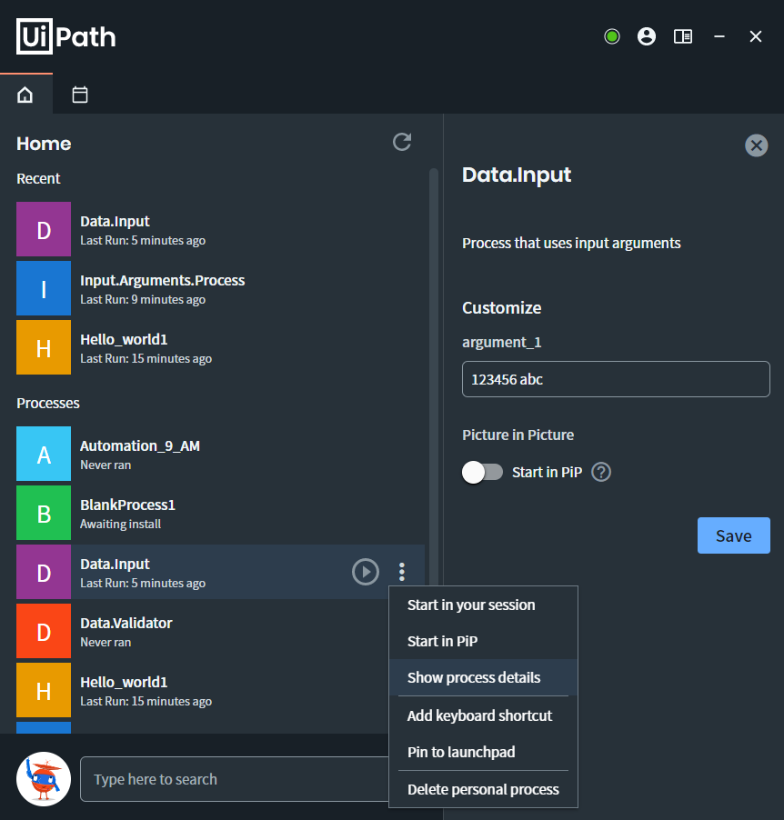

The Process Details submenu provides the following:
- Process Name and Description - these are based on details provided in Studio when the process was created
- Input Arguments used to configure processes that make use of input arguments. If an Input Argument is mandatory, it is marked by an asterisk
next to its name.
History - shows the execution history for a process, clicking on an event displays additional details.

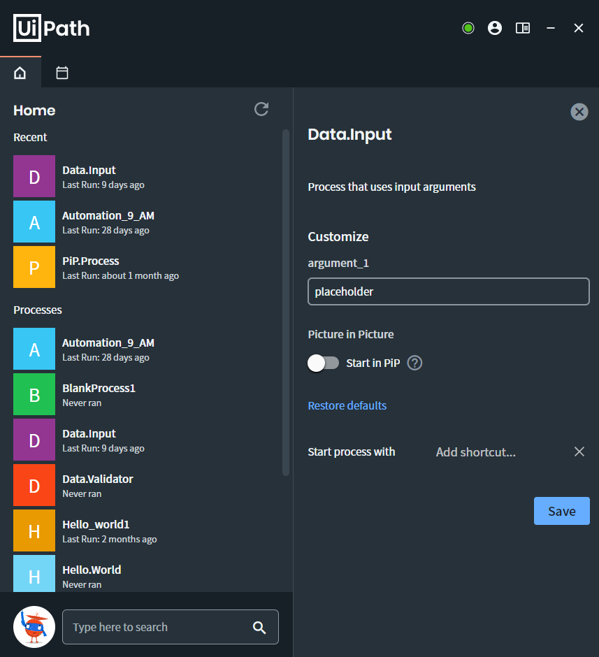

- The Start in PiP toggle is inherited from the project settings in Studio. If a process is set to Start in PiP in Studio, the toggle is enabled. Changing it from the UiPath Assistant overwrites the setting from Studio.
- Keyboard shortcut - provides you with the option to set a keyboard shortcut that starts the process.
