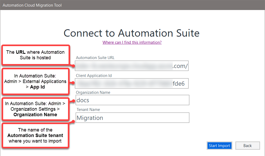

This is one of two ways in which you can migrate your standalone Orchestrator to Automation Suite.
For more information, see .
The tool can migrate to either Automation Cloud™ or Automation Suite, but this page describes the process of migrating to Automation Suite. For instructions on migrating to Automation Cloud, see the Automation Cloud documentation instead.
You can use the UiPath Automation Cloud™ Migration Tool to automatically migrate entities from your standalone Orchestrator to the Orchestrator service in Automation Suite.
When you run the Automation Cloud Migration Tool, it automatically creates the following entities in Automation Suite to match your standalone Orchestrator setup:

- Register the tool as an external application in the target Automation Suite organization.
The tool can migrate one tenant at a time. You can run the tool multiple times for each of your tenants.
With each run, the tool:
Connects to your standalone Orchestrator to export entities for the given tenant.
Connects to Automation Suite to import and create the migrated entities in the Orchestrator tenant.
For more information about entities that are subject to migration, see Entities Being Migrated.
To run the tool:
