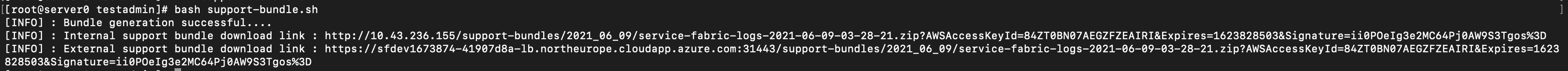

./support-bundle.shThe following image shows a typical output for this command:

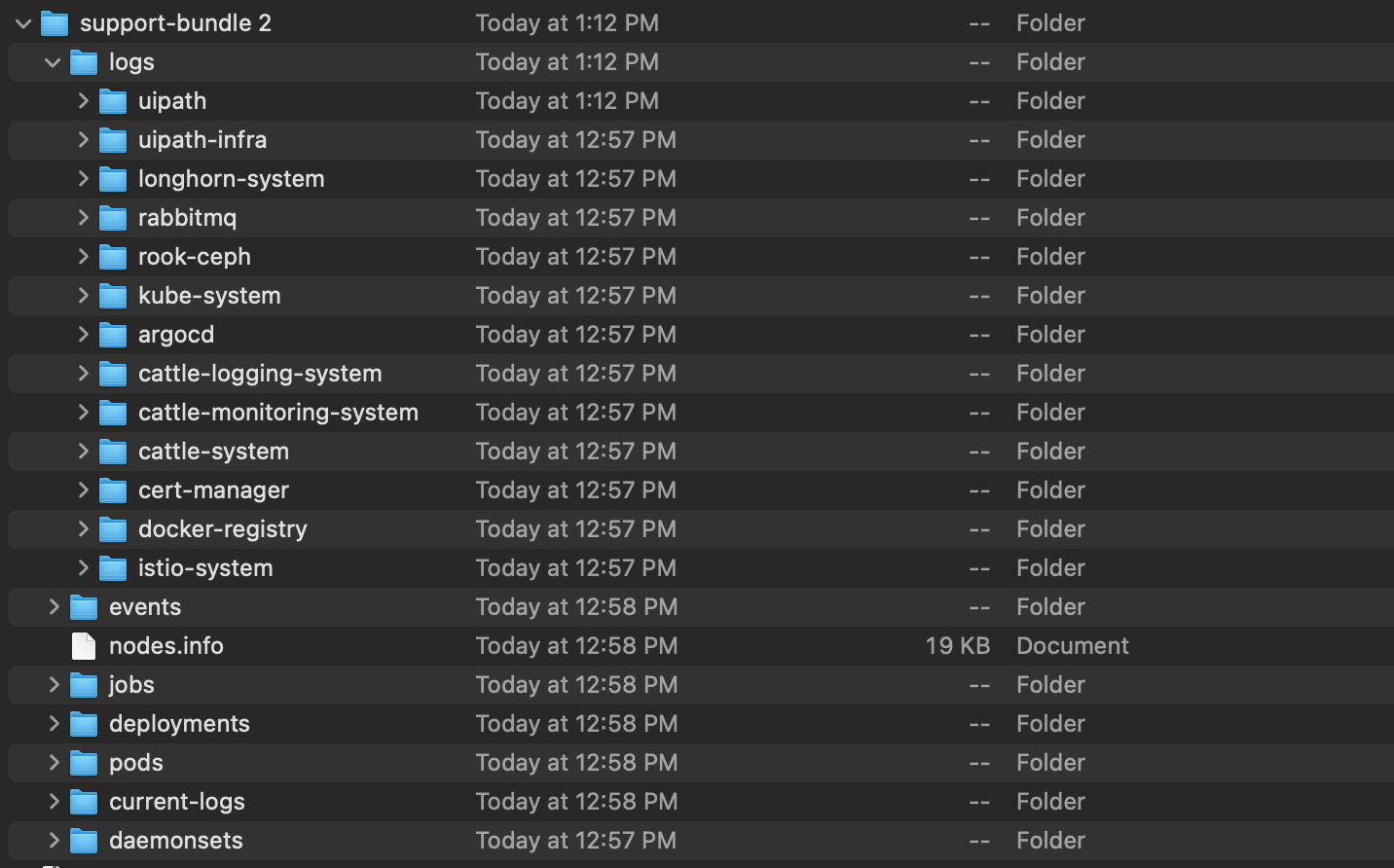

.zip archive contains following files and folders:
File/folder |
Description |
Contains logs collected from the S3 store. |
Contains event descriptions from all the namespaces. |
Contains descriptions of all the nodes in the cluster. |
Contains descriptions of corresponding objects from all namespaces. |
Contains last 4 hour logs from currently running pods. We are collecting this to handle the scenario where Ceph S3 store is down. |
Contains high level usage telemetry stored in individual XML files. |
If passed specific namespace list to the command, the structure would look similar to the one shown in the following image:
