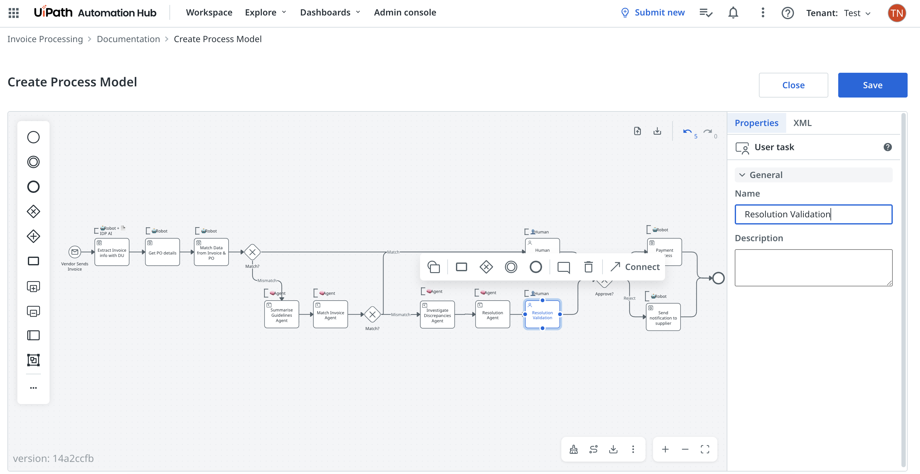

Creating a process model​
  1. Open the business process entry in Automation Hub.
  2. Select the Documentation tab.
  3. Select Create Process Model.
  4. Use the process model editor to model your process.
  5. Select Save.

Adding step details​
You can document information for an individual task or step in a process model.
  1. Select the task or step on the canvas.
  2. In the details panel, add information about the task or step:
    • Files and links
    • Applications
    • Risks
    • Controls
    • Optimization notes
    • Roles responsible for the work
  3. Optionally, assign one or more predefined or custom roles defined for your tenant.
Task details are saved together with the process model when you select Save.
