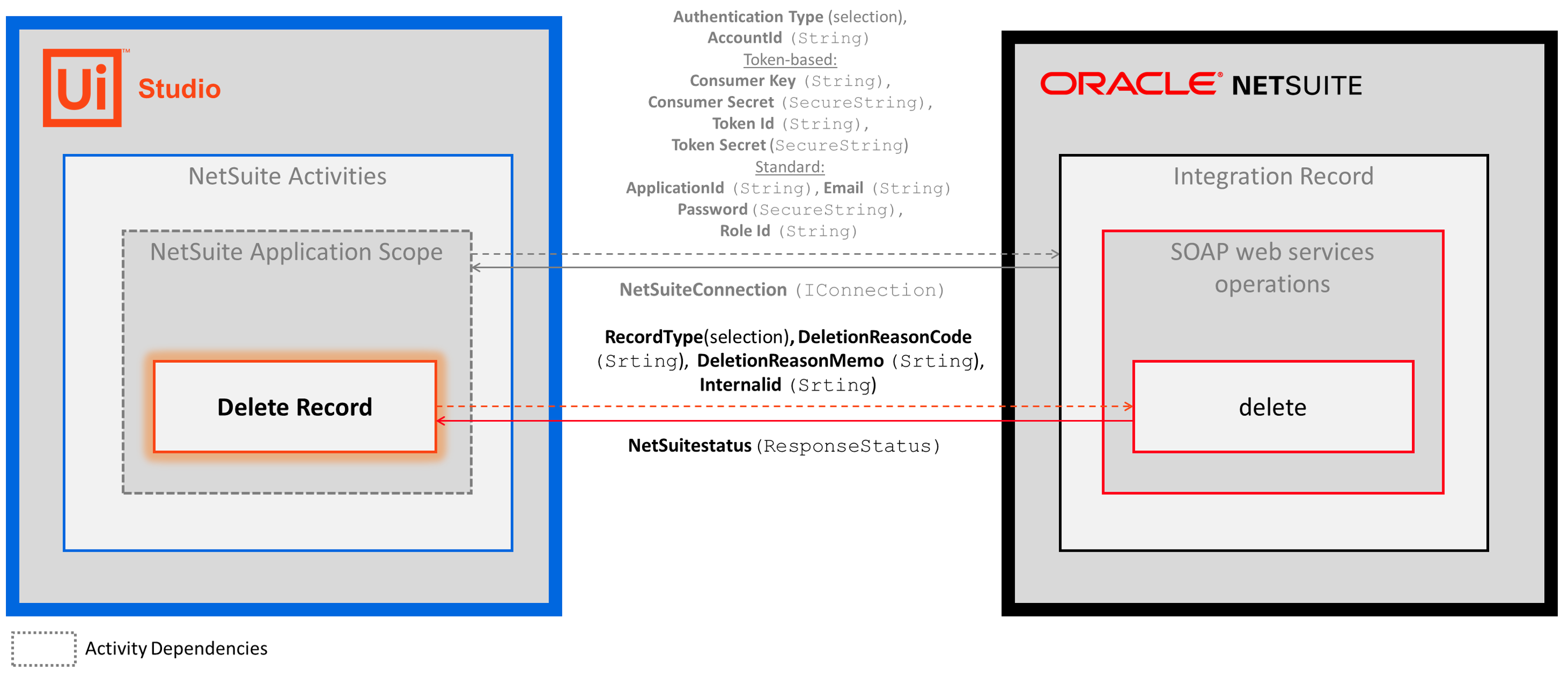

The following steps and message sequence diagram is an example of how the activity works from design time (i.e., the activity dependencies and input/output properties) to run time.

The example image below shows some of the properties that you can return.
Example
The following image shows an example of the activity dependency relationship and input/output property values.
