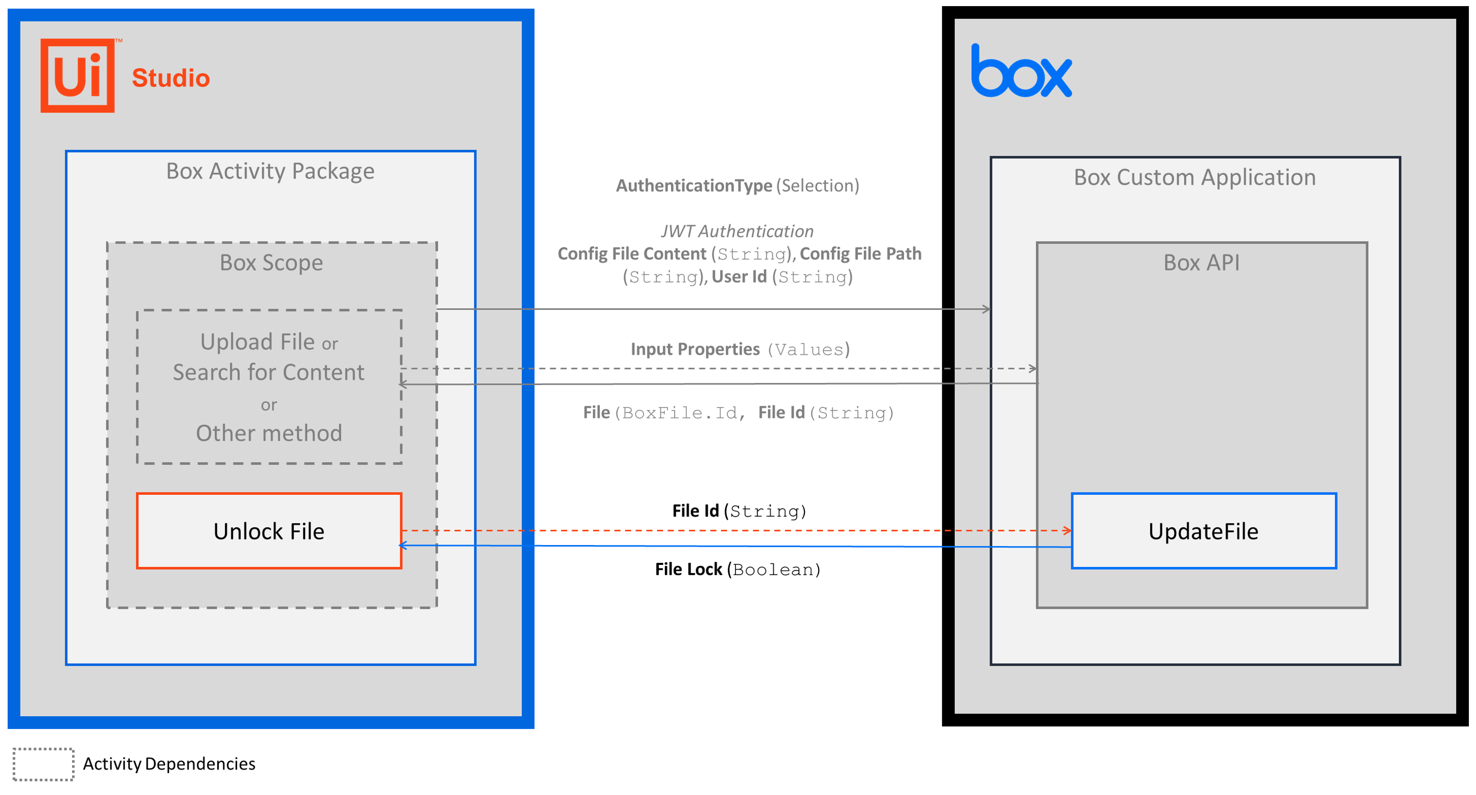

The following steps and message sequence diagram is an example of how the activity works from design time (i.e., the activity dependencies and input/output properties) to run time.
  1. Complete the Setup steps.
  2. Add the Box Scope activity to your project.
  3. Add an activity or run an external process that outputs a File.Id value (e.g., Upload File, Search for Content, etc.).
  4. Add the Unlock File activity inside the Box Scope activity.
  5. Enter a value for the Input property.
  6. Create and enter a Boolean variable for the Output property.
    • Your input property values are sent in the Update file API operation request.
    • The operation returns the Boolean value to your output property variable.
