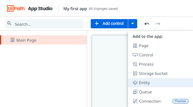

  2. Add the entity created during Prerequisites to your app by clicking the Add any Add Any icon icon from the top of the canvas and selecting Entity.

  2. Add the storage bucket to your app by clicking on the Add any Add Any icon icon from the top of the canvas and selecting Storage bucket.
