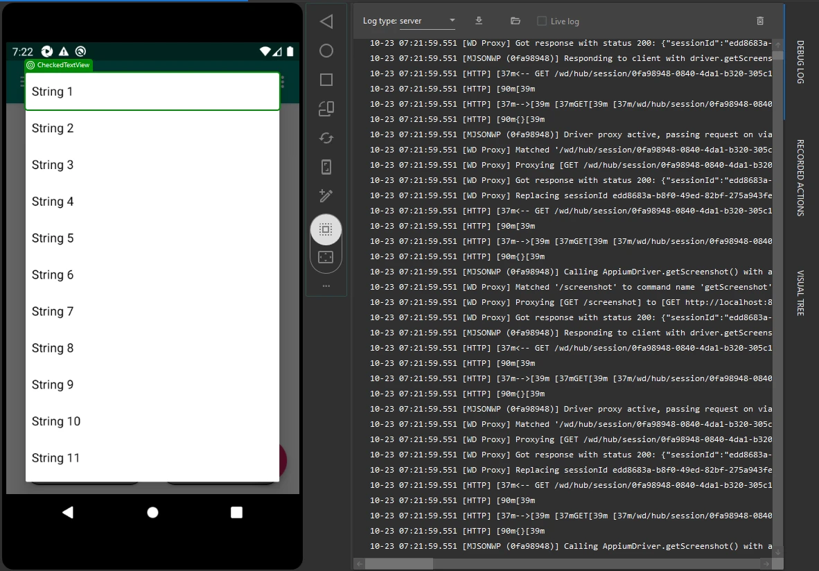

Use the debug tool to dig into the details of your automation, examining the Appium log output. For example, you might be needing to have a look at low-level server logs to understand what has happened during the executed operations. You can then hover your mouse over an event to see full details (e.g. determine when the connection was created, or when the test had started).
To open the debug panel:
  1. Click the Debug Tool button to expand the panel details.
  2. Click Log Type and select an option from the dropdown.
  3. Click Get Logs.
  4. (Optional) Click Live Log to retrieve events in real-time.
    docs image

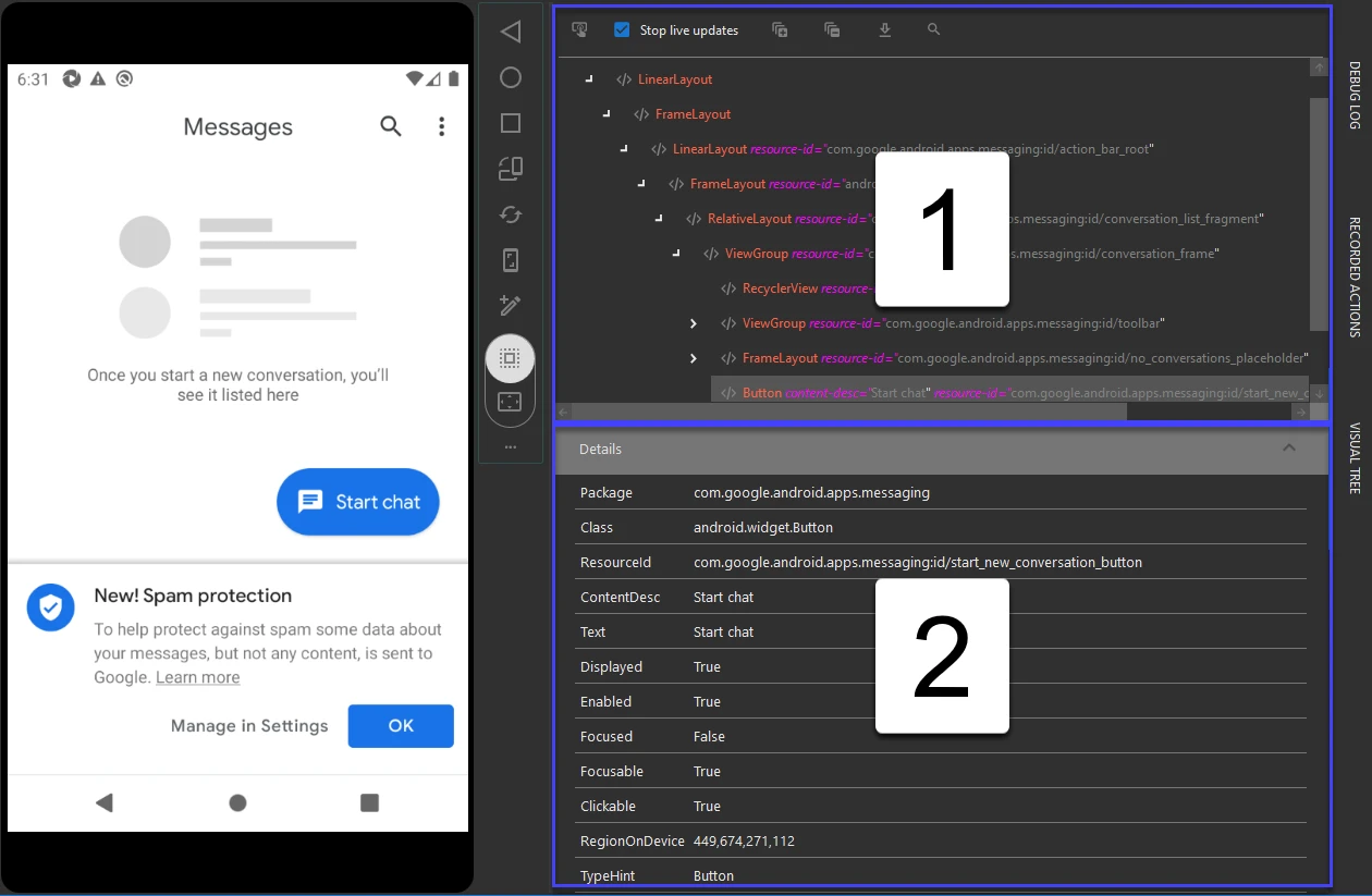

Use the visual tree tool to view how the page looks like or to see elements that can potentially be automated.
To open the visual tree panel:
  1. Start an application in Mobile Device Manager.
  2. Click the Visual Tree button to expand the panel details.
  3. Click Inspect Element and then click any element on your device. The element information is divided into two parts:
  • In the 1st border frame, you can look for the tree structure of your elements. Hover the mouse over an entry to highlight its corresponding element on the device.
  • In the 2nd border frame, you can view element details. The information from this panel changes whenever you use the search function.
    docs image

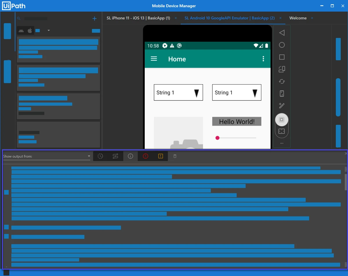

You can open the status panel to glance over events such as connection info, error messages, and statuses. To open the status panel, click the hamburger button at the bottom-right of Mobile Device Manager.
docs image
