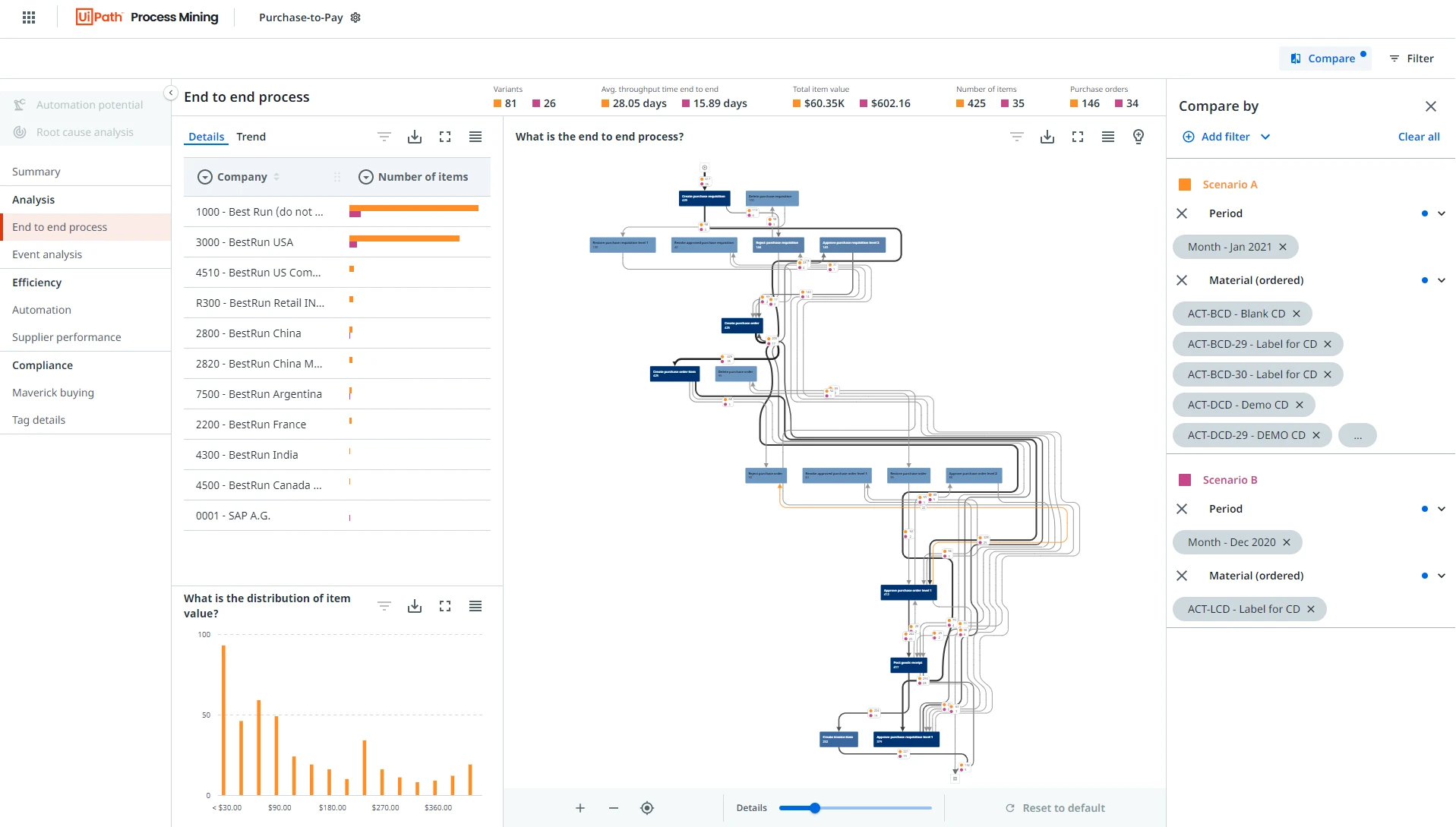

En mode Comparaison , vous pouvez comparer deux ensembles de chemins de votre processus. Cela vous permet de visualiser, de comparer et d'analyser les performances d'un processus et ses variations dans tous les tableaux de bord de votre application de processus.
Affichage du panneau Comparer par

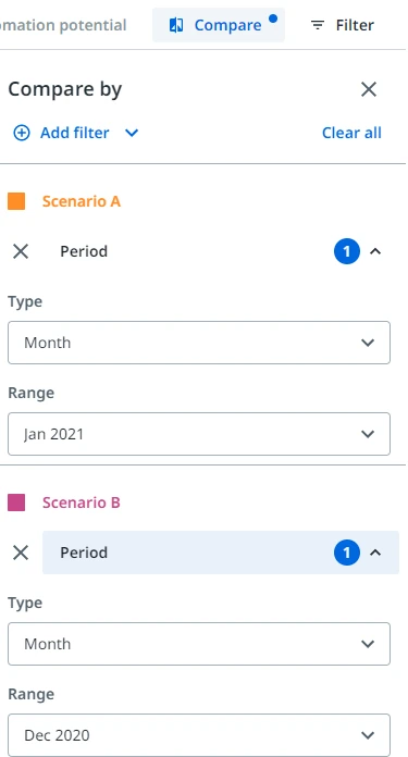

In the Compare by panel you can select which field you want to use for the comparison. Follow this step to display the Compare by panel.
- Cliquer sur le bouton
en coin supérieur du tableau de bord.
The process app is displayed in Compare mode and the Compare by panel is displayed to the right. See the illustration below.
The Compare button is a toggle button. When the Compare by panel is visible, click on the Compare button to hide the Compare by panel.
In Compare mode, the period filter and the Root cause button are disabled.

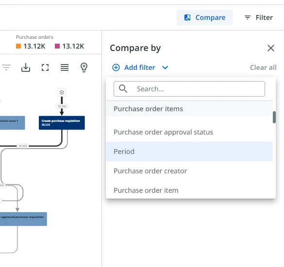

Ajout d’un filtre Comparer par
Suivez les étapes suivantes pour ajouter un filtre Comparer par .
Click on Add filter and select one or more fields for comparison from the drop-down list.
The Compare by panel displays two scenarios: A and B. Scenario A is the main scenario and Scenario B is the comparing scenario. If you have selected a filter, scenario B will automatically be set as the inverse of scenario A. Each scenario has a different color. These colors correspond to the colors of the two scenarios in the dashboard.
Si vous souhaitez comparer des valeurs de champ spécifique, sélectionnez les valeurs souhaitées pour les filtres affichés dans le panneau Comparer par .
Voir illustration ci-dessous.
If you have already specified filters in the Filters panel, these filters will be displayed in the Compare by panel.

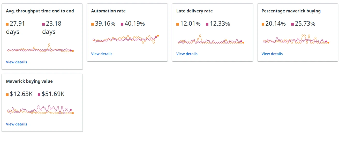

ICP
Both scenarios are displayed for the KPIs in the context bar according to the color legend in the Compare by panel, which enables you to analyze the differences between the two scenarios for the KPIs. The value for Scenario A is displayed on the left and the value for Scenario B is displayed on the right. See the illustration below.
For the larger KPI charts, for example on the Summary dashboards, both scenarios are displayed as trend lines according to the color legend in the Compare by panel, which enables you to analyze the differences between the two scenarios for the KPIs over time. See the illustration below.

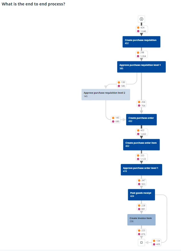

Graphiques de processus
Avec le graphique de processus, il est possible de comparer deux processus différents en fonction de différents champs ou de différentes périodes de temps. Les deux scénarios sont combinés dans le graphique de processus. Voir l'illustration ci-dessous.

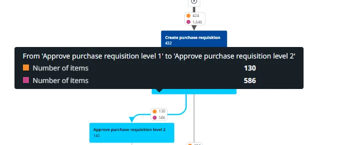

Pour la mesure sélectionnée, les deux scénarios sont visibles sur les bords. Lorsque vous survolez une arête, les informations contextuelles s'affichent. Voir l'illustration ci-dessous.

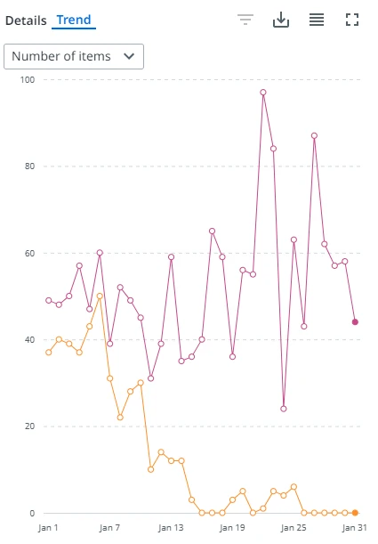

Graphiques en courbes
Dans les graphiques en courbes, chaque scénario est affiché sur une ligne distincte. Voir l'illustration ci-dessous.
