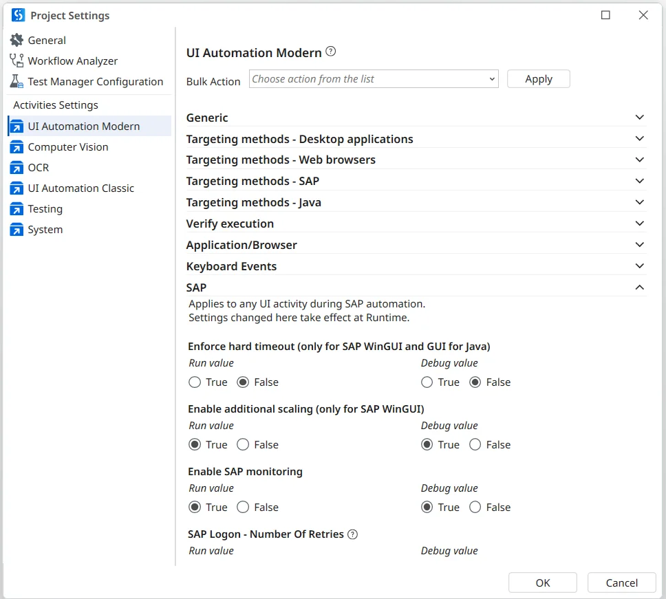

Enable SAP monitoring
Step 5 is a hard requirement — without it, none of your automated tests' SAP components appear in the Heatmap, regardless of how the automation is structured. The setting is available at Project Settings > UI Automation Modern > SAP > Enable SAP monitoring. For guidance on structuring SAP automation projects, see SAP test automation best practices.
