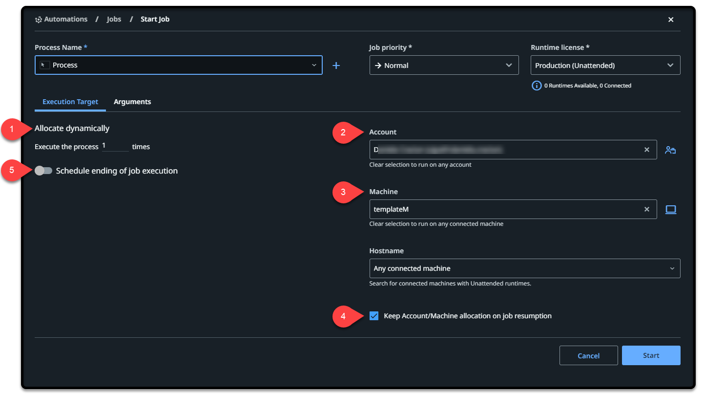

Configure your execution target by setting the options in the Execution Target section of the Start Job page as desired.
Allocate Dynamically
Selecting Dynamic Allocation with no explicit account and machine selection allows you to execute a foreground process multiple times under the account and machine that become available first. Background processes get executed on any account, regardless if it's busy or not, as long as you have sufficient runtimes.
Using this option you can execute a process up to 10000 times in one job.

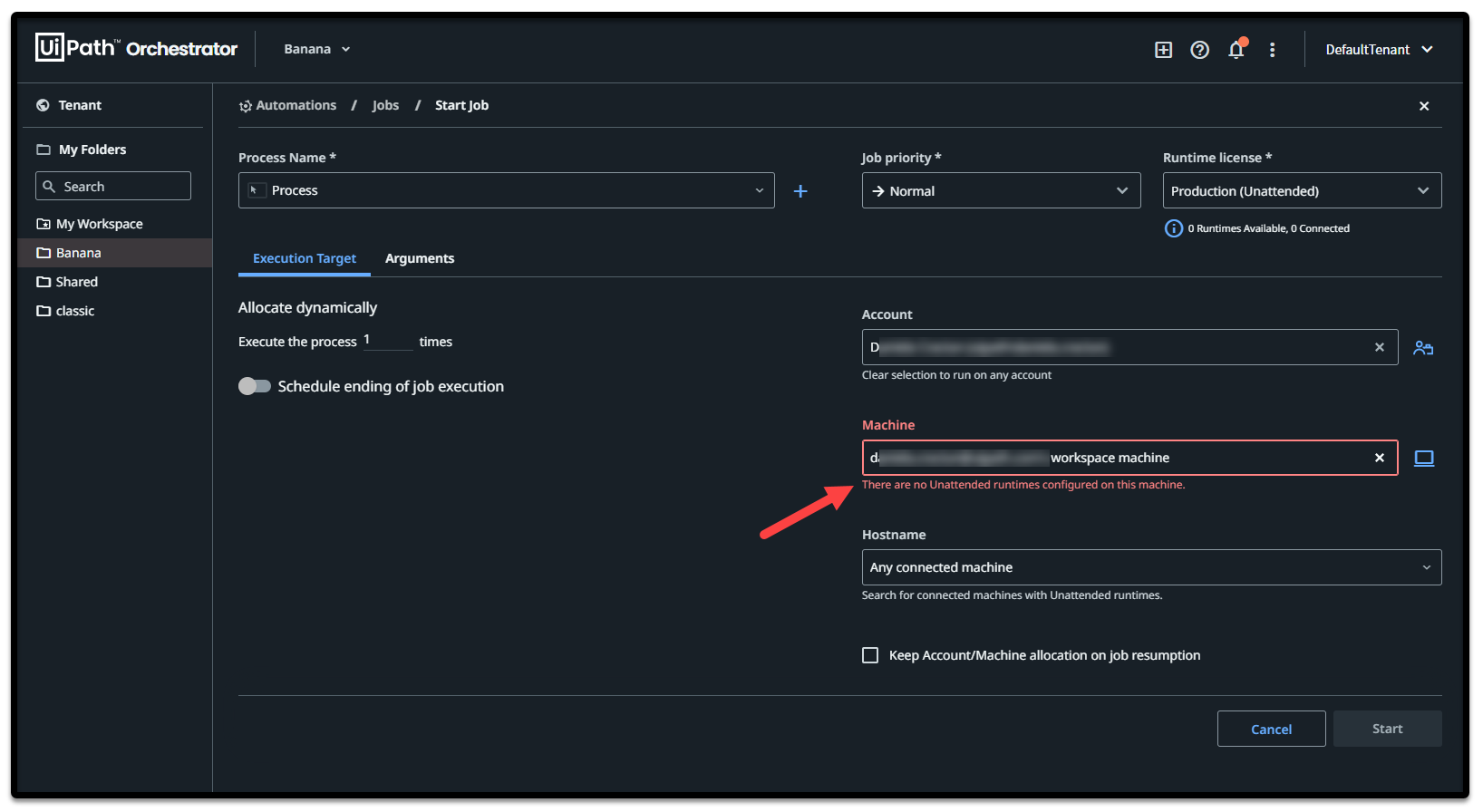

Account
You can choose one of these approaches:
Specifying an account means the process is executed under that specific user or robot account.
Specifying both the account and the machine means the job launches on that specific account-machine pair. Only valid account-machine pairs are available for selection.
Specifying no account results in Orchestrator allocating the account dynamically.
Note:- If you attempt to run a job with no suitable account assigned to the folder, you receive an error message explaining the issue. Also, the Assign an account to the folder button is highlighted. By selecting the button, you can either assign an existing account to the folder or create a new one on the fly, then resume the Start Job workflow.
- If only robot account groups are assigned to a folder, the individual robot accounts within those groups cannot be used to run jobs. To allow a robot account to execute jobs in a folder, the individual Robot account must be explicitly assigned to that folder.
Machine
Specifying a machine object means the process is executed on one of the host machines attached to the selected machine template. Select a specific host machine from the pool of connected host machines in the dropdown.
Specifying no machine results in Orchestrator allocating the host machine dynamically.
Make sure that runtimes matching the job type are allocated to the associated machine template. Only connected host machines associated with the active folder are displayed.
Select valid account - machine mappings
Choose which specific account-machine pair will run the job. You can select Add Account-Machine mapping if you want your job to run on multiple such pairs. If you do so, a Pending job is created for each account-machine pair.
Note:This only works if the Enable user-machine mapping option on the General tab of your tenant settings is selected.
Enable Healing Agent
To receive suggestions and debugging information on how to fix issues that may arise during job execution, turn on the Enable Healing Agent toggle. Additionally, you can allow Healing Agent to independently fix job execution issues by selecting the Enable Healing Agent self-healing option.
For detailed information on Healing Agent and its capabilities, refer to the Healing Agent documentation.
Keep Account/Machine allocation on job resumption
This setting allows you to configure whether the different fragments of a long-running job are executed on the same account-machine pair.
By default, a suspended job is resumed on any available robot on any available machine.
Based on your license or resource requirements, you have the option to resume a job on the same machine and in the same account context that started the job.
Say you need an SAP license to execute a job. Instead of installing an SAP license on every available machine (increased costs), you can install it on a single machine and use that machine to start and resume the job. The same strategy may apply to user licenses. You can allocate only one user license and use it to execute the job.
Schedule ending of job execution

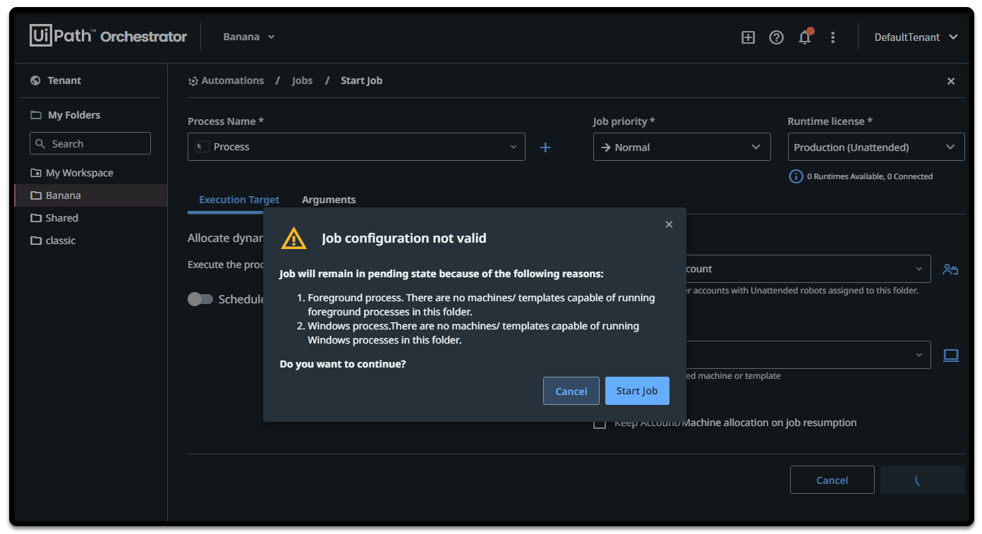

Orchestrator prevents starting jobs on invalid configurations. Trying to start a job in an invalid setup results in a descriptive error message providing you with details about how to fix your configuration.
Starting a job using dynamic allocation, i.e. no machine or account specified, with an incompatible folder setup, results in an error. Make sure to correct the setup, otherwise, jobs stay pending indefinitely.
For example, trying to run a.NET Framework 4.6.1 background job when there are only cross-platform templates in the folder does not work, as jobs stay pending until the configuration is fixed.

Configuring the execution target
Configure your execution target by setting the options as desired in the Execution Target tab of the Start Job page.
The process execution may sometimes be faulty, causing the job to remain in a pending or running state. Turning on the toggle allows you to:
Select Stop from the drop-down menu - this attempts to gracefully end the execution after the defined time interval has passed since the job is stuck in a pending or running state (set the time to a minimum of 1 minute, maximum of 10 days, 23 hours and 59 minutes).
Select Kill from the drop-down menu - this attempts to forcefully end the execution after the defined time interval has passed since the job is stuck in a pending or running state (set the time to a minimum of 1 minute, maximum of 10 days, 23 hours and 59 minutes).
Select Stop from the drop-down menu and turn on the Schedule automatic "Kill", if the job does not stop option - this attempts to gracefully end the execution after the defined time interval has passed since the job is stuck in a pending or running state and then attempts to forcefully end it after the defined time interval has passed since the job is stuck in a stopping state (set the time to a minimum of 1 minute, maximum of 10 days, 23 hours and 59 minutes).
Generate an alert if the job started and has not completed
By turning on the toggle, you activate alerts about jobs that do not complete in the specified duration.
The configurable duration is minimum one minute and maximum eleven days.
If the job exceeds the configured duration, an "Error" severity alert pop-up informs you about it with the following text:
"Job for #process {process_number} has been running for more than X hours and Y minutes.", where:
{process_number} - the process identifier
X - the configured number of hours the job exceeded while trying to complete. Days are converted to hours.
Y - the configured number of minutes the job exceeded while trying to complete.
Account
You can choose one of the following approaches:
