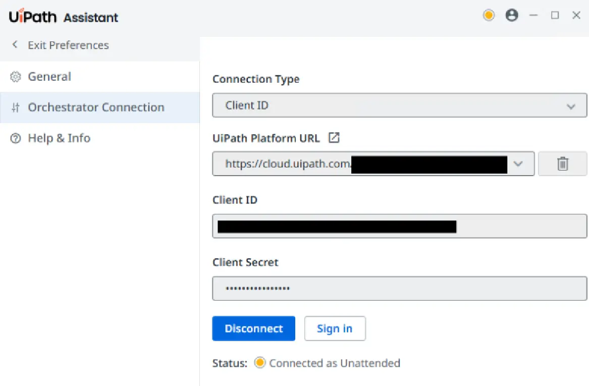

Using the Client Credentials in the Assistant
Use client credentials to connect unattended robots to Orchestrator. The client ID - client secret pair is generated via machine template objects in Orchestrator.
There are two ways to connect your robot with client credentials: using the Assistant or the command line.
- Open the Assistant.
- On the Preferences menu, select Orchestrator settings. The Orchestrator configuration window is displayed.
- For the Connection type field, select Client ID.
- For the Orchestrator URL field, enter the full URL including
AccountLogicalNameandServiceName(for example:https://cloud.uipath.com/uipathtokyo/uipathkyoto/). - For the Client ID field, enter the client ID generated by the machine object in Orchestrator.
- For the Client Secret field, enter the client secret generated by the machine object in Orchestrator.
- Select Connect.
Figure 3. Connecting using Client ID
On a successful connection, Assistant will display a warning dot, followed by the Connected as Unattended message.
The warning is displayed when connected to an active Windows session and you are missing attended capabilities. To enable Attended mode, sign in with your RPA Developer account.
