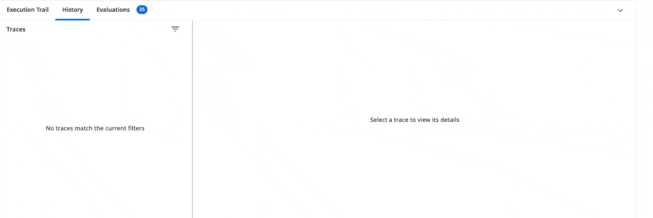

    Starting an agent job​
    Note:
    Feature availability depends on the cloud offering that you use. For details, refer to the Feature availability page.
    Before going through the following steps, you need to create a process.
    1. Navigate to Automations, then Jobs from the folder that the process resides in.
    2. Select Start. The Start Job page is displayed.
    3. From the Process Name drop-down, select a process that has been previously deployed to the current folder. To display only agents in the drop-down, use the Filter types filter and select Agent.
    4. Configure the required fields, as outlined in the sections below.
    5. Select Start.
    Result: The Start Job page closes and the job starts according to the settings you made. The State of the job is displayed in real-time on the Jobs page.
    Selecting the execution runtime
    From the Runtime type drop-down, choose Cloud - Serverless to run the agent on a UiPath-hosted robot, or Local to run it on one of your own connected unattended robots. The available and connected runtime counts shown below the drop-down reflect the Agent capacity configured on machine templates in the active folder. Function and API processes use the same drop-down, but draw from Function capacity instead.
    For details on configuring and licensing local execution, see Agents and Functions on Local Robots.

    Viewing job traces​
    Note:
    For agent and Maestro BPMN process jobs, the job details panel includes a Trace tab. The trace provides a comprehensive, hierarchical view of the job run, its input and output, as well as any other resources invoked or jobs executed in connection with the run. The trace view also allows you to provide positive or negative feedback, as well as comments, on any of the trace items.
    In the trace view, when you toggle the Display raw data option, you can collapse or expand a section by using keyboard shortcuts:
    • To collapse a section, use the Ctrl + Shift + [ shortcut on a Windows or Linux computer, or the Cmd + Option + [ shortcut on a macOS computer.
    • To expand a section, use the Ctrl + Shift + ] shortcut on a Windows or Linux computer, or the Cmd + Option + ] shortcut on a macOS computer.
      For agent jobs, feedback added in the Trace view is automatically available in the Agents Evaluations panel during design time, allowing you to create evaluations from job runs, edit them, and refine your agent based on manually entered feedback. Read more about Evaluations.
      Figure 3. Agent runtime traces
