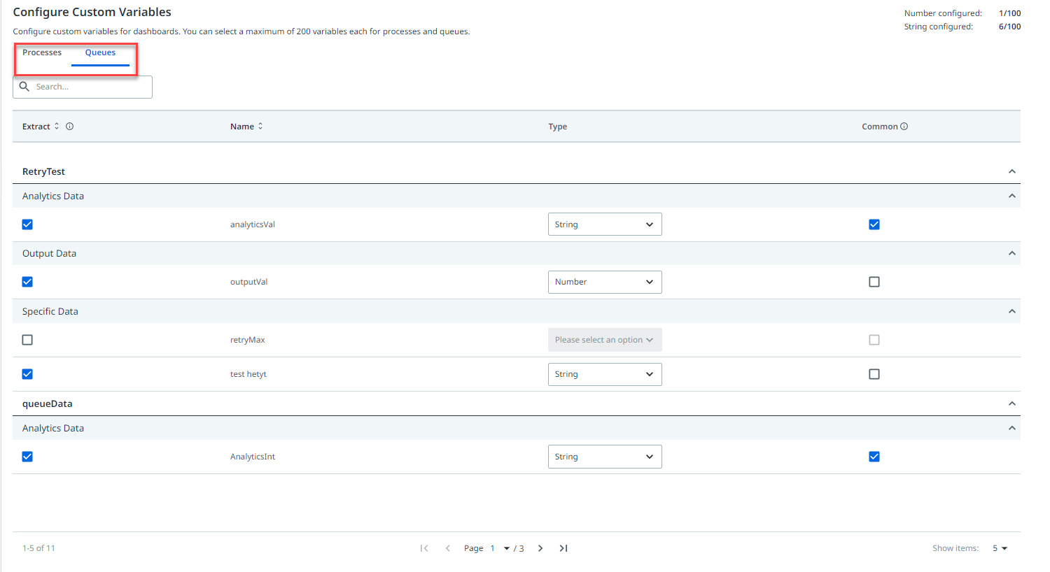

Configuring custom variables
To configure custom variables, an Admin must take the following steps:
  1. Open the 3-dot menu in the top-right corner of any Insights page, and select Configure Custom Variables. The configuration page opens, listing all custom fields that are available for extraction.
  2. Decide whether you want to configure custom variables for processes or queues by clicking the corresponding tab at the top of the configuration page.
    Note: Check the limits of the custom variables highlighted in the top right corner. If you are approaching the limit, consider making more custom variables as common so that they can be used across all processes or queues.
  3. In the Extract column, choose the custom variables that you would like to use when building dashboards.
  4. In the Type column, select the custom variable type. You can choose String,Number, or DateTime.
    Important:
    • The fields are limited to 40 characters and any characters after this number will be cut. To add more than 40 characters, change the Insights.Etl.Json.MaxStringLen flag. You can add this flag in the Orchestrator web configuration and set the value according to your project's needs. For example:
    <add key="Insights.Etl.Json.MaxStringLen" value="60" />
    • The backfill percentage shows the progress of extracting a custom variable from all processes or queues. You will need to refresh the page to see the latest backfill percentage. This might take some time depending on the data size. Custom variable values will backfill from newest data to oldest. The field will be available for use shortly after the configuration is saved, you will not need to wait until it is 100% backfilled.
    • You can extract variables from a maximum of 235 processes or queues per tenant, and a maximum of 235 variables per process or queue.
    • If you configure the Type of a custom variable to Number make sure that it doesn't contain a , or other non-numeric characters such as $ as these characters are not supported. For numbers with special characters, please select type String.
    • Every change in the configuration of custom variables will cause a full new backfill for that specific process. The time of the backfill depends on the number of logs stored in the Insights database for that specific process.
  5. Save the configuration. All extracted variables for a specific Process should appear in an explore named *Process - ProcessName, and all extracted variables for a specific Queue should appear in an explore named *Queue- QueueName.
    Important: You can extract variables from a maximum of 235 processes or queues per tenant, and a maximum of 235 variables per process or queue.

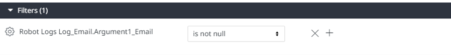

Scenario 1
If you use a field from the standard data model in a visualization paired with a process-specific custom variable field, and a process does not contain the custom variable in the robot logs, the value of all fields associated with the process that does not contain the custom variable in its robot logs is null.
There are two ways to eliminate the null values for this scenario:
Option 1: Add the custom variable as a filter, and set the condition to is not null to remove the null values from the visualization.
Option 2: Set a filter for the process name that does include the custom variable. Note, however, that if you adopt this approach, you may run into the second scenario below.
Scenario 2
If a custom variable is not present in all logs generated by a process, the logs that do not contain a value for that custom variable will show the variable's value as null.
The following example illustrates this particular case.
  1. Go to Configure Custom Variables. You can see that the Argument1_Email custom variable field only occurs in the Log_Email process. Considering that Argument1_Email is a process-specific custom variable field, keep Common unselected.
  2. Open a new or existing dashboard and add a tile.
  3. Navigate to the Robot Logs explore. Select the Process Name field and the custom variable field. In this case, the custom variable field is Log_Email.Argument1_Email.
  4. Click Run. The results you see should be similar to the ones shown in the following screenshot.
To eliminate the null values, add the custom variable field as a filter. Lastly, set the condition to is not null, so that you can remove the null values from the visualization.
Note: Both of these cases occur when you are viewing the custom field’s raw data. When you apply a function (Sum, Average, etc.) to the custom variables, you exclude null values.
