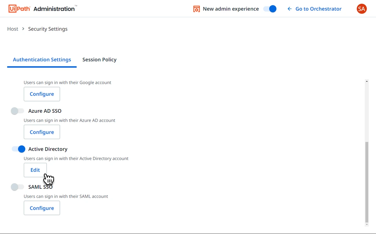

手順 3: Orchestrator を構成する​
  1. Log in to the Management portal as a system administrator.
  2. Go to Security and make sure you're on the Authentication Settings tab.
  3. Enable the Active Directory option and select Edit to configure it.
    The AD SSO configuration window opens.
