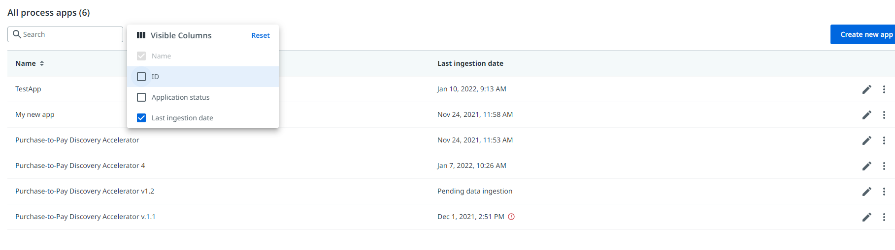

Selecting display columns
By default, Name, Applications status, Status changed, and Last successful run are displayed for the process apps listed. Follow these steps to change the visible columns.
StepAction
1
Select Columns to display the list of columns.
2
Select the columns you want to display in the Process apps in development list.
Note: The Name column cannot be hidden.
See the illustration below.
Note: You can click on Reset to reset the visible columns to the default selection.
