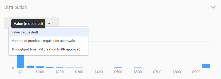

Distribution
The Distribution chart enables you to analyze the frequency of purchase requisitions based on the Value (requested), the Number of purchase requisition approvals, or the Throughput time (PR creation to PR approval). See the illustration below.
