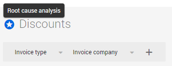

Root cause analysis
The Analysis - Root cause analysis enables you to analyze suppliers with late delivery rates in more detail. When you click on the imageimage in the header of the Discounts dashboard item the Analysis - Root cause analysis dashboard will be displayed with a predefined filter to analyze Discount lost.
See the illustration below.
352352
When you click on the imageimage icon in the What influences the selection? dashboard item in the Root cause analysis dashboard, you will return to the Efficiency - On-time payment dashboard.
