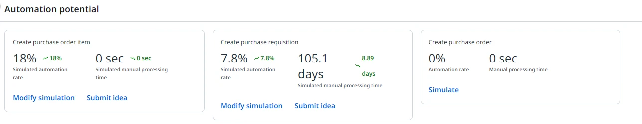

The Automation potential charts highlight the simulated activities with the highest simulated automation rate.
If there are no (more) simulated activities, activities with the lowest activity rate are displayed. These activities are selected as the activities that are candidates for automation based on their automation potential.
For each activity, the Automation rate, and the Manual processing time are displayed. See the illustration below.
The Simulate button on a KPI chart enables you to start an automation potential simulation for the activity, whereas the Modify simulation button enables you to modify the parameter values for the existing simulation.

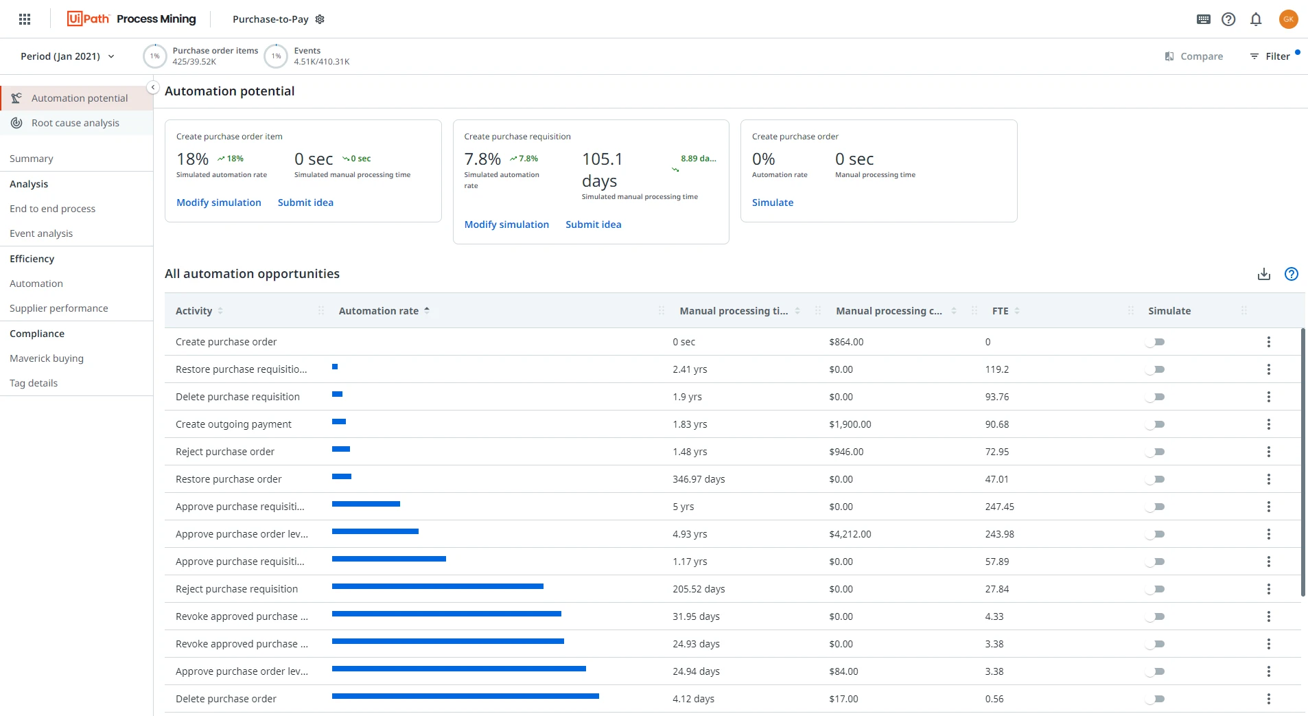

All automation opportunities
The All automation opportunities chart displays the activities based on the current Automation rate, which is determined by the percentage of events that are automated. The activities with the lowest automation rate are displayed first. See the illustration below.
Below is a description of the elements.
| Element | Description |
Activity |
The name of the activity. |
Automation rate |
The percentage of events that are automated. |
Manual processing time |
The total amount of time that is actually spent working on the events. |
FTE |
The total time that is needed to perform the work for events. FTE is calculated by dividing the manual processing time in hours by the number of working hours. The number of working hours is calculated from the number of working days in the selected period * 8 working hours per day. |
Simulate |
A toggle button that displays the results of the simulation. If you have not performed a simulation for the action, the Modify simulation panel is displayed, where you can enter different values to use for calculating the automation potential. |
Enables you to open a context menu with the following options: • Modify simulation: displays the Modify simulation panel where you can enter different values to use for calculating the automation potential. • Send to Automation Hub: displays the Send to Automation Hub form, which enables you to submit an idea for automation. See Sending automation ideas to UiPath Automation Hub. |

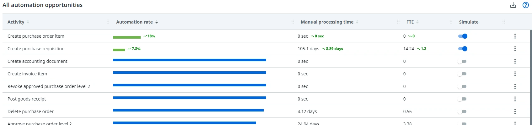

Enter a percentage value to indicate how much of the input is digital input in the % of digital input field.
The % of digital input is a mandatory field.
Select a percentage range from the % of structured digital data input drop-down list to indicate how much of the digital input is structured.
Select the applicable option from the Number of ways to complete the process drop-down list to indicate the number of ways possible to complete the activity.
Click on Save.
The impact on the automation rate, the manual processing time, and the FTE for the activity is displayed in the Automation potential dashboard. Next to the current Automation rate, the Automation rate calculated from the simulation is displayed, as well as the difference percentage. For the Manual processing time and the FTE the difference between the current value and the simulated value is displayed. See the illustration below.
The automation simulations are saved. When you reopen the Automation potential dashboard, all active simulations are displayed.
