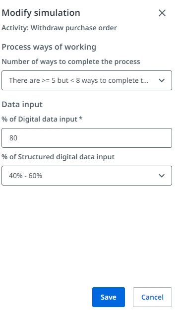

Displaying the Modify simulation panel
Follow these steps to display the Modify simulation panel.
- Select Automation potential in the menu on the left of the dashboard.
- Locate the activity for which you want to perform a simulation.
- Select
in the Actions column of the activity, and select Modify simulation from the context menu.
The Modify simulation form is displayed to the right.
You can also click on the Simulate or Modify simulation button on an activity in the Automation potential chart, to display the Modify simulation panel.
Simulation Parameters
This simulation parameters are used to determine how much of the activity can be successfully automated. Below is an overview of the parameters that can be set to perform an automation potential simulation.
| Parameter | Description |
| % of digital input | A percentage value that indicates how much of the input is digital. |
| % of structured digital input | A percentage range that indicates how much of the digital input is structured. |
| Number of ways to complete the process | The number of different variations possible in which the process or activity can be completed. |
If all the input data is structured and digital and if there is only one way to complete the process, then the process is 100% automatable. If the Automation potential is 90%, this indicates that 90% of the activity or process can be automated.
For a detailed description on how these parameters are used to perform an automation potential simulation see the Automation Potential section on the Detailed Assessment Algorithm page.
Performing an Automation Potential Simulation
Follow these steps to perform an automation potential simulation to calculate the automation potential.
Enter a percentage value to indicate how much of the input is digital input in the % of digital input field.
The % of digital input is a mandatory field.
Select a percentage range from the % of structured digital data input drop-down list to indicate how much of the digital input is structured.
Select the applicable option from the Number of ways to complete the process drop-down list to indicate the number of ways possible to complete the activity.
Click on Save.
The impact on the automation rate, the manual processing time, and the FTE for the activity is displayed in the Automation potential dashboard. Next to the current Automation rate, the Automation rate calculated from the simulation is displayed, as well as the difference percentage. For the Manual processing time and the FTE the difference between the current value and the simulated value is displayed. See the illustration below.
The automation simulations are saved. When you reopen the Automation potential dashboard, all active simulations are displayed.
