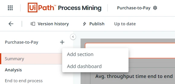

Follow these steps to add a new empty dashboard to the menu.
  1. Click on docs image next to the process app name.
  2. Select Add dashboard from the context menu. See the illustration below.
    A new dashboard labeled New dashboard is added to the menu. See the illustration below.

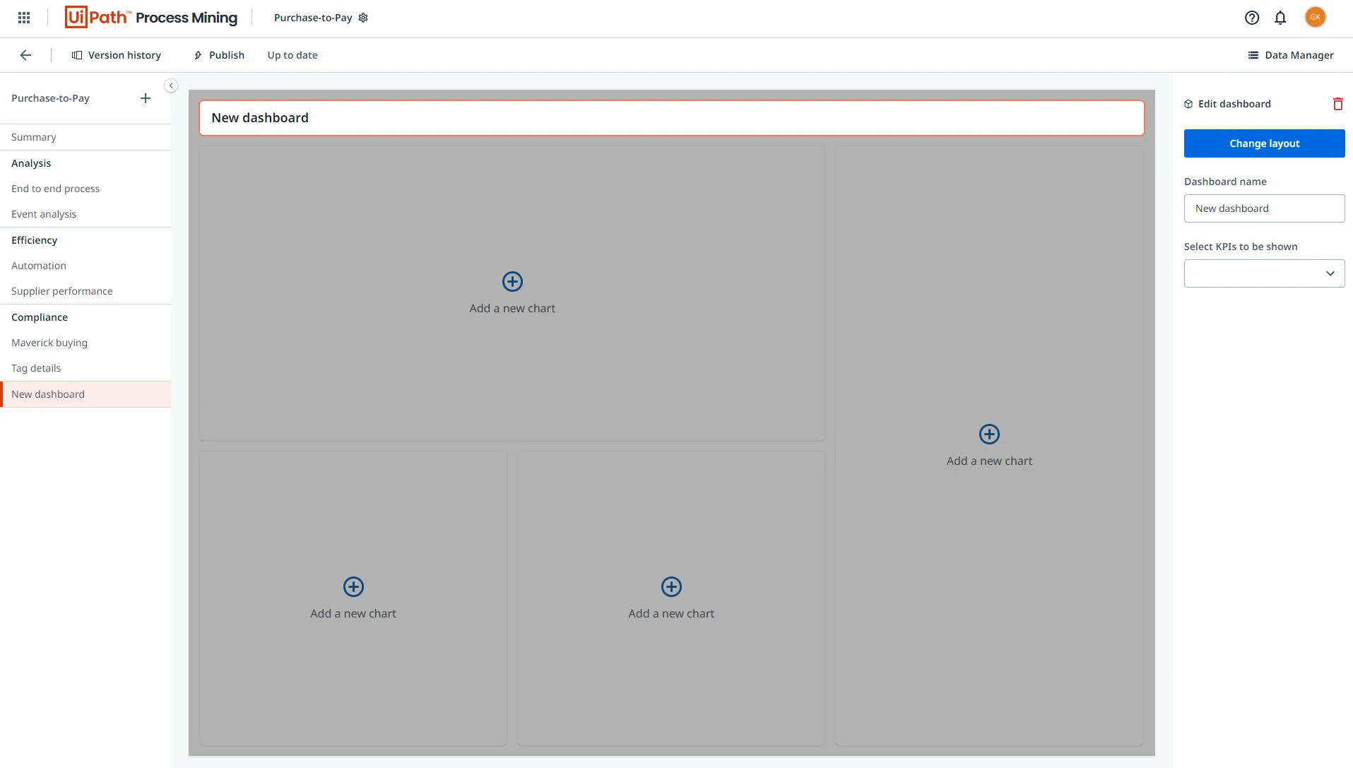

  3. In the Select a layout panel, select a layout for your dashboard.
When you select a layout for your dashboard, empty tiles are created based on the selected layout. See the illustration below for an example.
  1. Enter a name for the new dashboard in the Dashboard name field.
  2. Select the KPIs you want to be displayed at the top of the new dashboard. See also Dashboards.
  3. Add the charts to the dashboards. See also Charts.
