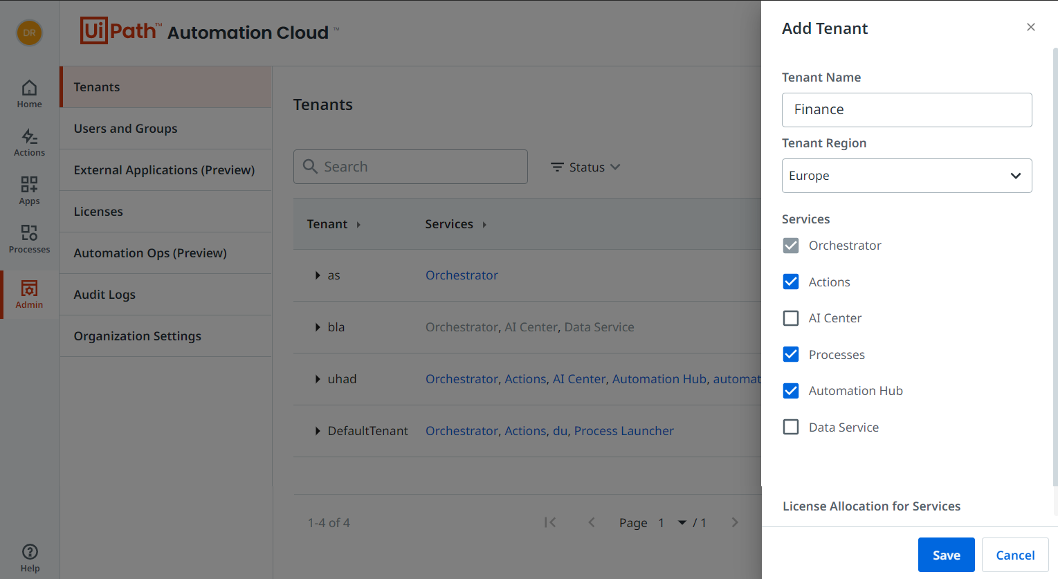

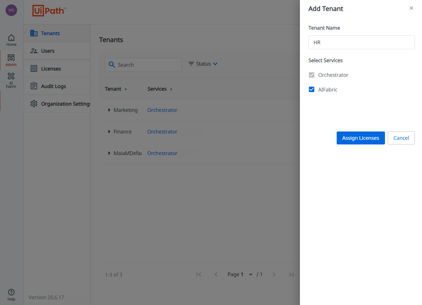

To create a new tenant, take the following steps:
  1. Navigate to Admin in the Automation Cloud portal.
  2. In the Tenants view, select the Plus icon. The Create new tenant process starts with three steps to follow.
  3. On the General step, provide the following information:
    1. Enter a name for your tenant in the Name field.
      You can enter up to 32 alphabetical or numeric characters, starting with a letter. No spaces or special characters are allowed.
      Important:
      You can change the tenant name later, but there are consequences. Refer to Changing the tenant name.
    2. (Optional) Select a color from the Color picker to identify your tenant in the header when operating within that tenant.
    3. Select a tenant type from the Environment type section.
      Environment type is a categorization label for organizational purposes. It does not currently affect service behavior, feature availability, or update rollout. Select the type that matches your tenant's intended use (Production, Staging, or Development) for easier identification.
      You can choose from three types of environments:
      • Production tenants allow the latest versions of software, products, or updates to be pushed to users live.
      • Development tenants are used for development purposes without impacting live or operational tenants.
      • Staging tenants are used for testing purposes without impacting live or operational tenants, including canary environments.
        Note:
        If you want to independently run and test automations with the latest features, select Use as a canary environment. For more information, refer to Using a canary environment. If you already have a canary environment, even if it is currently disabled, you cannot select the checkbox to create another canary environment.
  4. From the Region dropdown, choose the region for hosting your service data for your tenant.
    Important:
    You cannot change the tenant region yourself after you create the tenant. If you need to change it later, you have to open a support ticket. When a tenant and associated data are moved to a new region, the tenant ID and folder ID are changed. You have to update your projects with the new tenant and folder IDs.
  5. Select Next to proceed to the Add services step.
  6. On the Add services step, select the checkboxes for the services that you want to make available within your new tenant.
    The Orchestrator service is mandatory. Other services are only available if you have free licenses for them.
    Note:
    Services available in regions different from the chosen tenant region are labeled accordingly with the region in which they are hosted. For more information, refer to Data residency.
  7. Select Next to proceed to the License allocation step.
    On the License allocation step, you can observe the available number of licenses for each type that you can allocate to your new tenant. If you want to keep some of the available licenses for other tenants, you can allocate a lower number of licenses to your new tenant from each of the available license types.
  8. Select Create to close the wizard and create the tenant.
The new tenant is added to the Tenants panel and the tenant picker.

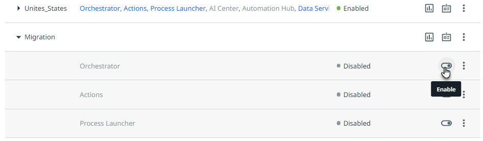

Enabling or disabling a tenant​
Disabled tenants remain visible to organization administrators in the Tenants panel of the Admin page, but the tenant and its services are no longer available to users. Also, the licenses that were allocated to the tenant are released and returned to the organization's pool of licenses.
All data for the services is kept. You can later enable the tenant to access its services again.
  1. Go to Admin and select the tenant in the panel on the left.
  2. Select Settings.
    The Settings page for the selected tenant opens.
  3. Under Disable Tenant, select Enable or Disable, depending on the current state of the tenant.
    A warning dialog opens.
  4. In the dialog, select Enable or Disable to proceed.
A loading icon is shown next to the tenant in the Tenants panel on the left while the change is being processed.
After the icon disappears:
  • If you disabled the tenant, Disabled appears to its right and the tenant and its services are no longer available to users.
  • If you enabled the tenant, it is now restored as it was before being disabled. All licenses that it used before are also re-allocated if they were available in the organization pool. The tenant and its services are now available for use.

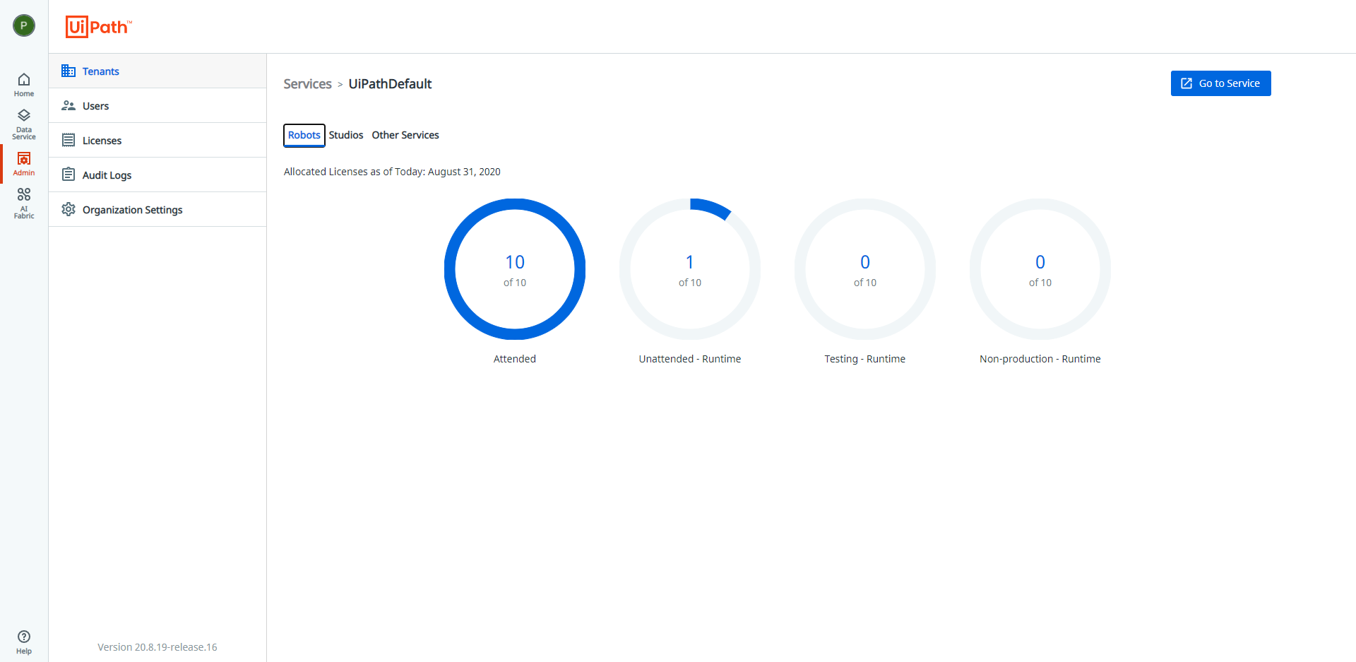

In Admin > Tenant > Licenses, you can view information about the licenses currently allocated to each tenant.
To change the license quantities, select Edit allocation in the top right corner.
For more information, refer to Allocating licenses to tenants.
