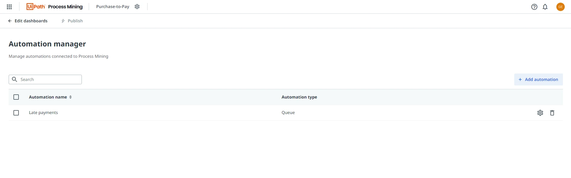

Opening Automation manager
Click on the Automation manager button in the upper right corner of the dashboard editor to open Automation Manager. The Automation manager page is displayed, showing the automations defined for your process app. See the illustration below.

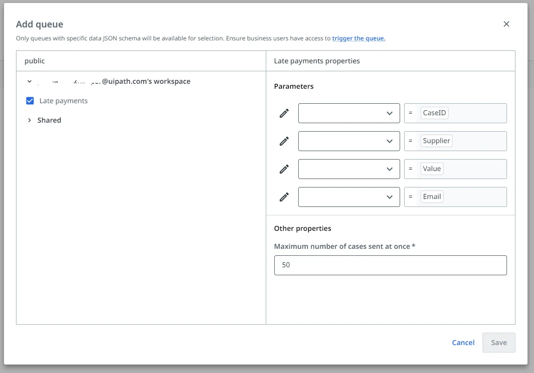

Adding an automation
Follow these steps to add an automation for your process app.
  1. In Automation manager, click + Add automation. The Add queue page is displayed, showing all Orchestrator queues that have Specific data JSON schema. See also Setting up Automation integration.
  2. Select the queue you want to use for the automation. The required input fields for the queue are displayed in the Properties panel. See the illustration below.
  3. Map the queue input fields to the appropriate data fields of your process app.
    Important:
    Check out the data type of the queue input fields defined in the Specific data JSON schema and make sure to map the input fields to a Process Mining data field with the correct input type. See App Templates.
    Instead of mapping to a specific data field, you can select the Custom text option for a text input field. This enables business users to enter a free text when triggering an automation. For example a description or an email address.
  4. Click Save.

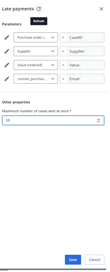

Editing an automation
Follow these steps to edit an automation.
  1. In Automation manager, locate the automation you want to edit on the list of automations and select Edit settings icon .
  2. Change the input field mappings if desired.
  3. Edit the Maximum number of cases sent at once if desired.
    Note:
    By default, the maximum number of cases that can be sent at once from an automation is 50, but you can change the number. The maximum number of cases can be set to a number between 1 and 1000.
  4. Select Save.
Refreshing the queue
Important:
If any changes are made to the Orchestrator queue, you need to refresh the queue in Process Mining. For example, when the Specific data JSON schema has changed, or when the name or description of the queue was edited in Orchestrator. To refresh the queue in Process Mining, you edit the automation in Automation manager.
Follow these steps to refresh the queue for an automation.
  1. Locate the automation for which you want to refresh the queue and select Edit settings icon .
  2. Select the Refresh button at the top of the properties panel. See the illustration below.
  3. Select Save.
