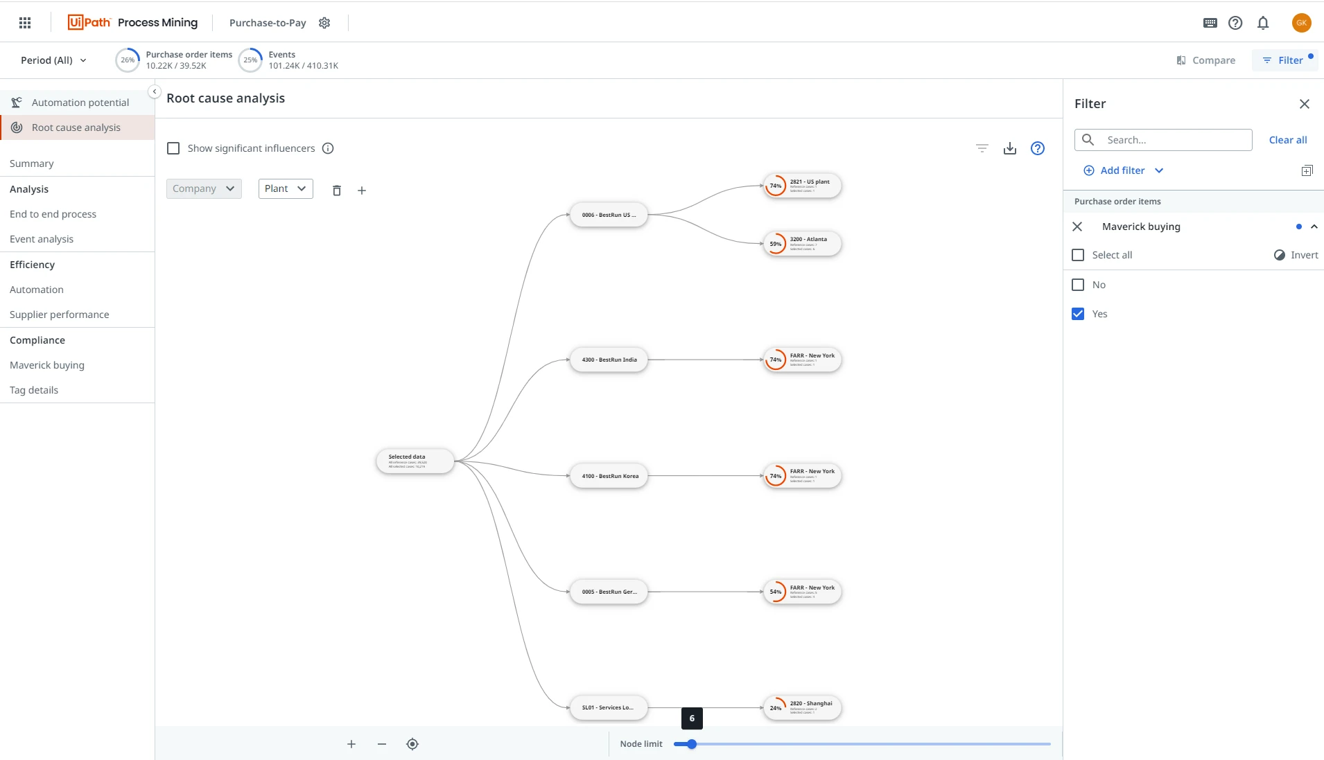

Use the Filters panel to create filters that define the set of Selected cases, which are the cases you want to analyze the influence on. |
4 |
Select the field you want to use for your analysis from the selector. |
See the illustration below for an example.

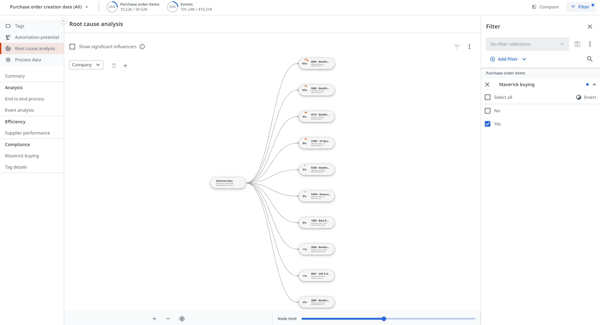

Up to 1000 results are visible. When there is too much data, a warning icon is displayed.
Node limit slider
The Node limit slider enables you to reduce the complexity of the Root Cause Analysis tree, which increases the readability of the graph. By default, the detail of the Root Cause Analysis is automatically determined. You can use the Node limit slider to change the number of nodes shown.

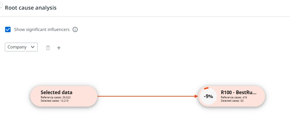

The Root cause analysis tree displays the Influence (%), the number of occurrences in the Selected cases, and the number of occurrences in the Reference cases for the field selected in the dashboard. A large deviation from the Reference cases indicates a possible high influence on the selection.
The above example shows that Maverick buying for example occurs in less in the 2820 - BestRun China Mat.Ledger company (-18%) than in other companies in the reference data, and that Maverick buying occurs more in the 5000 - BestRun Japan 5000 company (10%) than in other companies in the reference data.
Show significant influencers option
The Show significant influencers option enables you to zoom in by displaying the cases with a statistical significant influence. This should help you identify the cases that have the most impact on the selection. This statistical significance is computed from both the Influence (%) and the amount of cases a certain field has.

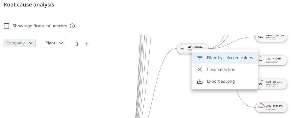

Adding Layers
If desired, you can add more layers to the Root cause analysis. See the illustration below.

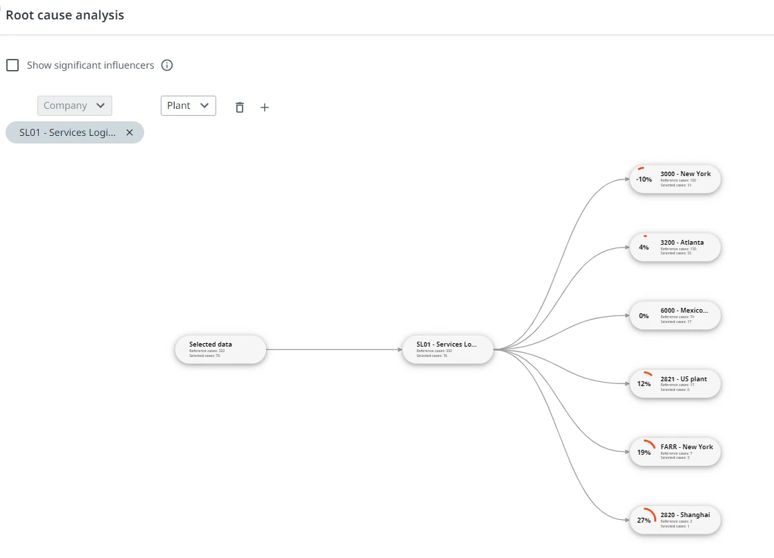

In the above example, the combination of fields results in a set of Selected cases that has not enough (relevant) data to determine influencers. In this case, you can narrow down the set of Reference cases by adding a filter on the dashboard. See the illustration below.
See the illustration below for the result.
