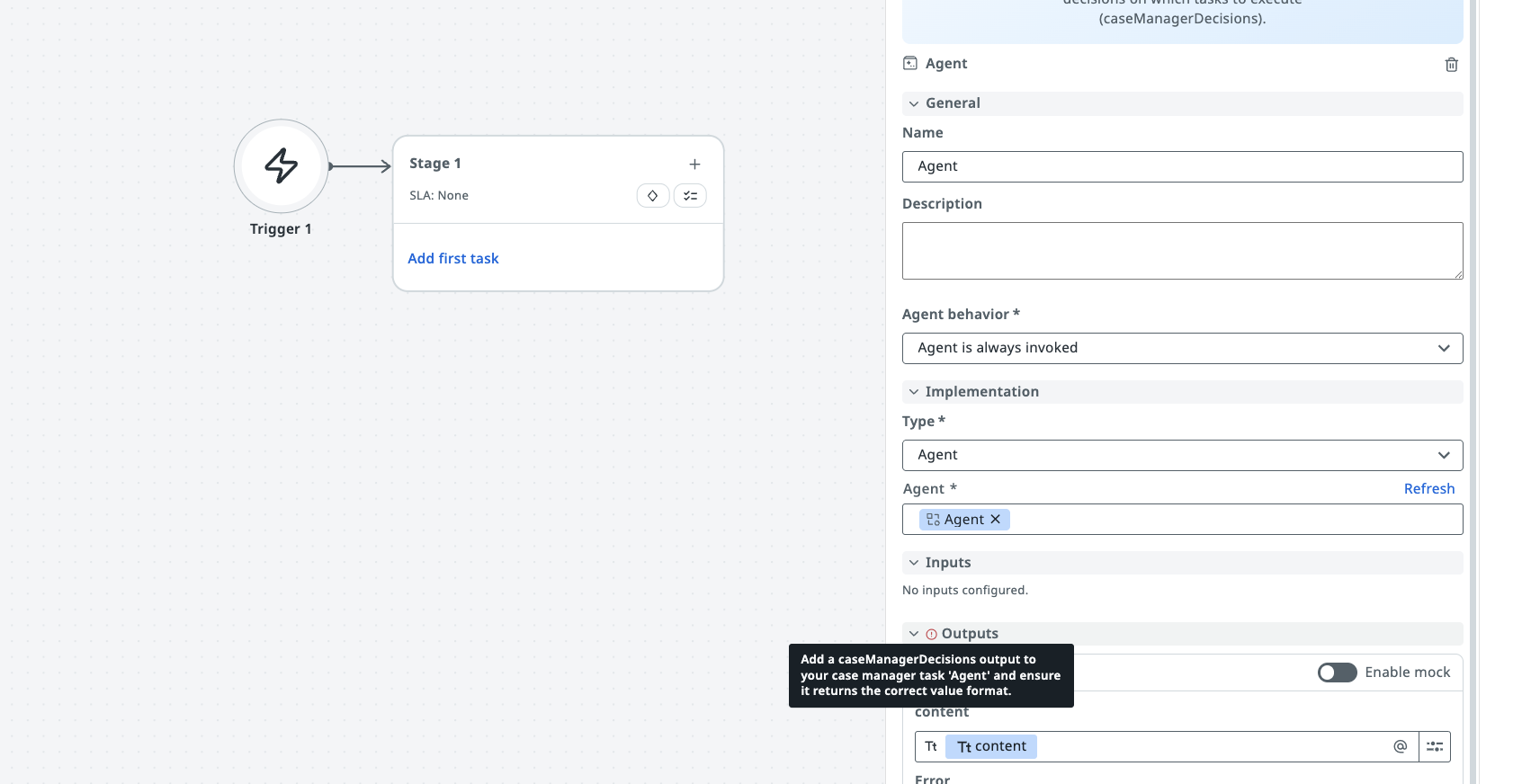

Step 2: configuring input mapping for a task
Input mapping selects specific Case Entity fields and passes them as parameters to the task implementation (workflow, form, connector, or agent). This controls what data the task can see.
Opening the task configuration panel
- In the Case Plan designer, select the target stage.
- Select the task you want to configure.
- Open the Input/Output section of the task configuration panel.
Mapping case entity fields to task parameters
- In the Input section, select Add input mapping.
- For each task parameter, choose the corresponding Case Entity field from the field picker.
- Repeat for every parameter the task requires.

Step 3: configuring output mapping (write-back) for a task
Output mapping takes the task's result and writes specific values back to the Case Entity [Coming Soon] . This is the write-back mechanism that enriches the central source of truth.
Defining output field mappings
- In the same Input/Output section of the task configuration panel, locate the Output section.
- Select Add output mapping.
- For each result field the task produces, choose the target Case Entity field.
For example, a "Validate Receipts" task might use the following output mapping:
| Case Entity Field | Task Output Field |
caseEntity.validationResult | taskOutput.validationResult |
caseEntity.validationStatus | taskOutput.status |
caseEntity.invalidReceipts | taskOutput.failedItems |

| Agentic Case Manager run succeeds, but no tasks trigger | The agent's output does not match the required caseManagerDecisions.tasksToRun shape (for example, a plain array of task names) | Match the exact contract in Case Manager input and output contract. |
This warning appears on the Outputs section of the Case Manager Agent task properties when caseManagerDecisions is missing or does not return the correct value format. See Case Manager input and output contract for the exact shape to use.
