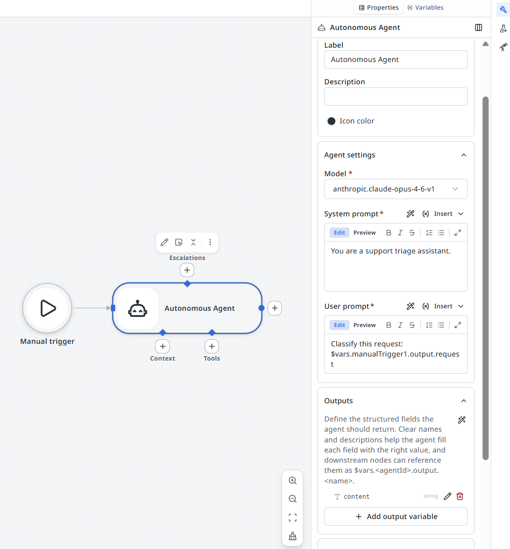

2. Add an Agent node
The agent's palette label is Autonomous Agent.
- Drag an Agent node from the UiPath nodes section of the node panel onto the canvas.
- Connect it to the Manual Trigger.
- In the properties panel, author the agent:
- Set the Model, or leave it on your organization's default agent model.
- Write the System prompt, the agent's role and standing instructions. The Model, System prompt, and User prompt are all required.
- Write the User prompt, the task for this run. Reference flow data with expressions; for example, the document text to classify:
$vars.start.output.documentText.
3. Return a structured result
By default the agent returns one field, content, holding its response text. To branch cleanly, have the agent return a structured field instead.
- Open the Outputs section on the agent's properties panel (Parameters tab).
- Add an output variable named
decisionwith typestring. - In the System prompt, instruct the agent to set
decisiontoapprovedorrejected.
