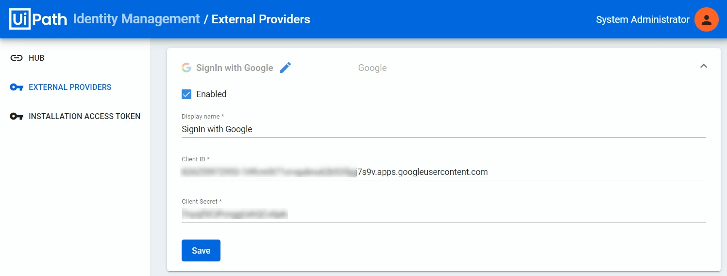

Google OpenID Connect
Esta sección te permite establecer los parámetros que permiten que Orchestrator/Identity Server utilicen la autenticación de Google OpenID Connect.
Aquí se muestra un ejemplo de tal configuración:
Before performing any settings in this page, make sure that you've configured Google to recognize your Orchestrator instance.
Follow the steps here to instruct Identity Server to use Google OpenID Connect authentication.

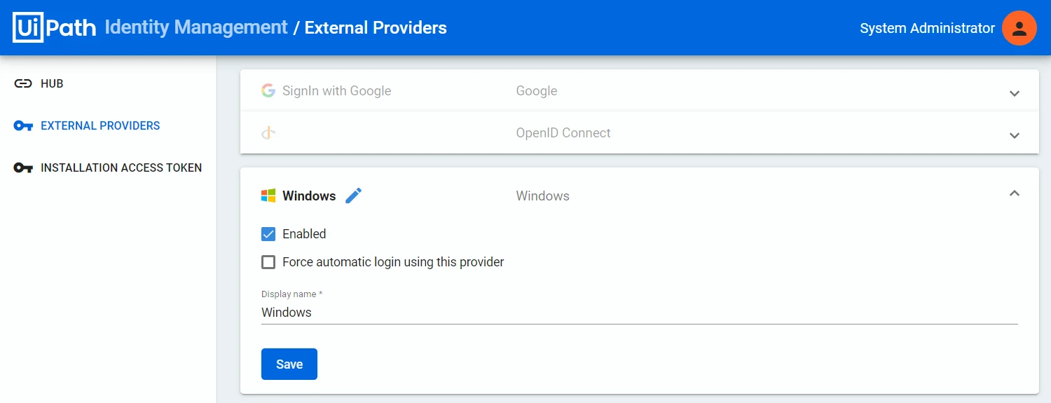

Ventanas
Esta sección te permite establecer los parámetros que permiten que Orchestrator/Identity Server utilicen la autenticación de Windows.
Follow the instructions on this page to enable Windows authentication.

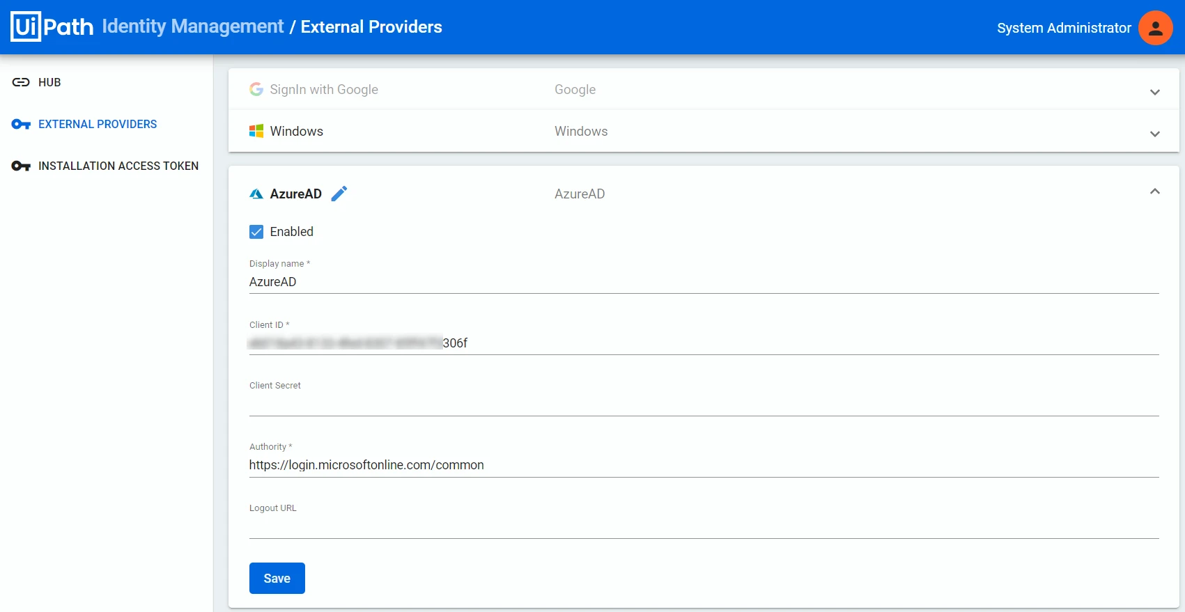

Azure AD
Esta sección te permite establecer los parámetros que permiten que Orchestrator/Identity Server utilicen la autenticación de Azure AD.
Before performing any settings in this page, make sure that you've configured Azure AD to recognize your Orchestrator instance.
Follow the steps here to instruct Identity Server to use Azure AD authentication.

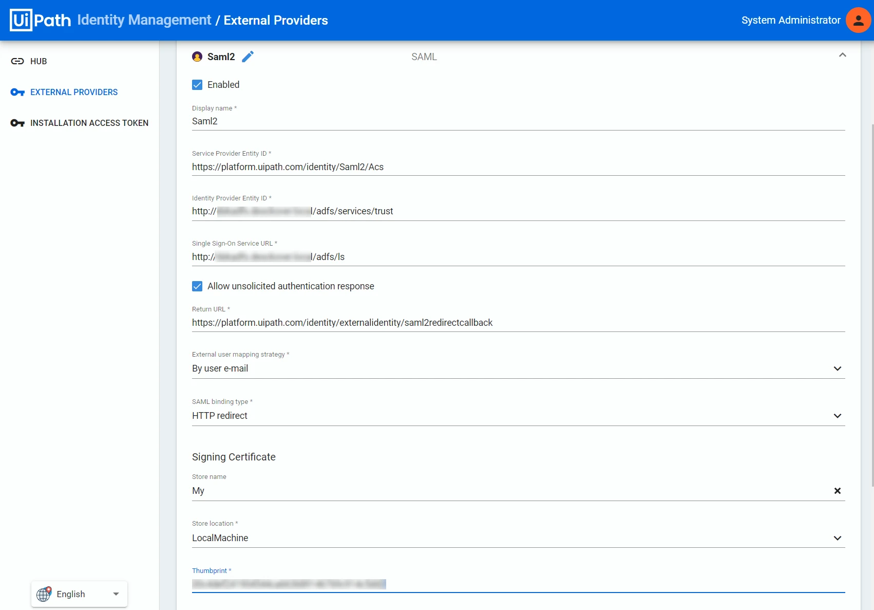

Autenticación de ADFS mediante SAML 2.0
Before performing any settings in this page, make sure that you've configured ADFS to recognize your Orchestrator instance.
Follow the steps here to instruct Identity Server to use ADFS authentication.

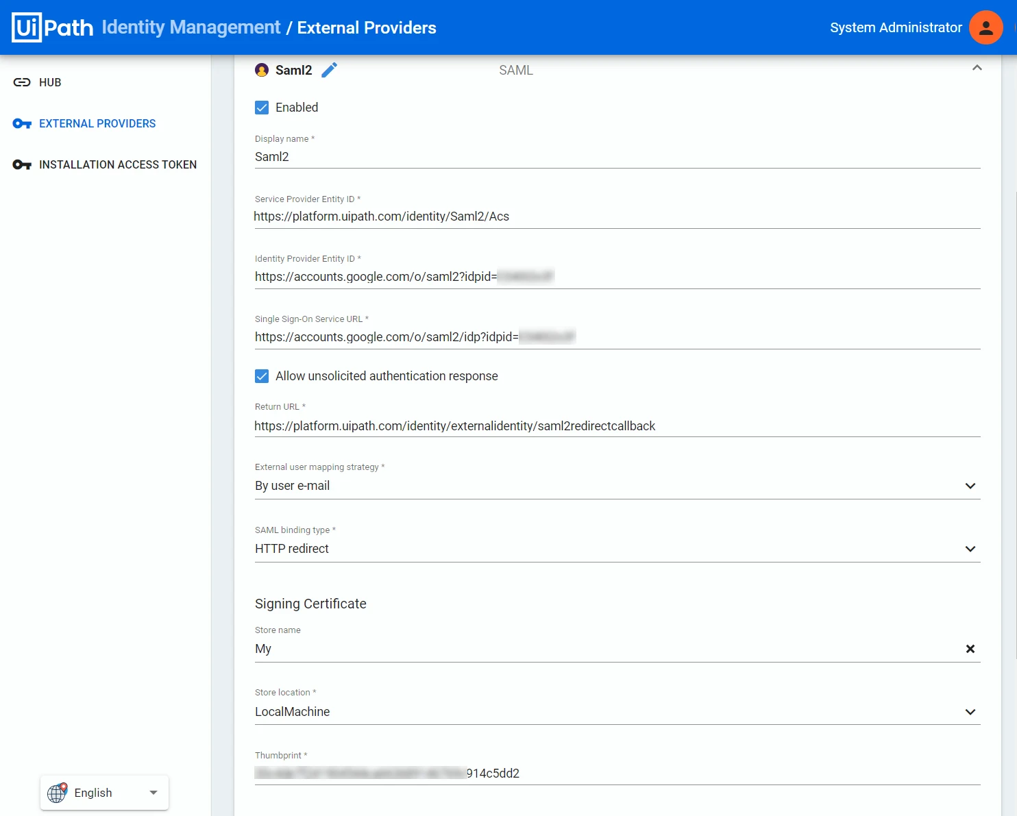

Autenticación de Google mediante SAML 2.0
Before performing any settings on this page, make sure that you've configured Google to recognize your Orchestrator instance.
Follow the steps here to instruct Identity Server to use Google SAML 2.0 authentication.

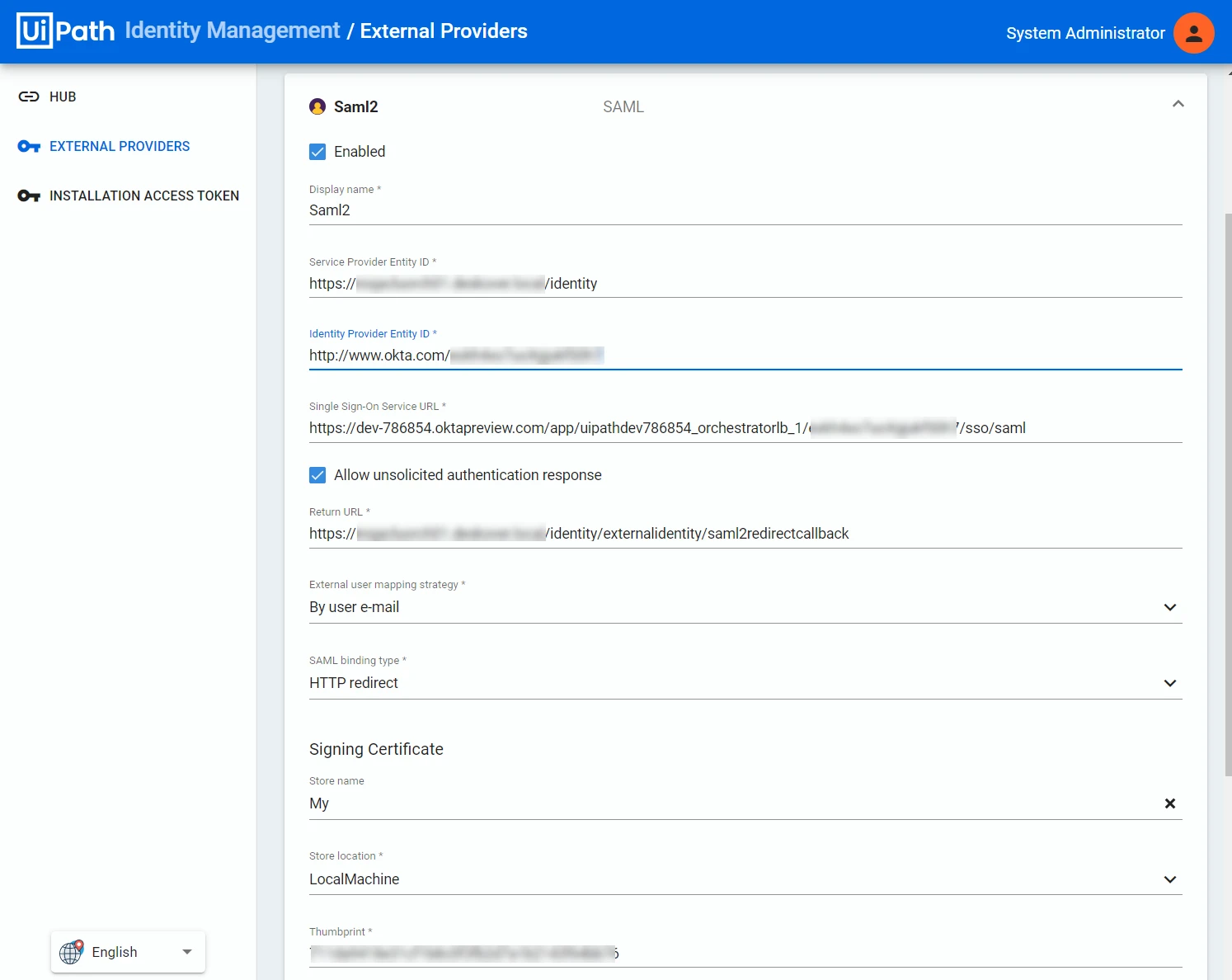

Autenticación de OKTA mediante SAML 2.0
Before performing any settings on this page, make sure that you've configured OKTA to recognize your Orchestrator instance.
Follow the steps here to instruct Identity Server to use OKTA authentication.
