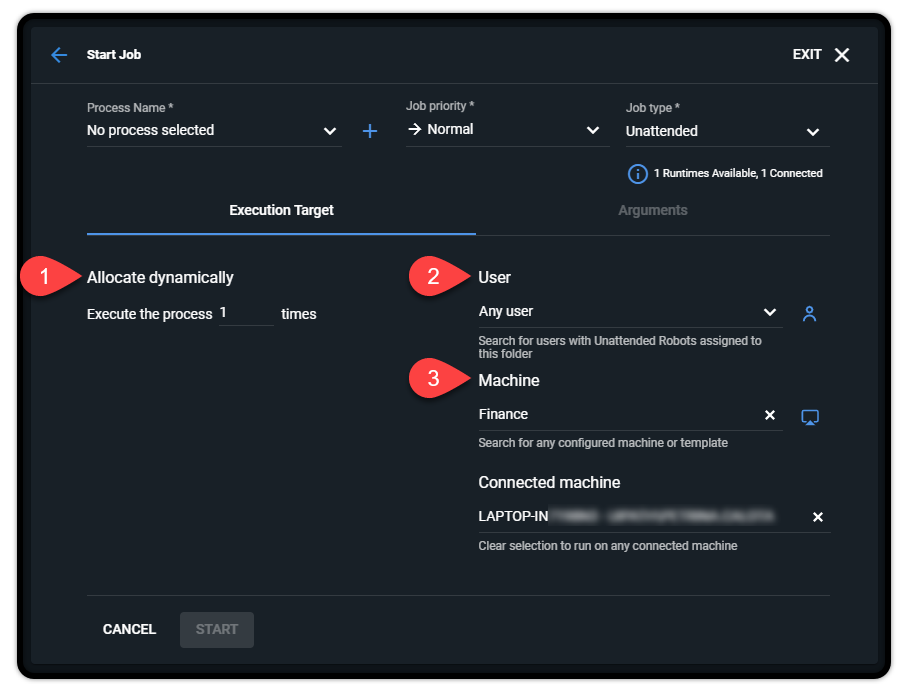

Configure your execution target by setting the options below as desired on the Execution Target tab.
Figure 1. Starting a job
Allocate Dynamically
Dynamic allocation with no explicit account and machine selection allows you to execute a foreground process multiple times under the account and machine that become available first. Background processes get executed on any account, regardless if it's busy or not, as long as you have sufficient runtimes.
Using this option you can execute a process up to 10000 times in one job.
Account
You can choose one of these approaches:
- Specifying an account means the process is executed under that specific user or robot account.
- Specifying both the account and the machine means the job launches on that very account-machine pair. Only valid account-machine pairs are available for selection.
- Specifying no account results in Orchestrator allocating the account dynamically.
Machine
- Specifying a machine object means the process is executed on one of the host machines attached to the selected machine template. Select a specific host machine from the pool of connected host machines on the Connected Machines field.
- Specifying no machine results in Orchestrator allocating the host machine dynamically.
