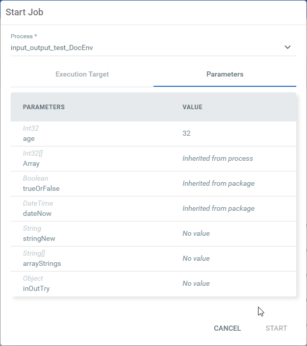

Displaying Argument Values
The value of an input argument is marked as follows:
- No value - No value was provided for the argument at process, job, schedule, or package level (in Studio).
- Inherited from package - If the value was provided by default in Studio. This message is displayed in the Arguments window of a specific package, as well as the View Process,Start Job, and Add Schedule windows.
- Inherited from process - If the value was provided at process level (in the View Process window). This message is displayed in the Start Job and Add Schedule window. In the View Process window, the value itself is displayed.
Figure 1. Argument values
