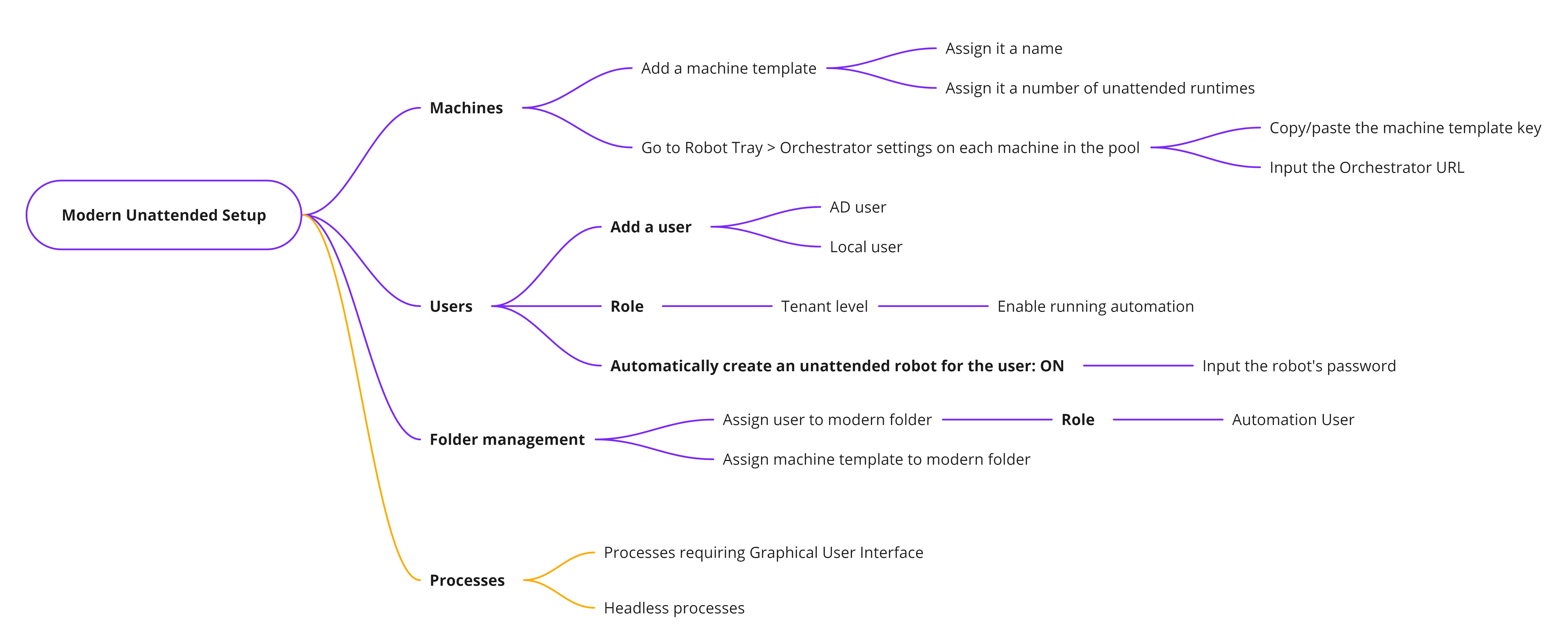

Unattended Setup
- On Tenant > Machines, create a machine template.
- Assign the necessary runtimes to the template. A template with X number of runtimes sets aside X licenses from the tenant's pool of licenses for each workstation connected to Orchestrator using that template. This allows you to execute X processes concurrently on each such workstation. Say you assigned 2 unattended and 3 nonproduction runtimes to a machine template. Three workstations connected to Orchestrator using that machine template withhold 6 ( 2 unattended X 3 workstations) unattended and 9 (3 nonproduction x 3 workstations) nonproduction licenses from the tenant's pool of licenses. This enables you to execute a number of 2 unattended, respectively 3 nonproduction processes, concurrently on each such workstation.
- Select the process type and process compatibility on the Supported Usage section. This allows you to optimize your unattended infrastructure by restricting unattended machines to executing certain types of processes. For example, you can configure cheaper machines such as Linux to execute cross-platform processes, and specialize Windows machines in foreground automation (which cannot run elsewhere). See an example of optimizing an unattended infrastructure consisting of a Windows desktop, one high-density Windows Server, and three Linux machines.
- Connect your machines to Orchestrator using the key generated by a machine template.
- Configure the account: set its role at the tenant level, enable automatic robot creation, set the username and password used to log on to the machine such that the Robot can authenticate, select the credential store, and configure the execution settings of the Robot.
Where from: Tenant > Manage access > Assign roles
- Assign the account and machine template to one or multiple folders while choosing the account roles at the folder level.
Important:
This gives access to that folder and makes the processes deployed there available and ready to get executed.
Where from: Tenant > Folders

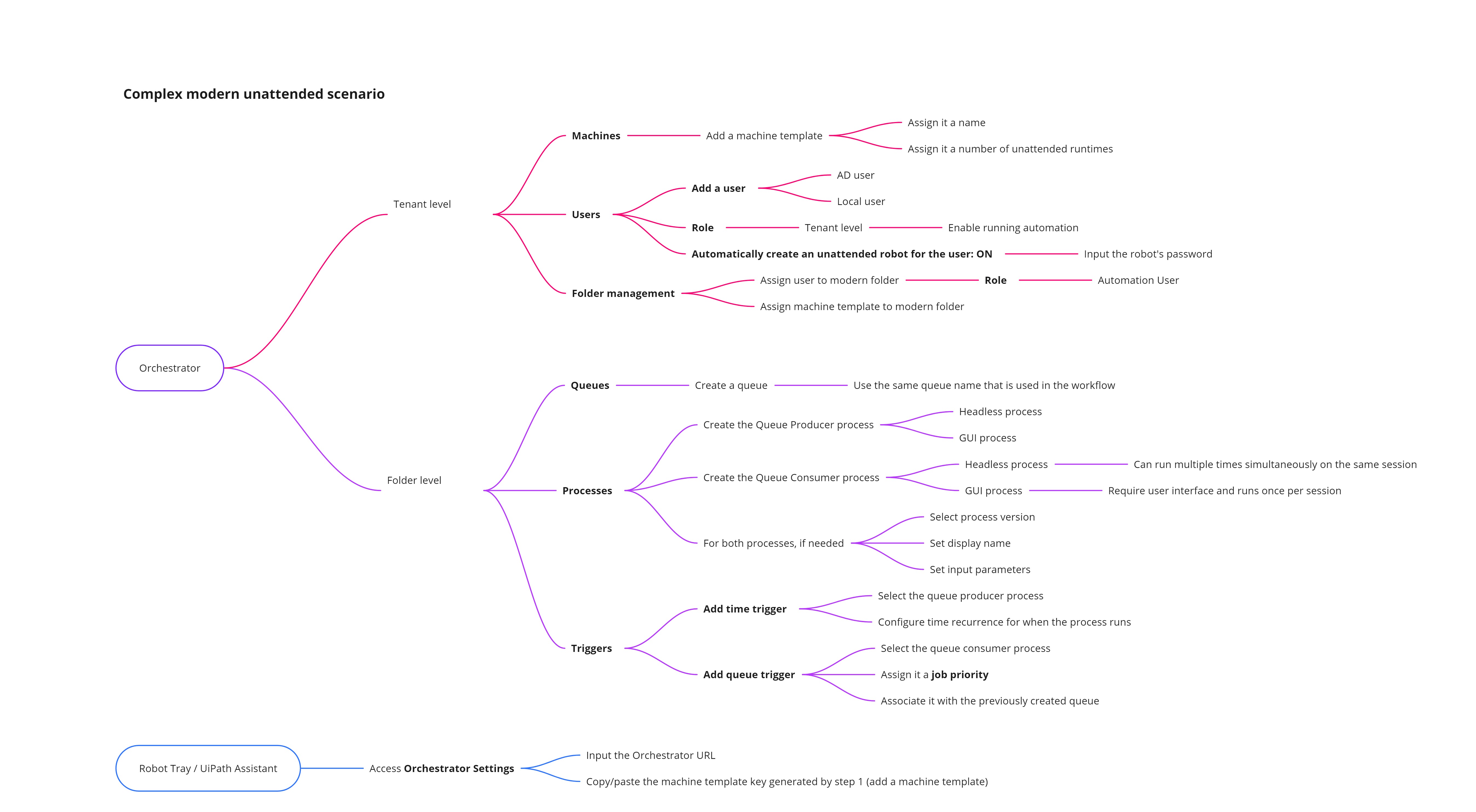

- Start a job, configuring its priority and runtime type. You can specify the account under which it gets executed, or you can leave it undefined.
Important:
Unattended jobs are dynamically executed by automatically pairing the accounts and machines in your environment. If the account is specified, only the machine is dynamically allocated. If no account is specified, both are dynamically paired to each other. The latter is the optimal job execution mechanism, as it optimizes resource consumption.
Where from: Folder context > Automations > Jobs or the UiPath Assistant (for unattended robots used in attended mode)
In unattended mode, the UiPath Assistant shows the processes across all folders to which both the account and machine template have been assigned. These processes can be started or triggered in unattended mode from Orchestrator.
A user using an unattended robot in attended mode (the user logs on to the machine) does not have access to the processes in folders to which the user alone is assigned. Their access is restricted to processes found in folders to which both themselves and the machine template are assigned.
On a host machine you need to provision a Windows user for each account that belongs to the folders to which the corresponding machine template is assigned to. Say you connected a server to Orchestrator using the key generated by machine template, FinanceT. That machine template is assigned to folders FinanceExecution and FinanceHR, where 6 accounts are assigned as well. Those 6 accounts need to be provisioned as Windows users on the server.
Figure 1. Graphical Representation of a Basic Unattended Setup
Figure 2. Graphical Representation of a Complex Unattended Setup

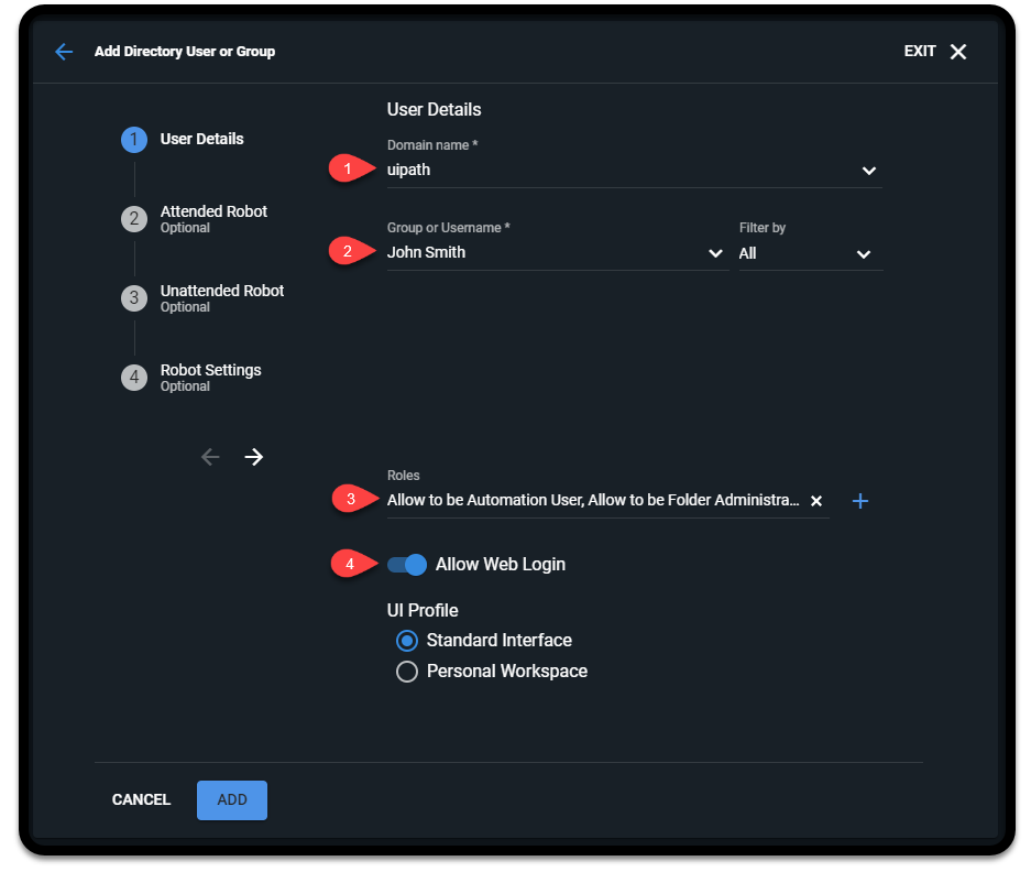

- Add user and configure user details.
Go to Tenant, select Manage access, and then select Assign roles.
- The developer must be granted the roles appropriate to the desired level of access to Orchestrator tenant resources. See standard Orchestrator roles and their purpose. (3)
- Allow web login to allow the developer to access Orchestrator. (4)
Figure 4. Adding a user and configuring user details

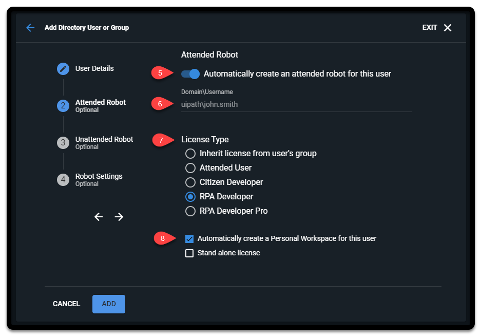

- Create and configure the attended robot.
- For directory users the Domain\Username is prefilled. (6)
- To build workflows and start jobs from the UiPath Assistant, you need a user license that offers Studio capabilities and enables you to provision the Robot for that specific user in Orchestrator. See the UiPath Licensing Portal for details about available SKUs. (7)
- Create a personal workspace for the user to facilitate workflow debugging in the context of the workspace. (8)
Figure 5. Creating and configuring the attended robot

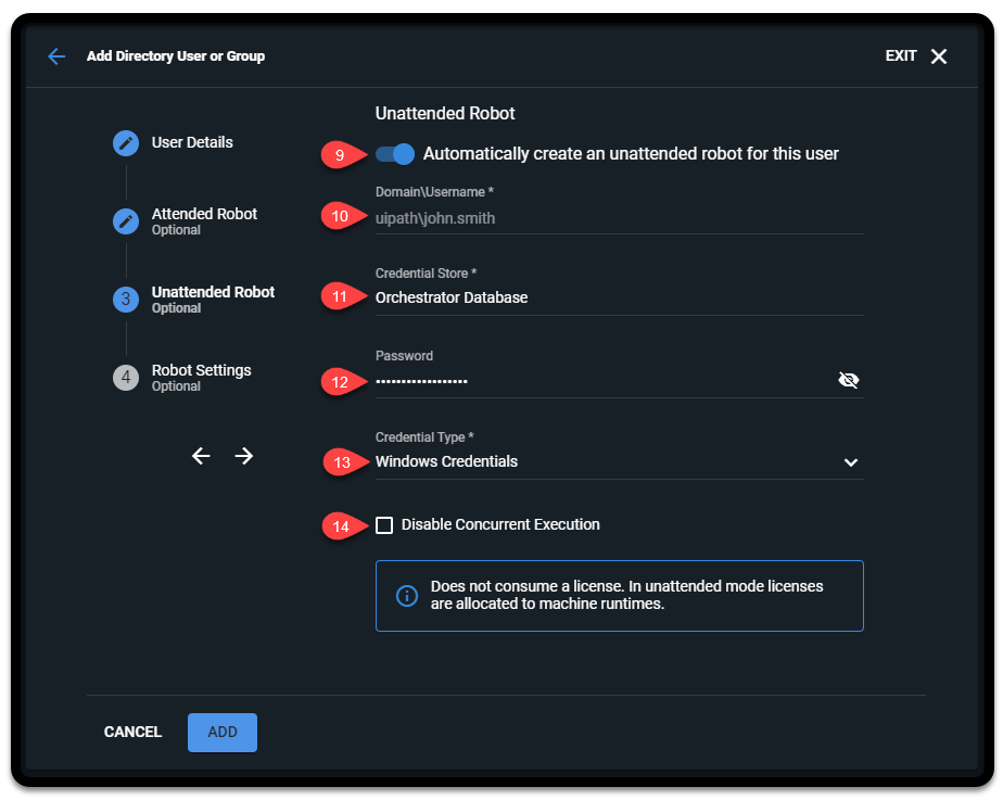

- Create and configure the unattended robot.
- For directory users the Domain\Username is prefilled. (10)
- See details about credentials and credential stores. (11, 12, 13)
- When and why to disable concurrent execution. (14)
Figure 6. Creating and configuring the unattended robot

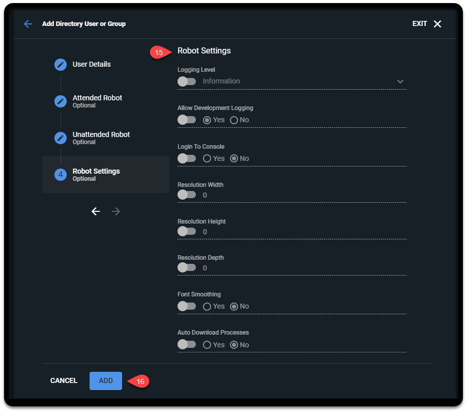

- Configure robot settings
Figure 7. Configuring robot settings
