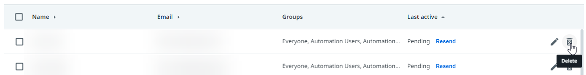

To remove inactive user accounts:
Log in to Orchestrator as an administrator.
Go to Admin > Accounts & Groups > Users tab.
Click the column header for the Last active column to reorder users so that the ones with the oldest date for last login are shown at the top:
The Last active column show the date when the user last logged in to Orchestrator. If you see Pending in this column, as in the above example, that means the user never logged in. You can use this information to help you identify your inactive users.
Click the Delete icon at the end of the row to remove the local account for that user.
In the confirmation dialog, click Delete to confirm deleting the account from Orchestrator.
The user account is removed from the page.

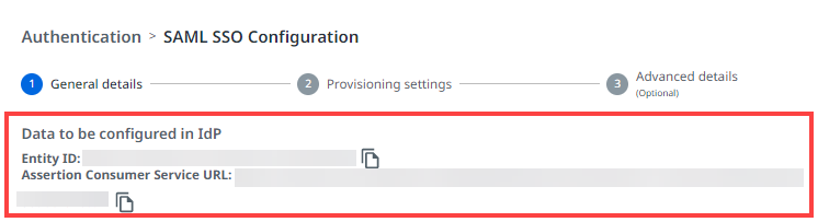

In the General details step, under Data to be configured in IdP, we provide the information you need to to configure your identity provider to connect to Orchestrator.
- Copy and save the values for Entity ID and Assertion Consumer Service URL values. You will need these in the next step.

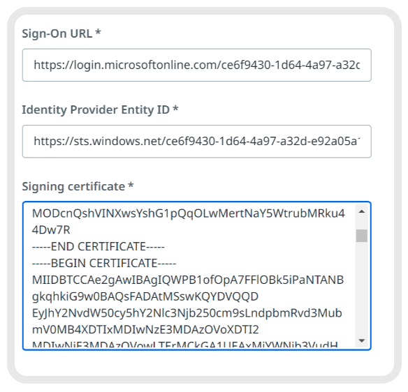

- In the General details step, under Data from IdP, fill in the Metadata URL field with the metadata URL obtained during the configuration of the identity provider.
- Click Fetch data.
When complete, the Sign-on URL, Identity Provider Entity ID, and Signing certificate fields are populated with the IdP information.
- To manually enter multiple certificates, paste them into the Signing certificate field, separated by a new line character.

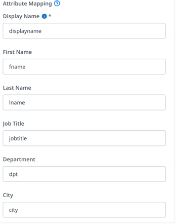

- In the Attribute Mapping section, map the First and Last name attributes to the Display name. Additionally, you may configure other optional mappings as needed for your integration.

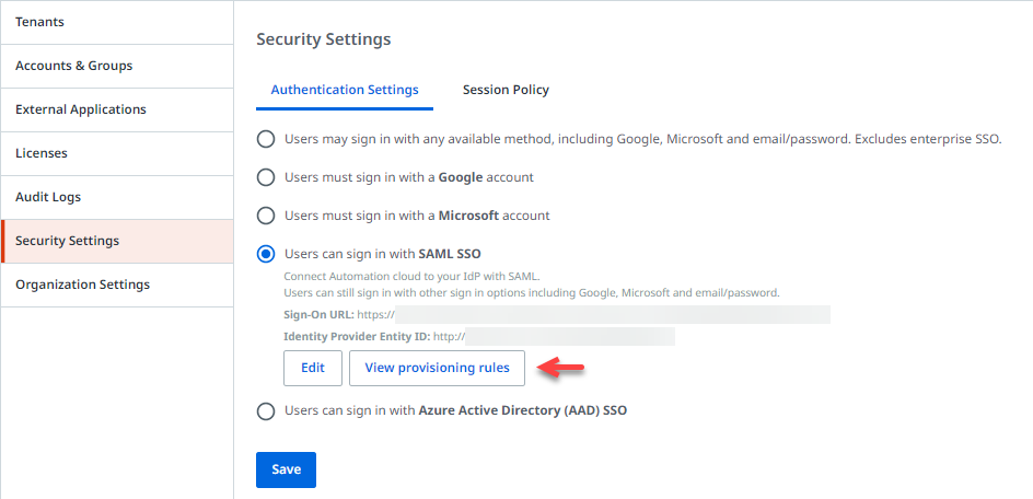

Go to Admin > Security Settings > Authentication Settings.
Under the SAML SSO option, click View Provisioning Rules:
The SAML SSO Provisioning Rules page opens, where your existing rules are listed.

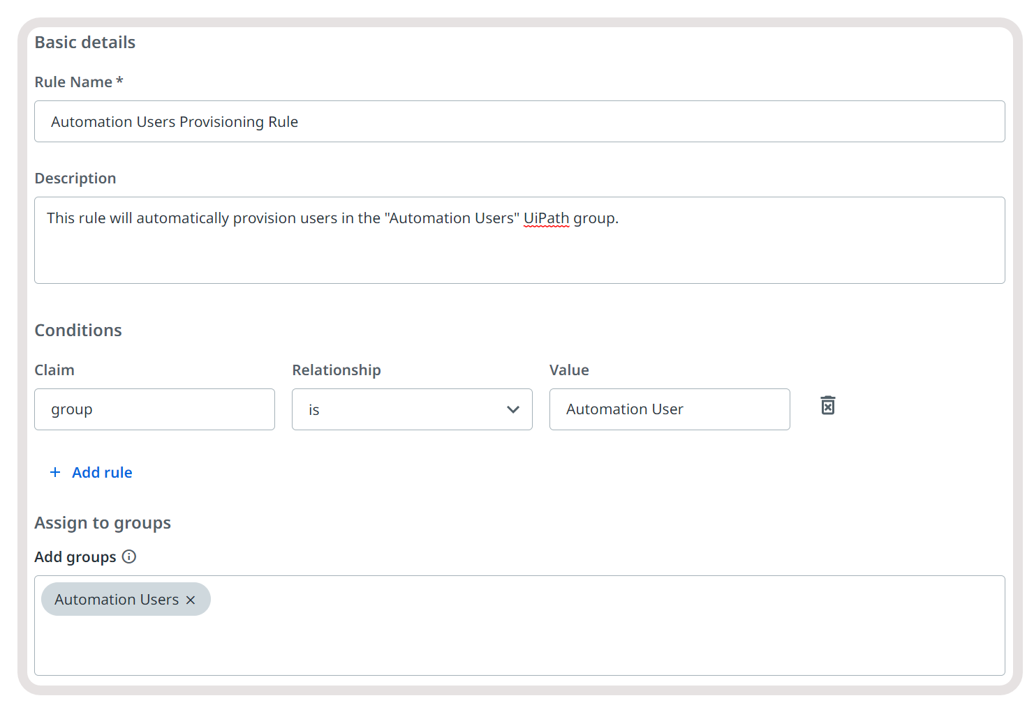

In the top right corner of the page, click Add rule. The Add new rule page opens.
Under Basic details, fill in the Rule Name field and optionally fill in the Description field.

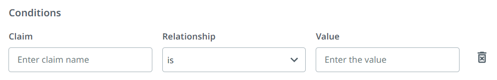

Under Conditions, click Add rule. A row of fields for a new condition is added. Together, they define the criteria that an account must meet at sign in to be added to a group (chosen later).
In the Claim field, type the name of the claim, as it appears in the IdP.
From the Relationship list, select how the claim relates to the value. The following options are available:
Relationship Condition requirement Example is exact match, case sensitive Department is RPArequires that the value for theDepartmentclaim beRPA. The condition is not met if the value isRPADev, for example. This relationship works for multi-valued claims. For example, ifadministratoranddevelopervalues are sent under theGroupclaim, thenGroup is administratorwould be a valid relationship.is not anything except specified value, case sensitive For Department is not ctr, any account is added to the group unlessDepartmenthas the valuectr. The condition is met if the department isCtrorelectr.contains includes, does not require an exact match, case sensitive Department contains RPArequires that the value for theDepartmentclaim includeRPA. The condition is met if the value isRPADev,xRPAx, orNewRPA, for example.not contains excludes, does not require an exact match, case sensitive For Department not contains ctr, any account is added to the group unless theDepartmentvalue includesctr. Accounts for which the department isctrorelectr, for example, are not added to the group.is case insensitive exact match, not case sensitive Department is case insensitive RPArequires that the value for theDepartmentclaim berpa, in any capitalization. The condition is met if the value isrpa, for example. The condition is not met if the value iscrpa.contains case insensitive includes, does not require an exact match, not case sensitive Department contains case insensitive RPArequires that the value for theDepartmentclaim includeRPA, in any capitalization. The condition is met if the value isrpa,cRPA, orrpA, for example. -
In the Value field, type the value that is needed to meet the condition.
If you want to add another condition, click Add rule to add a new condition row.
When you add multiple conditions, all conditions must be met for the provisioning rule to apply. For example, if you define the rules Department is RPA and Title is Engineer, only users that are both in the RPA department and have the title Engineer are added to the specified groups. An account for which the department is RPA, but the title is QA is not added to the groups.
- Under Assign to groups, in the Add Groups box, start typing the name of a group and then select a group from the list of results. Repeat to add more groups, if needed. When the conditions are met, accounts are automatically added to these groups when they login.
- Click Save in the bottom right corner to add the rule.
With a rule in place, whenever a user logs in and their account meets the conditions specified for a rule, their account is added to the provisioning groups attached to the rule, and their account is set up to work.
SAML attribute mapping
When configuring the SAML directory integration, organization administrators can define which attributes from their IdP should be mapped to the system user attributes. Afterwards, when a user logs in via the SAML directory integration, the system reads the claims that are passed into the ACS payload and map the value to their correspondent system attributes.
- Your IdP must be configured to pass in these claims in the ACS payload.
- Ensure the attribute names configured in the IdP match the attribute mapping settings in the organization administrator portal.
For example, if this is the user structure in your IdP, an organization administrator can set up the following attribute mapping settings to have this information populated in the system user object.
"displayname": "John Doe",
"fname": "John",
"lname": "Doe",
"jobtitle": "Hardware Engineer",
"dpt": "Engineering",
"city": "Phoenix"
"fname": "John",
"lname": "Doe",
"city": "Phoenix"
When a user in this organization logs in via the SAML directory integration, their user object is updated to reflect this setting.
"Display Name": "John Doe",
"First Name": "John",
"Last Name": "Doe",
"Job Title": "Hardware Engineer",
"Department": "Engineering",
"City": "Phoenix"
"Last Name": "Doe",
"City": "Phoenix"
