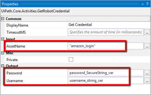

Using the Get Credential Activity
- In Orchestrator, create a Credential asset.
- In Studio, create a String variable. This is used to store the username part of the credentials.
- Create a SecureString variable. This is used to store the password. The SecureString is a special .NET Framework variable type that is encrypted within the framework.
- In the Properties panel, in the AssetName field, type the name of the credential asset, as it is in Orchestrator, and place it between quotation marks. For example,
"amazon_login". - In the Properties panel, in the Password field, enter the SecureString variable.
- In the Properties panel, in the Username field, enter the string variable. The credential asset stored in Orchestrator can be used by the Robot too, as long as the AssetName coincides with the asset name that is stored in the Orchestrator database, and the Robot has the required permissions.
