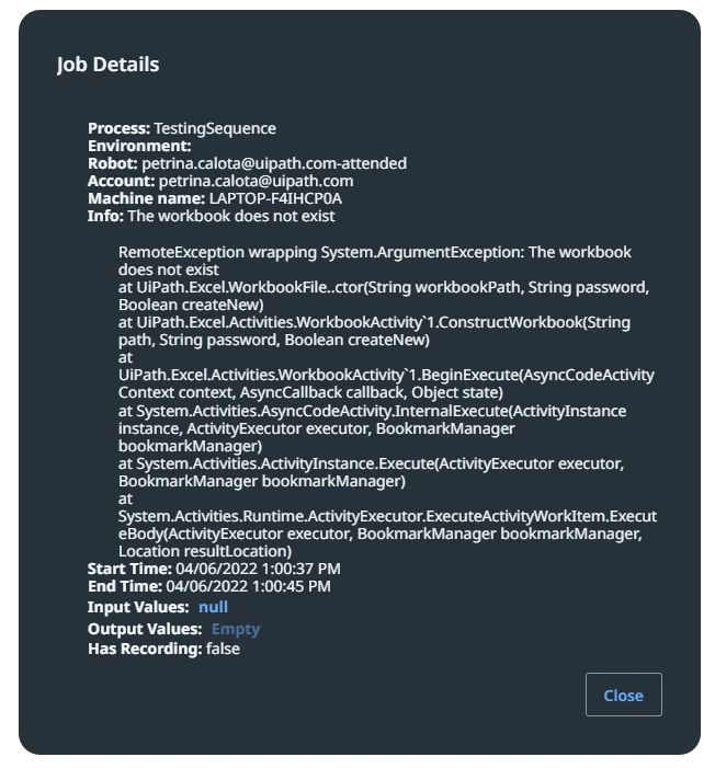

Viewing Job Details​
To view details about a specific job, follow these steps:
  1. Click the corresponding View Details button. The Job Details window is displayed. Here you can find various information such as the name of the underlying process, the executing robot and machine, the reason behind jobs failing, etc.
    Note:
    The Info field does not display licensing considerations for jobs failing. Use the monitoring functionality for details on licensing.
